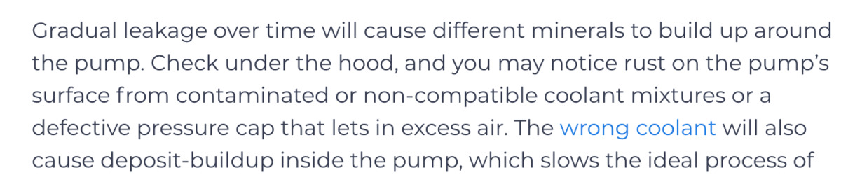

side note- the other day i found i havent been using the right coolant (i thought coolant was universal) (ive been using peak 50/50). i heard this can cause corrosion/air leaks in your water pump. Also the jeep is a manual, idk if that makes a difference.
