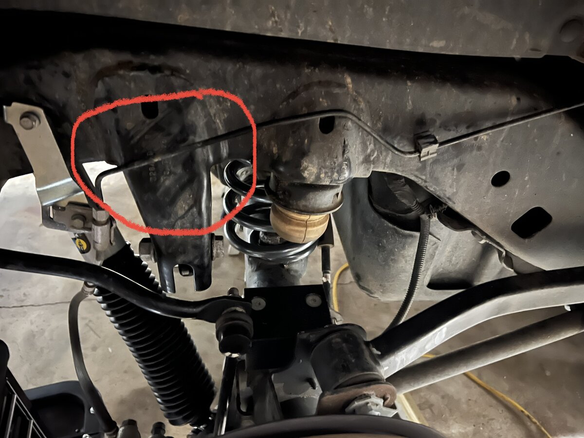

I’ve got 26K on it. The relocation brackets seem different then the ones used in the couple of videos I bought and seem pretty decent. Except having a issue with the right rear due to mounting bracket for the track bar.
The relocation brackets worked ok for me.

@Vman did you have an issue with the right rear relocation bracket? I can get it to fit but due to where the track mount it the brake line seems to be hitting that bracket as it bumps out from the frame. Other side was perfect.
Hm I don't remember having any issues. If I don't get too large a honey-do list tomorrow I'll take a look.

I did mine on jack stands under the axels. Can you send a picture of the relocation bracket issue?

Thanks guys. Here is the relocation bracket on the right rear. The area in red is where the lone hits. I thought about bending the bracket out some, but then I think it may hit the sway bar.

Seeing it now reminds me why I didn't like them. I just thought moving the lines away from the frame made them susceptible to getting damaged easily. I don't think I even got to that side before I decided not to use them.
