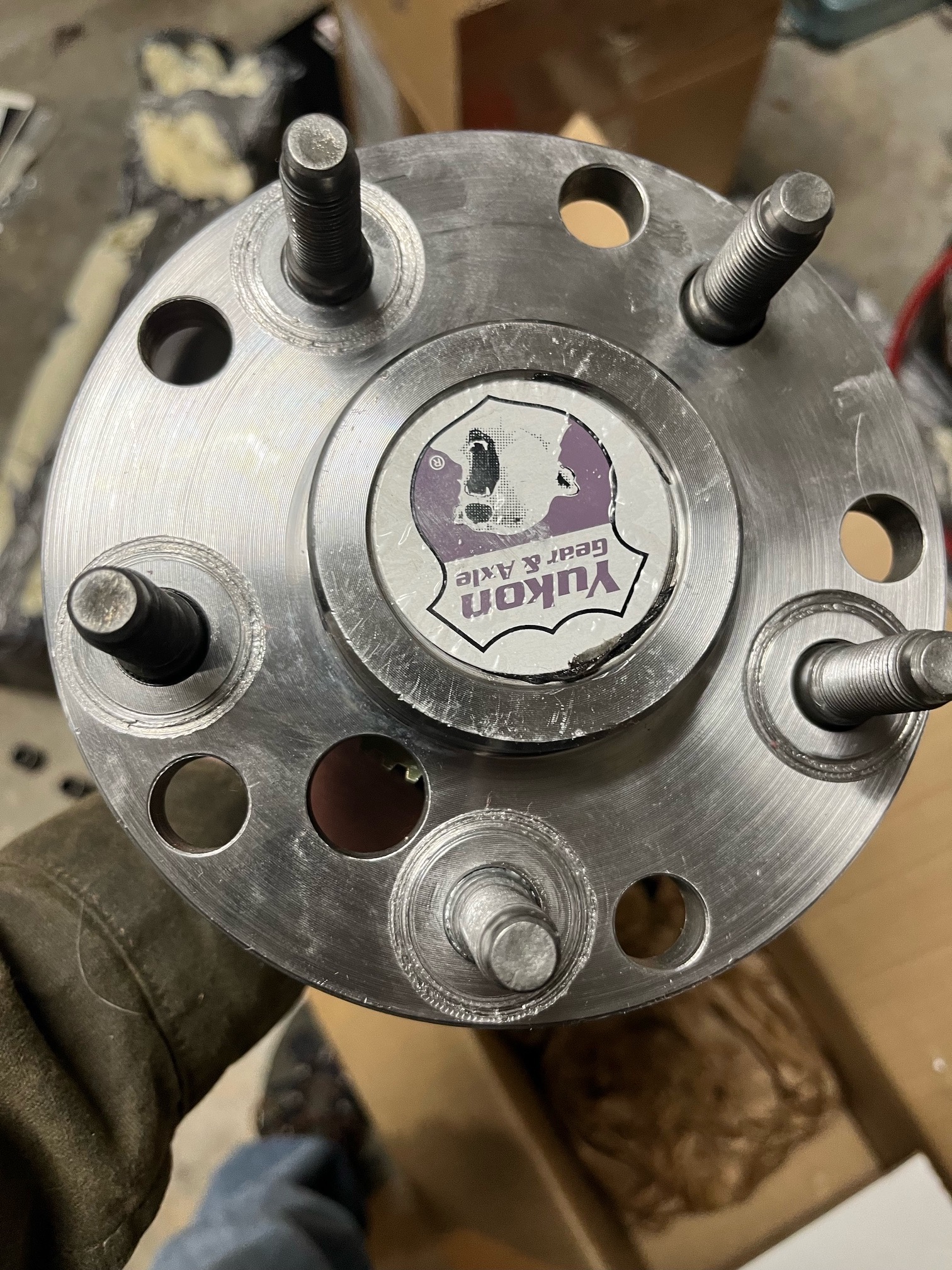

Had a local shop install the wheel studs on my new Yukon rear axle shafts. Apparently they didn't use a washer when pulling them through and left gouged rings around the stud area (see attached pic). I ran a file over the gouged area to remove any burrs but how concerned should I be with this? Should I go back and raise hell? The other shaft looks good (apparently they got wise to the damage)

Should be ok as long as the burred area is smooth with the face of the flange.

Yeah, thanks BLAKJKU. I took care of that with a really small, fine file. Guess I'll just check the run-out with the rotor on once I get them installed. Crappy work for sure. Appreciate the response.
PS - That one stud without the gouge...that's the one I did myself before decided to have a "professional" do it thinking they would have a way to pull/press the studs through without stressing them. Can't tell you how insane this made me...
