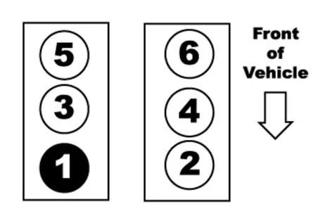

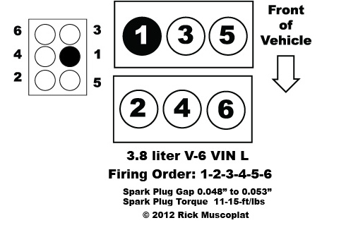

Bank1 refers to cylinder 1, bank2 refers to cylinder 2 (firing order). I do not know if the 3.6 is the same as my 3.8. Anyhow on mine passenger side is 1 and driver side is 2. Sensor 1s are ahead of the cat, sensor 2s are aft.
Nope engine is the wrong way...Maybe this is it. This is a 3.6L Jeep and Cherokee, so the web page said...

This is definitely what I was looking for...! Thanks...Now I know...So my error message was "02 Sensor 2/2 Circuit Low Engine Code P0157" So my guess is the 2/2 designates bank 2 sensor 2 which is the downstream one...
Right, downstream just tells the ECM that the Cat is doing it's job along with the No1 sensor. That's why we said it wouldn't hurt that much to drive it. If it was the no1 sensor no you shouldn't drive it because that one controls the A/F ratio.

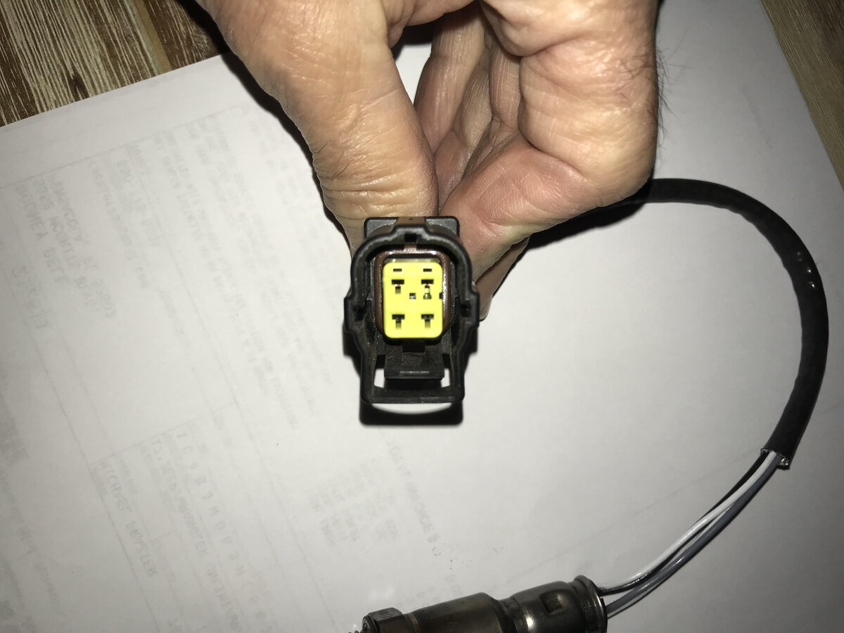

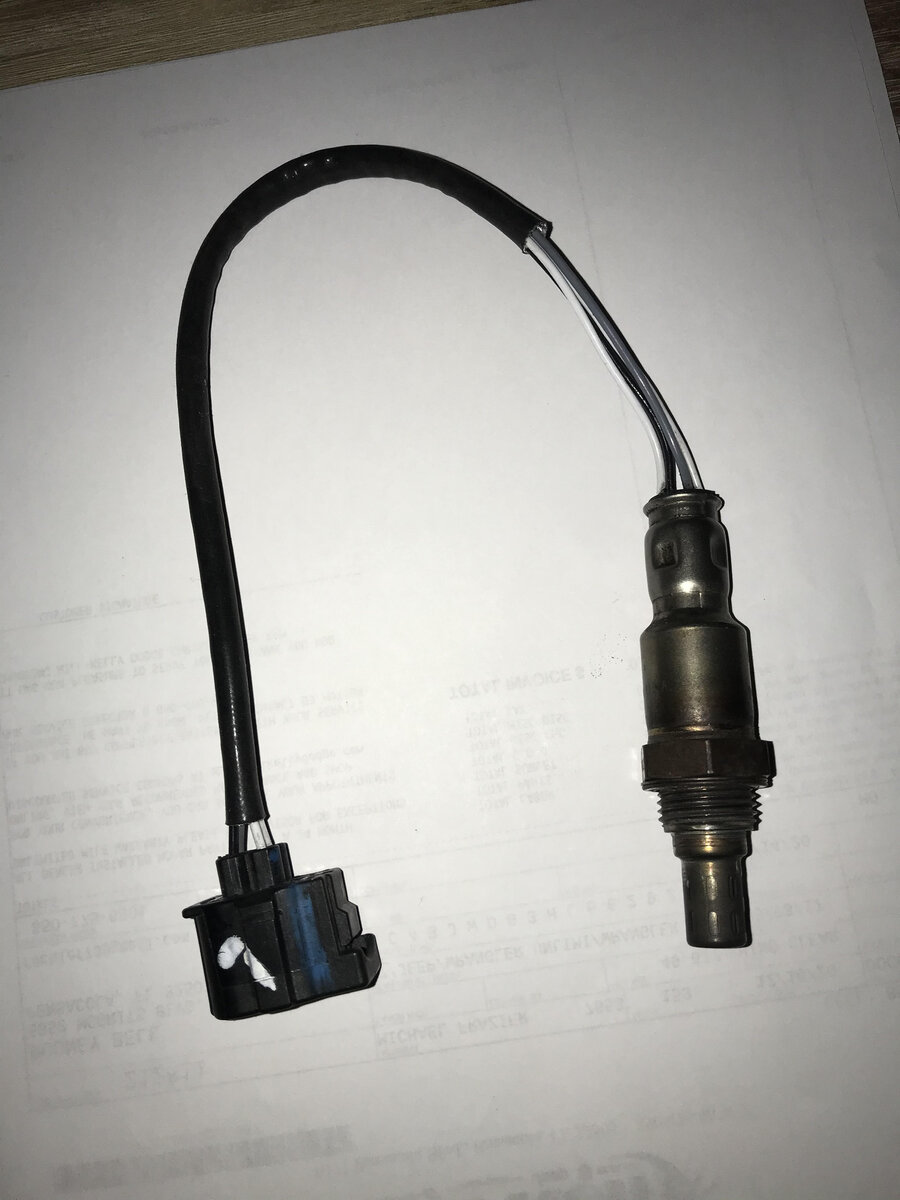

Well, it ended up being the drivers side downstream it's called, which they replaced this morning...I always like to save my old parts...Here tiz...! So i guess that is the P0157 location on the 2017 Jeep Wrangler Sport...
BTW, I ask the guy there what brand it was. It was indeed an NGK brand....He says that is what they stock. Thank you for all who offered input and helped me out. I appreciate it...!! Have one more issue I may post, the Oil Cooler.
