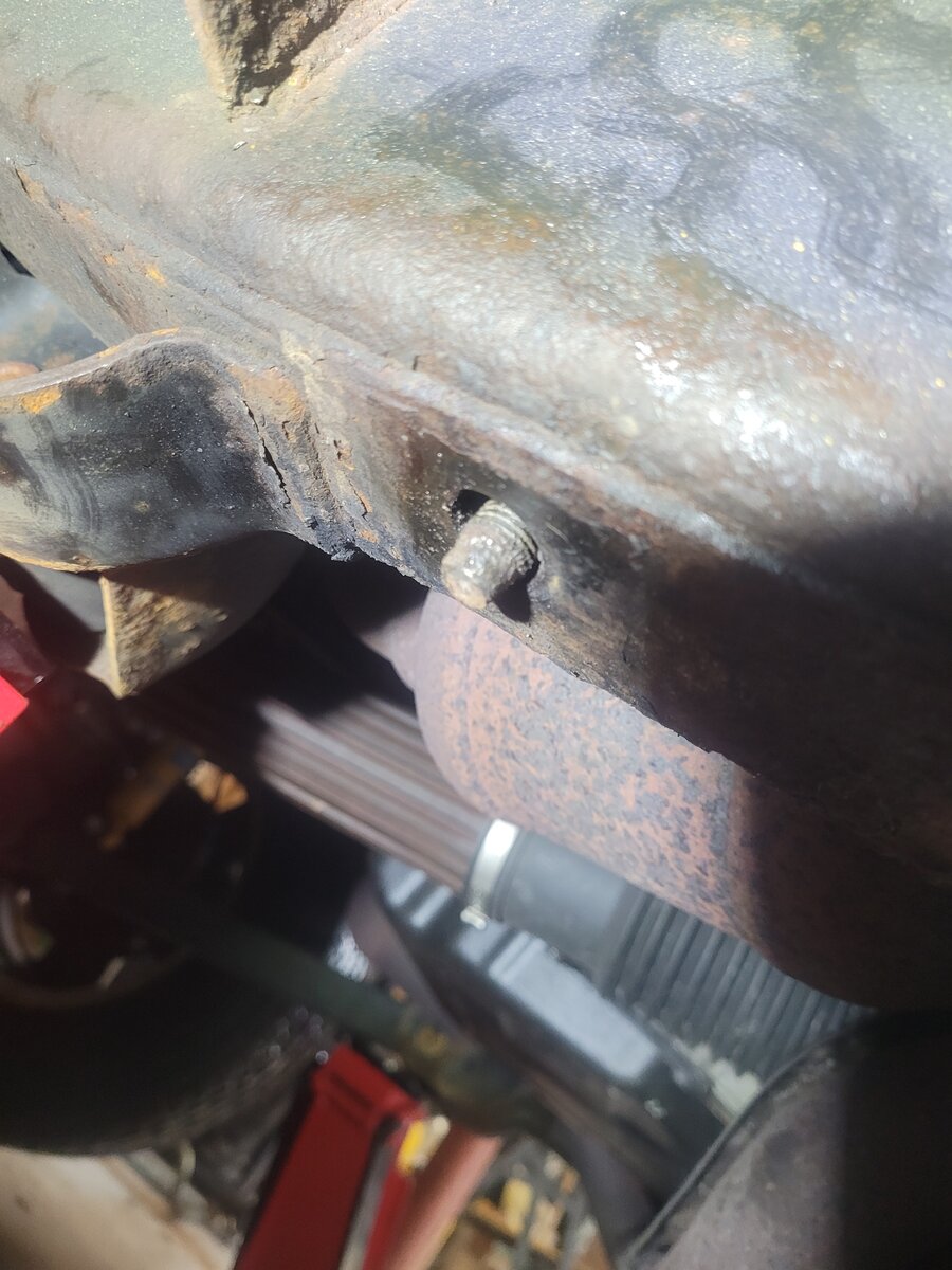

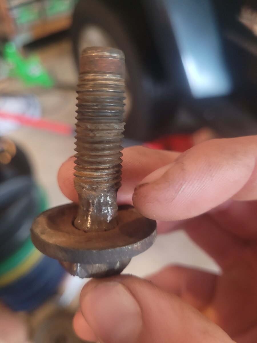

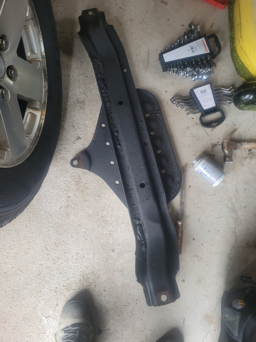

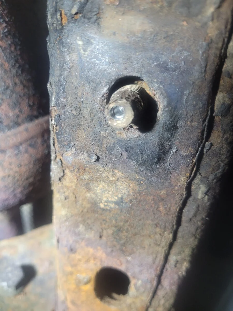

Hey yall. Began my transmission fluid work today and broke one of the bolts on the cross member. Attempting to get her out now. But where oh where do we all get these bolts?! They are not common clearly. Got the other two out fine albeit I used more heat and went in and out more and eased them out better. And another question would it be bad to drive without the cross member for line a day?

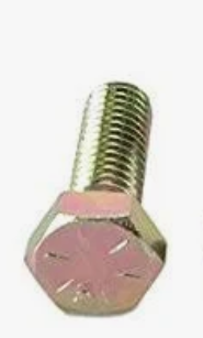

Grade 8? Whats that?

  1. Grade 2 – The grade 2 bolts are most commonly manufactured from low or medium carbon steel. Bolts of this grade do not have any radial lines. The bolts of this grade with a nominal size range from 1/4″ to 3/4″ have a minimum tensile strength of about 57000 psi and the yield strength of sizes from 3/4″ to 1/2″ 36000 psi.
  2. Grade 5 – Unlike grade 2 bolts, grade 5 bolts feature 5 radial lines. These bolts are manufactured from medium carbon steel. These bolts come in two different size ranges – 1/4″ to 1″ and 1″ to 1 1/2″, which have the proof load of 85000 psi and 74000 psi respectively.
  3. Grade 8 – Grade 8 bolts are made from medium carbon alloy steel. The bolts of this grade feature 6 radial lines. The nominal size of the grade 8 bolts can be from 1/4″ to 1 1/2″. The minimum yield strength of this grade bolt is 130,000 psi. A maximum of 120,000 psi of tensile force (proof load) can be applied to grade 8 bolts.
  4. Grade S – Grade S bolts have the capability to withstand 45 to 49.9 MT of stress per 6.45 cm3. Bolts of this grade are heavy duty bolts that are strong and highly durable, and thus are used in a variety of heavy duty applications.
The bolt will have 6 lines on the head:
Most Hardware Stores should have them, do you have a Fastenal Store close by?

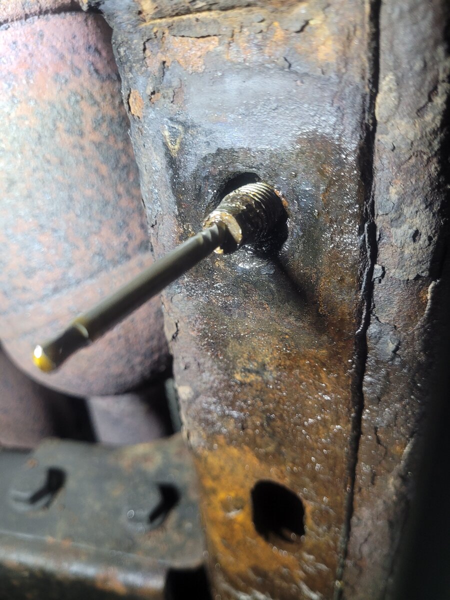

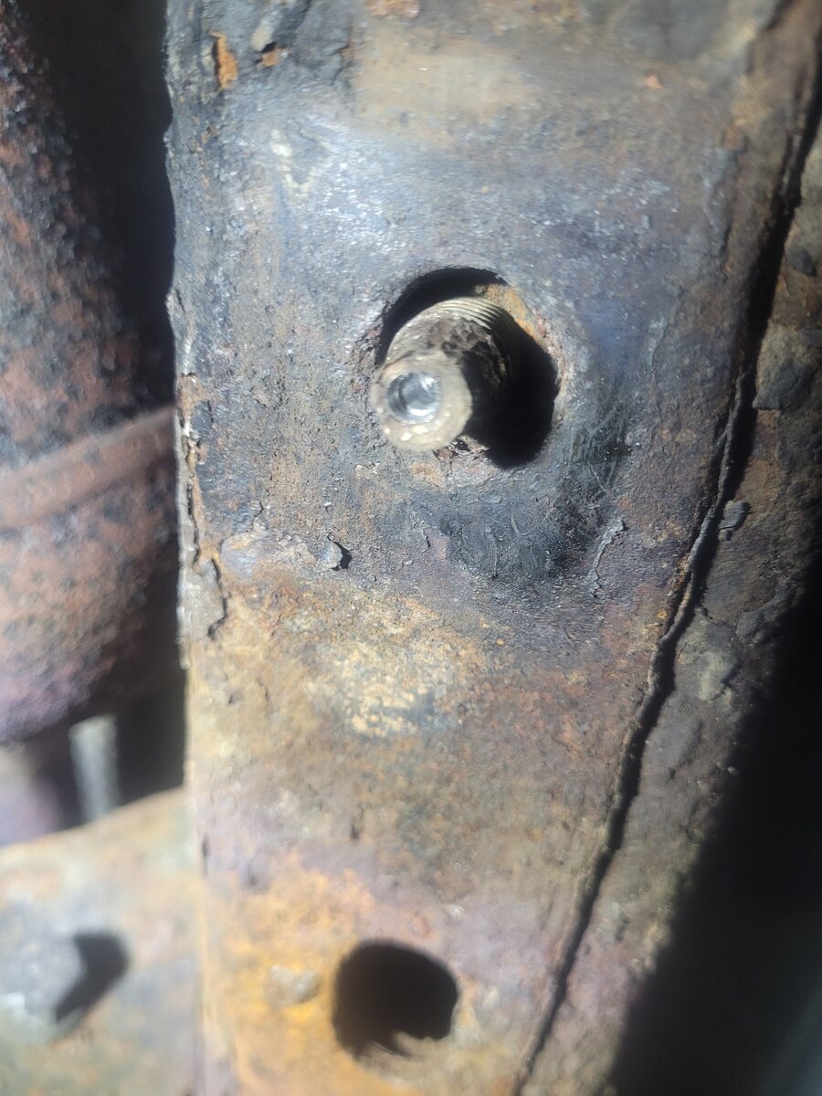

She still ain't budging. I'm really deep with my lefty bit and that easy out is good in there too. Gonna try to get her hotter. I see no other way. Do you guys ever try heating the nut more than the bolt? Or just heating the stud?
You're going to heat everything. You can also try cooling it really fast after you heat it up. The idea is that the heating and cooling causes the metal to expand and contract, breaking the rust loose.
Bladesmiths generally heat the quench before we dunk the blade. Because a cold quench can shatter a thick blade. Doing the same rapid hot/cold cycle with your bolt has a really good chance of breaking the rust weld.
I always heated the nuts whenever possible, most of the time you have to get it cherry red for the bolt to come out.
How would you suggest cooling it? Spray bottle? Hose? Spit? Haha
The largest temperature change in the shortest time will yield the best results. So in an ideal world, you'd get it cherry red and then dunk it in ice water. That's not terribly practical when you're crawling under a vehicle. A hose works, but it's a bit messy. I tend to use a bucket full of ice water and some old rags.
If you have room I’d consider a quality pair of vice grips really tight on the non-threaded portion. It might give a little more leverage to twist it, plus it won’t break off the easy out.
