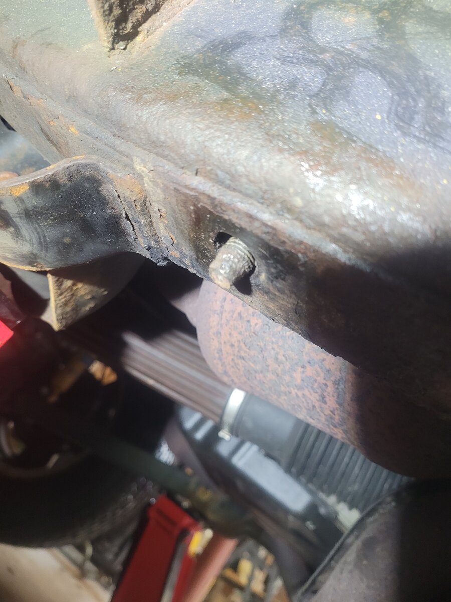

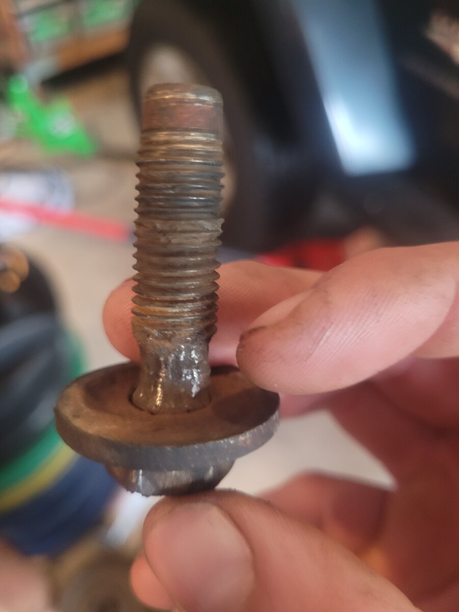

Jeeps are us has lotsa stuff. I bought my top rear shock bolts from them.Hey yall. Began my transmission fluid work today and broke one of the bolts on the cross member. Attempting to get her out now. But where oh where do we all get these bolts?! They are not common clearly. Got the other two out fine albeit I used more heat and went in and out more and eased them out better. And another question would it be bad to drive without the cross member for line a day?

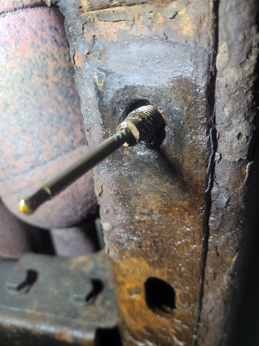

I've used a freeze out spray which shrinjs the bolt though money wasn't that rusty.She still ain't budging. I'm really deep with my lefty bit and that easy out is good in there too. Gonna try to get her hotter. I see no other way. Do you guys ever try heating the nut more than the bolt? Or just heating the stud?
SOMEONE MAY HAVE "" TORQUED""I've used a freeze out spray which shrinjs the bolt though money wasn't that rusty.
