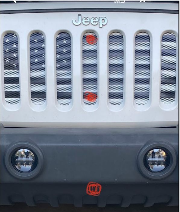

The title pretty much sums it up. I'm looking at mounting options for a forward camera that others have already proven to be effective or not worth the effort.
I have no interest in doing it multiple times, so I'm hoping others can chime in on what worked and what didn't.
These are the spots I'm considering.
I like the idea of putting it behind the grill insert, but mounting it there will be more involved.
If you have a forward camera setup that works well, can you please post a pic of your chosen mounting location and a shot of the view that it provides?
I realize that my camera may provide a different field of view, but I'm wanting some confidence about the location before I start hacking things up.
No need to install it in a location that is either too low or too high, etc.

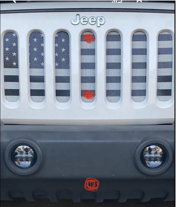

I haven't installed mine yet but have it planned out after doing a bunch research .
Installing in top position would be best . Bottom location will get soaked and lens dirty after
any large puddle or larger water obstacle .
My front bumper is always pretty dirty after a day of wheeling .
The middle location will be blocked by a winch . I'm assuming your eventually going to get a winch.
It really only leaves top location for a fromt cam.
My front cam will be for wheeling . As many times climbing out of massive washout or super steep obstacle I'm looking at the sky. No joke . So having camera pointed down a bit will help
see the trail when crawling out or into obstacle .
Going with GOPRO inside up on dash to record trails . You could use for traffic cam as well. Personallly don't see need for traffic cam . But to each their own . So basically 2 diff cams . One for recording and another for live action to clearly see trails when entering , exiting or going over obstacles .
