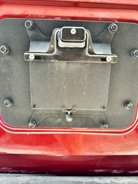

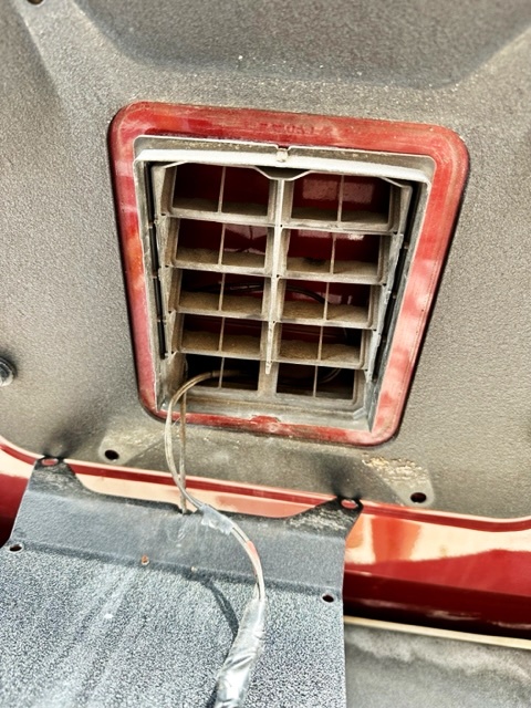

Relocating the license plate from where the previous owner had it on the tailgate to where it was originally. Taking off some brackets from where the plate was mounted and I found this....vent? ...or something. Anybody tell me what it's for?
OK, so I finally got around to googling this. Apparently it is a vent. To equalize air pressure when you’ve got the air conditioner on, etc. What confuses me is it's solid metal on the inside of the tailgate, so I don’t see how the air can actually get through the vent.
It looks like your vent is missing the flaps . The back of my Jeep would get dusty after a day on the trails . After replacing with new vent that had the flaps . Stopped the dust problem .
It’s kinda there for a reason as @BLACKJKU said literally have to slam the door to get it closed properly if vent removed .
