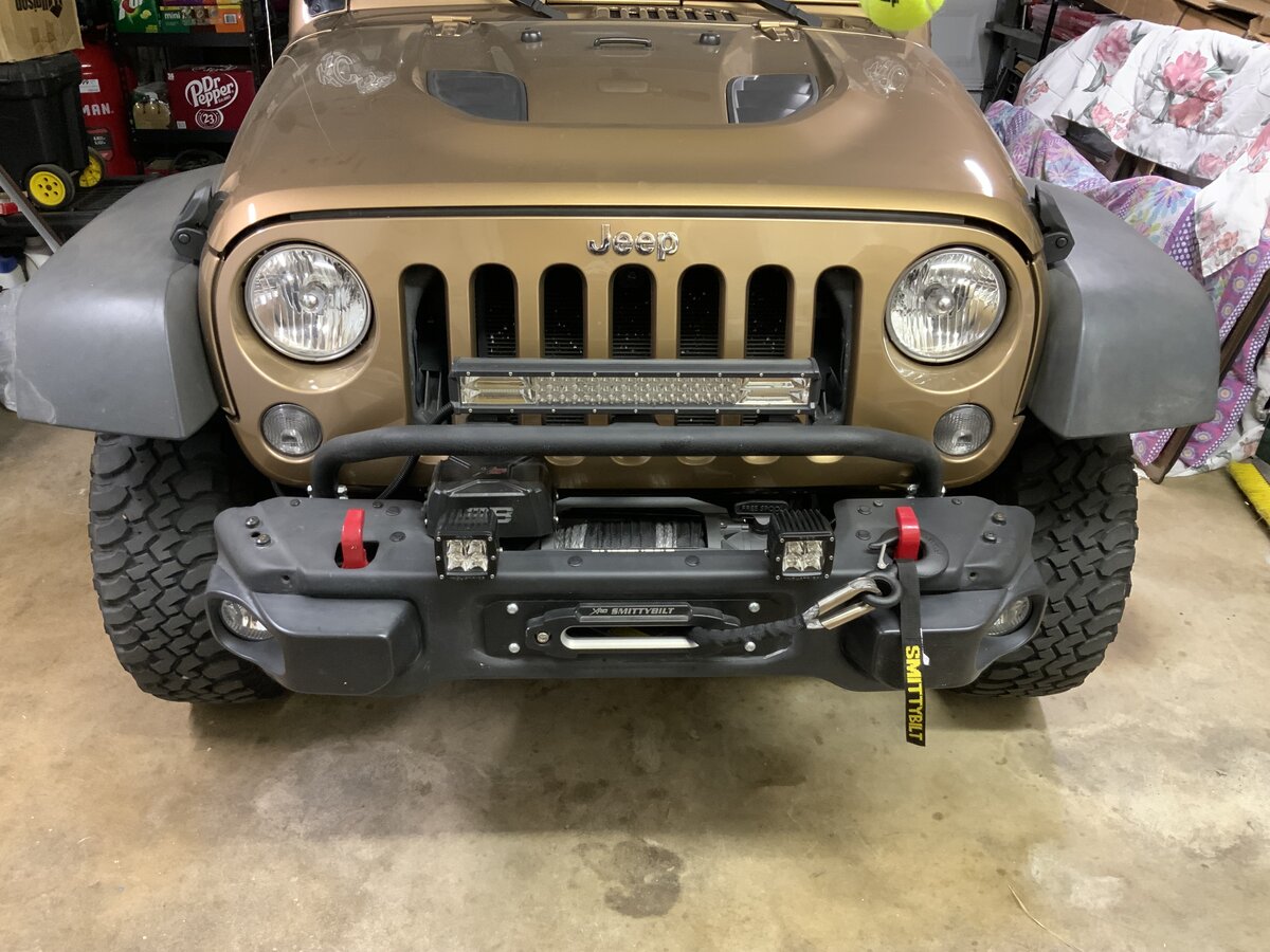

Morning everyone. Was wondering if I could get some opinions on what brand and what size you all are running on your front bumpers? Some of the threads are a few years old, so apologies for starting a new one. Pictures would be helpful. To be honest, chances are I will probably never use it, but you never know right? Lol. Thanks!
Having a winch is a great idea, even if you never get stuck. Because it means when your buddies get stuck, you get to pull them out. And that means you have the indisputable right to give them a rash of **** about it for months.

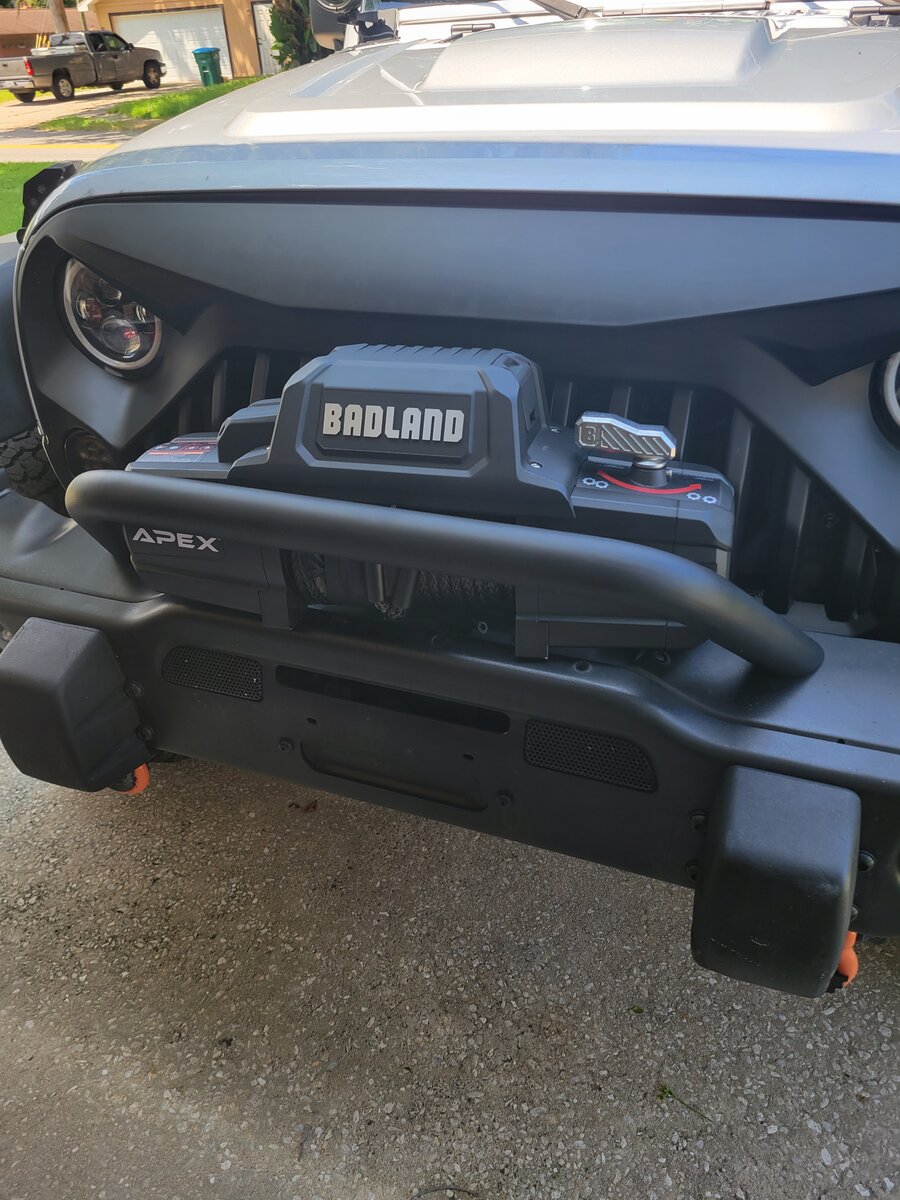

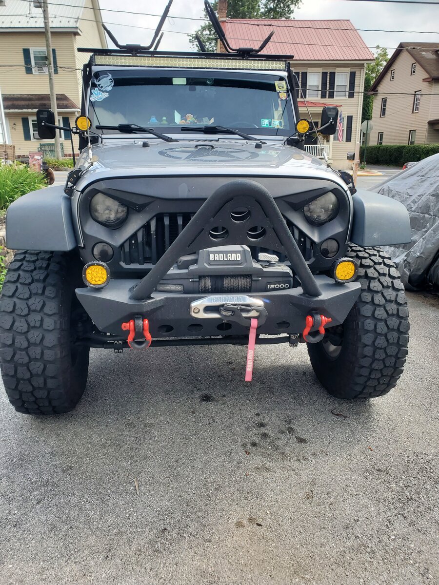

@Dirty Dog summed it up pretty good. I am running a Badland Apex 12,000 with synthetic rope. Yes, I know most will talk 💩on them and that's fine. I had other Badlands on other vehicles with great success. I also carry a tree savor, snatch block, soft shackles, thick gloves, and kinetic rope.

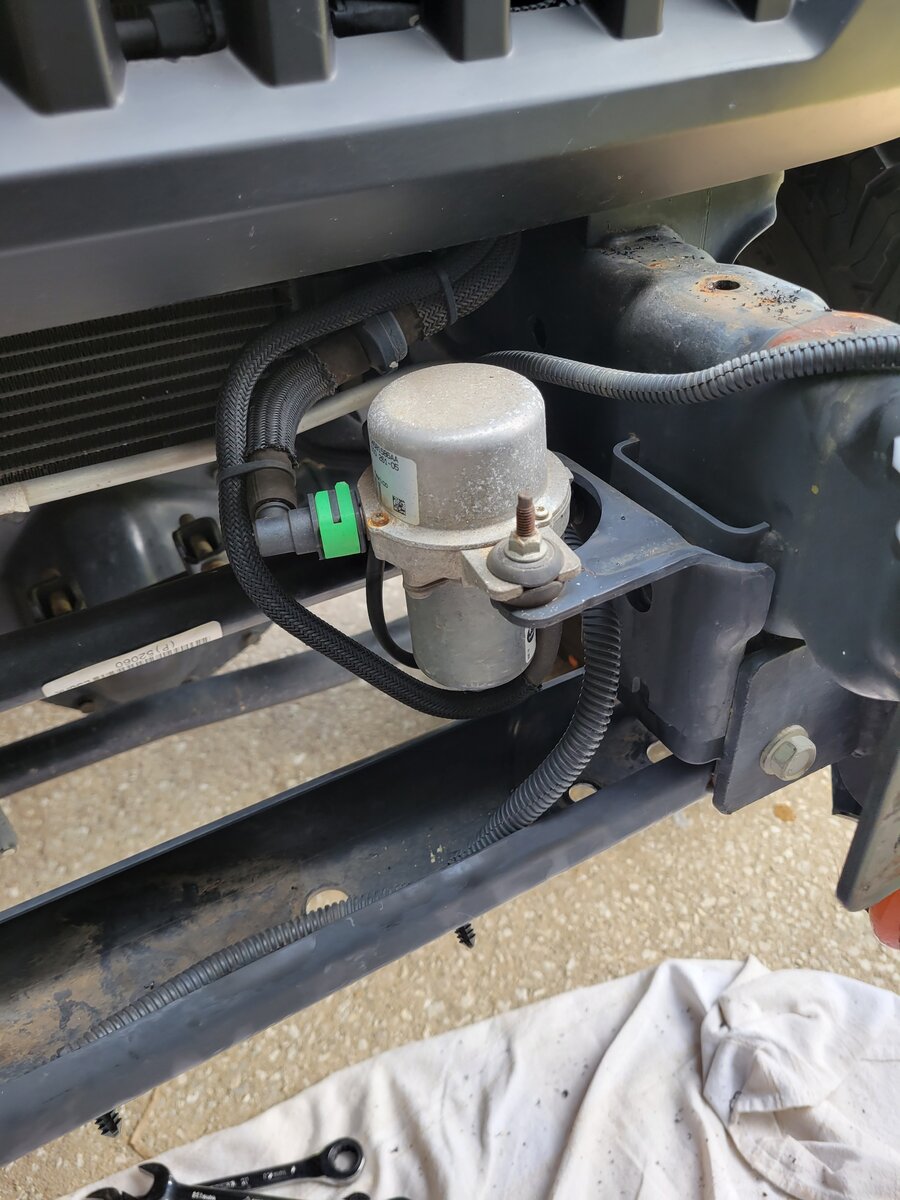

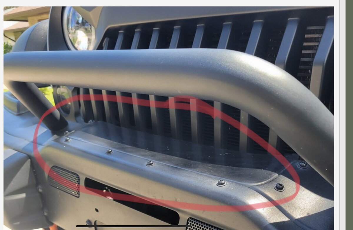

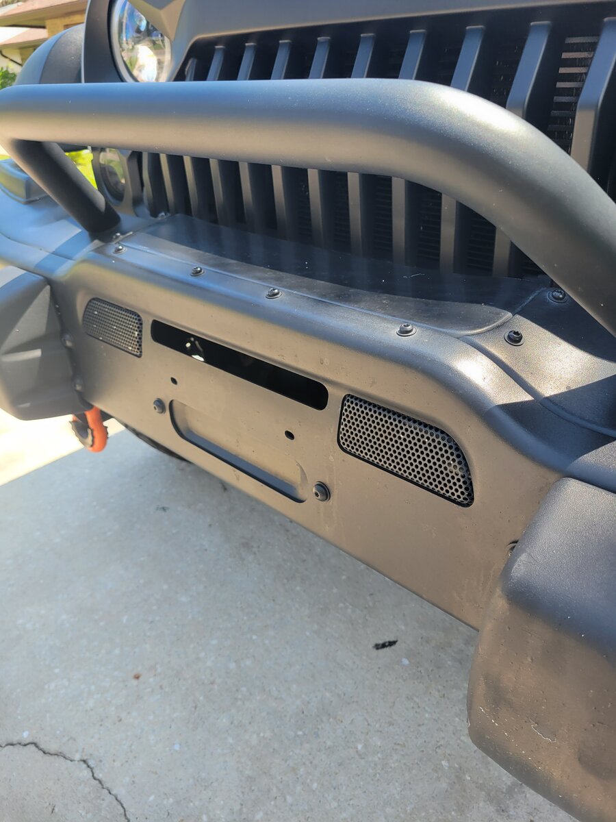

Stopped into harbor freight and bought this winch this morning. I've never mounted one, but assuming I need to remove these access plates. Will I need any adapter brackets?

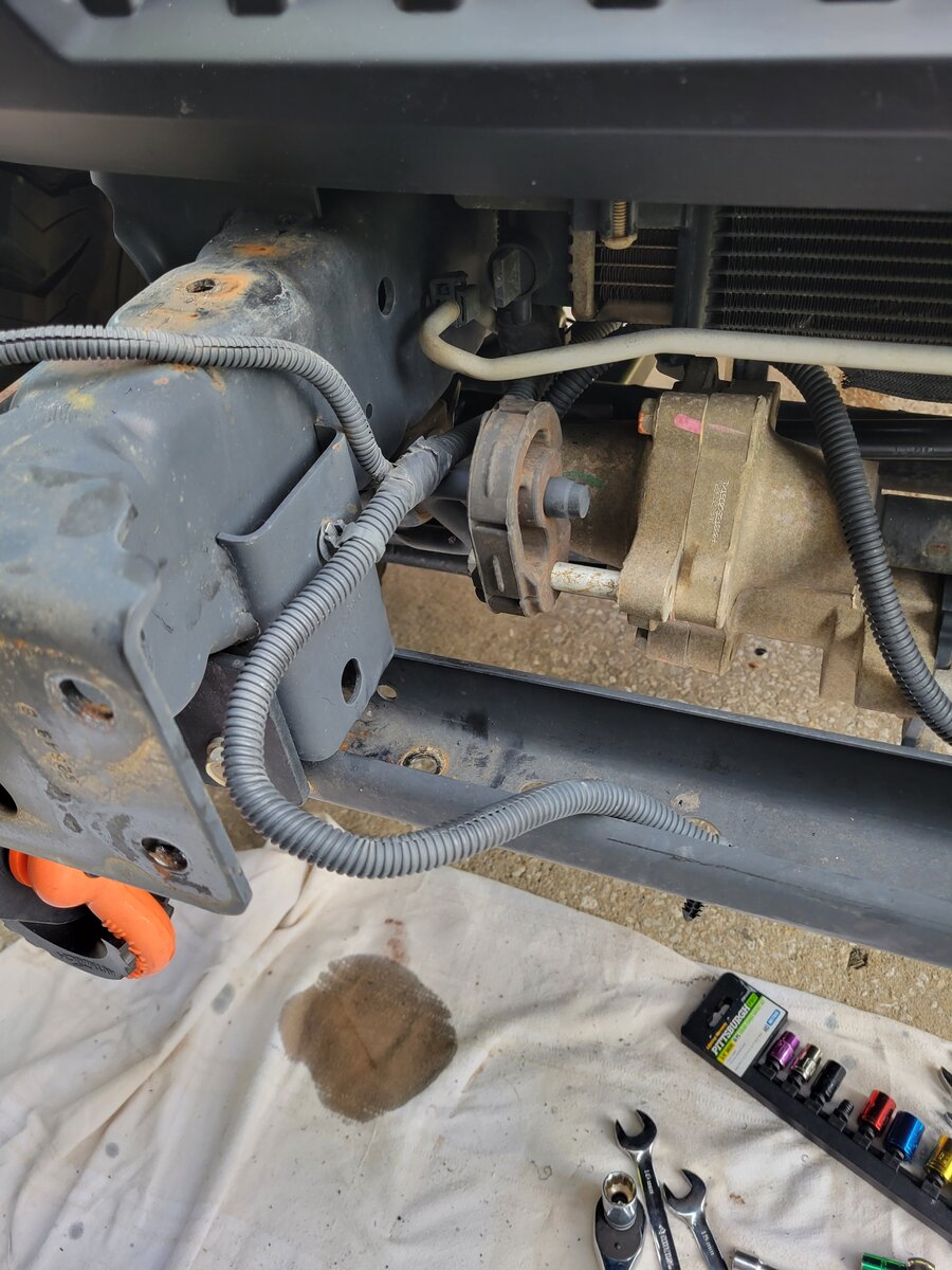

Yes those plates need to be removed. Assuming the aftermarket bumper is equipped for mounting a winch it should be good to go. If not you’ll need a winch mounting plate. You might need to relocate the brake booster pump, if so you will need a relocation bracket. There are different types out there. Some people relocate it up to the engine compartment area.
I removed the plate and no mounting provisions. I set the winch on the bumper, and it's way to big unless I start making some major cuts. Thinking I may have to return it and get a smaller one ugg
Man if anyone has any pics of the mounting, I'd appreciate it. I think it will slide in, but still may have to trim the bumper
I bought one of those universal winch mount brackets. I'm going to have to cut it down in order for it to fit. Will it hurt to offset the winch in the opening a little to clear the sway bar lock?
