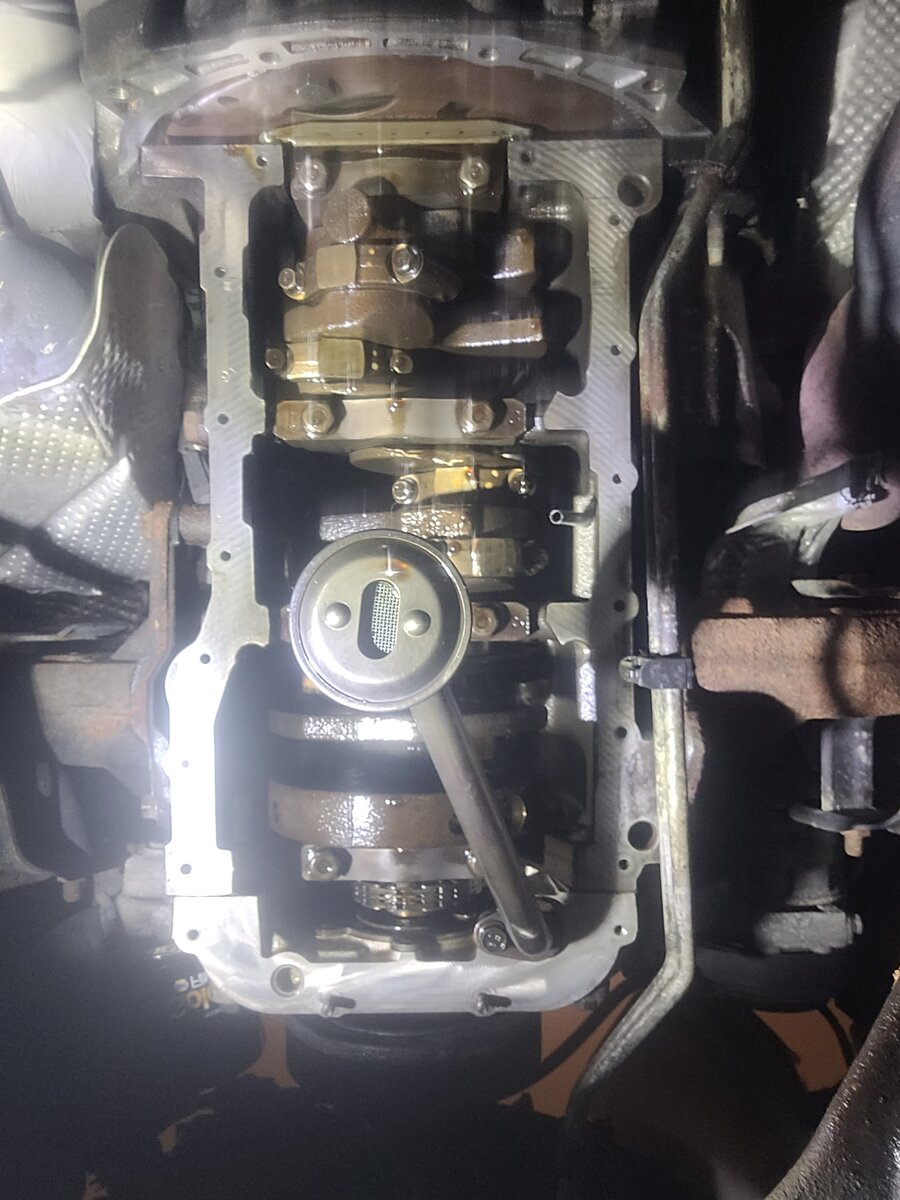

Yeah makes total sense. I mis read something. Check out the surface on my upper oil pan. She ll be ready for the new gasket in the morning!
