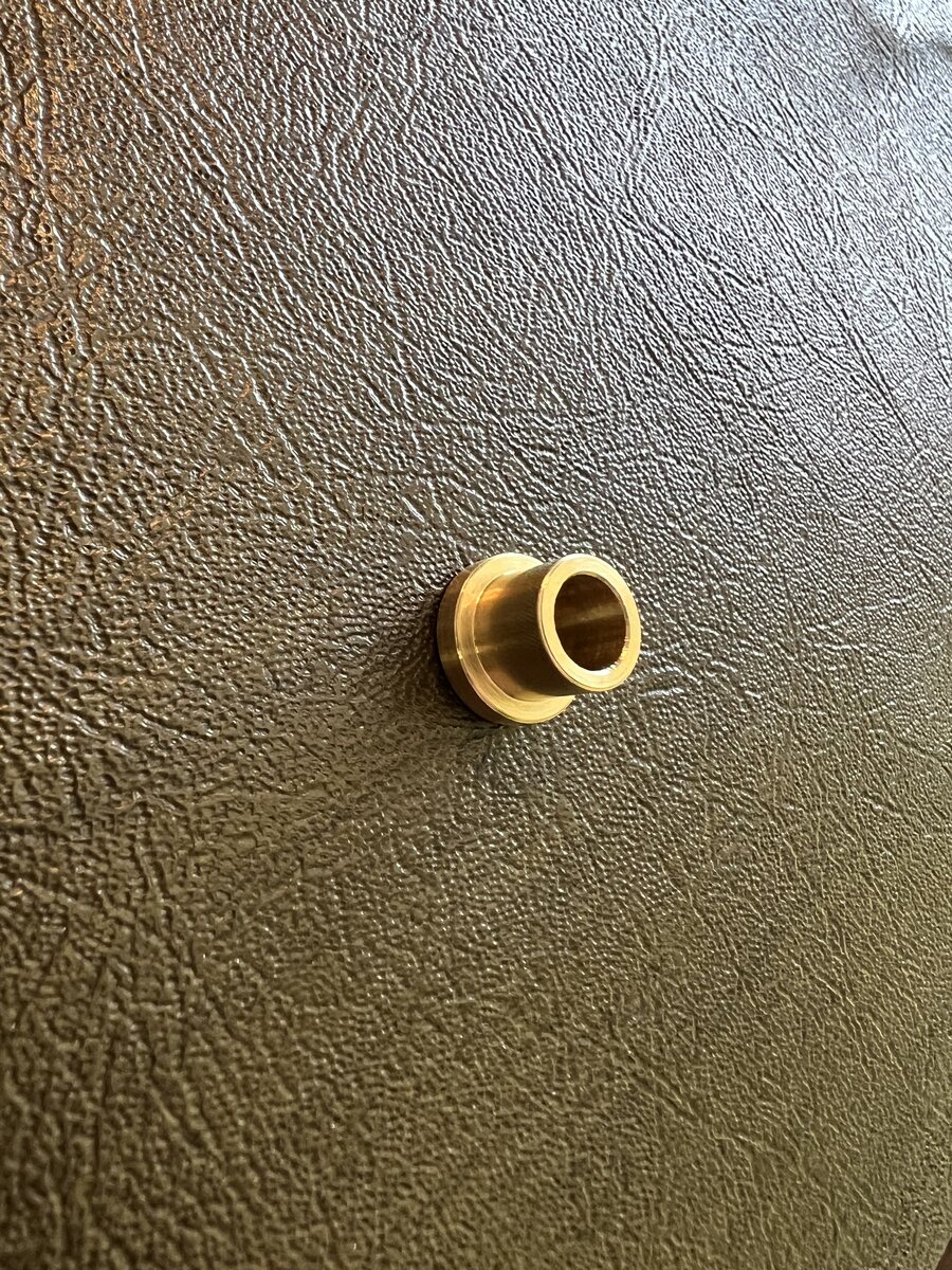

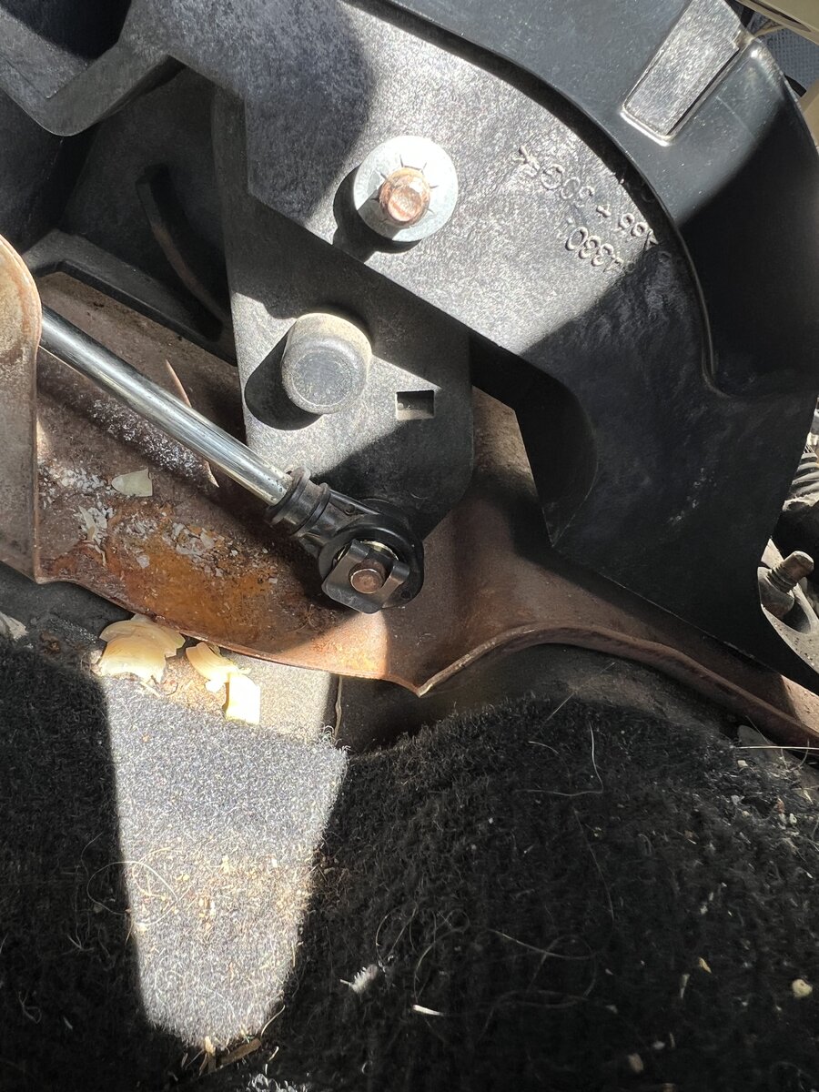

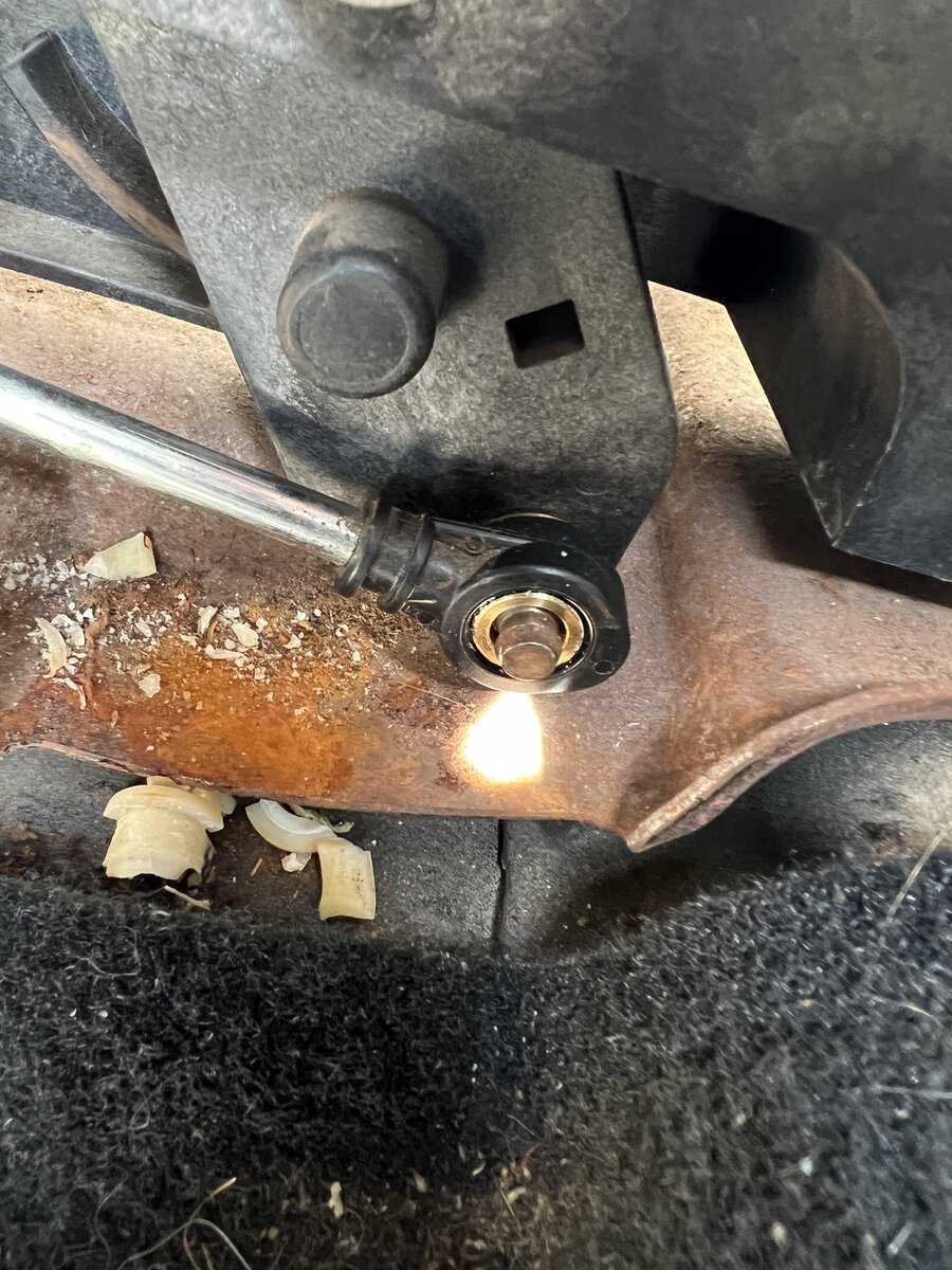

I know a lot of people have had issues with the plastic bushing breaking and wanting an upgrade. Highly recommend this part from Novak. My son replaced the bushing at the shifter location, still need to crawl underneath and do the one at the TC, but it’s the same part. You can see in the pictures the plastic worn out one. This is a nice brass piece with a metal clip, should last a ”lifetime”.
