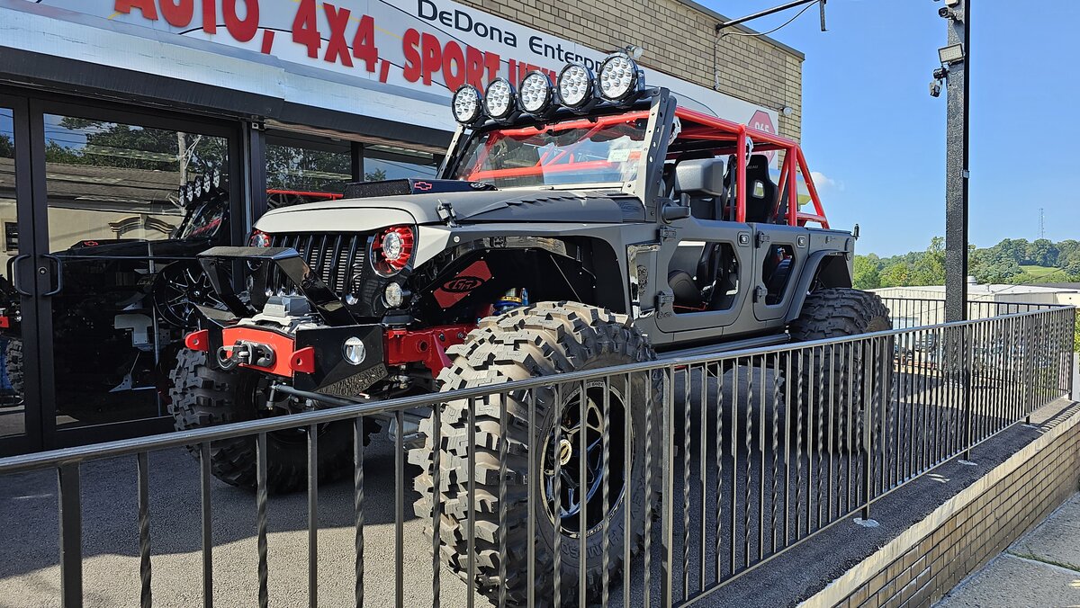

I doubt its the mechanic messing around. This is a very well established custom truck shop that primarily works on jeeps. These are the kind of people that brand their reputation, go to SEMA and build their own jeeps from ground up. They built this one (in pic) literally chassis first. Why would they mess around? They literally steered me away from buying certain extra stuff for my jeep because they said it wasnt needed lol. They truly look out for their customers and gave me veryyy good deals that various web stores couldnt match. Jus sayin

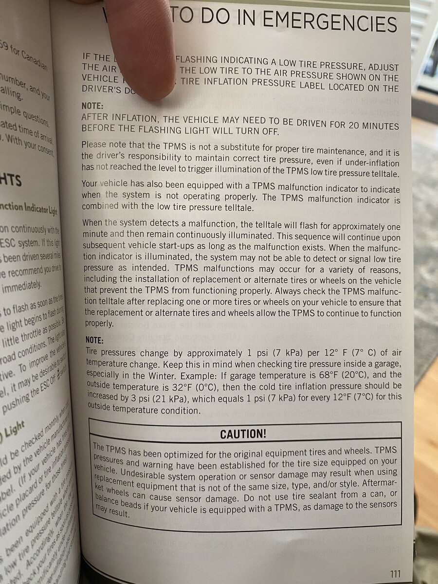

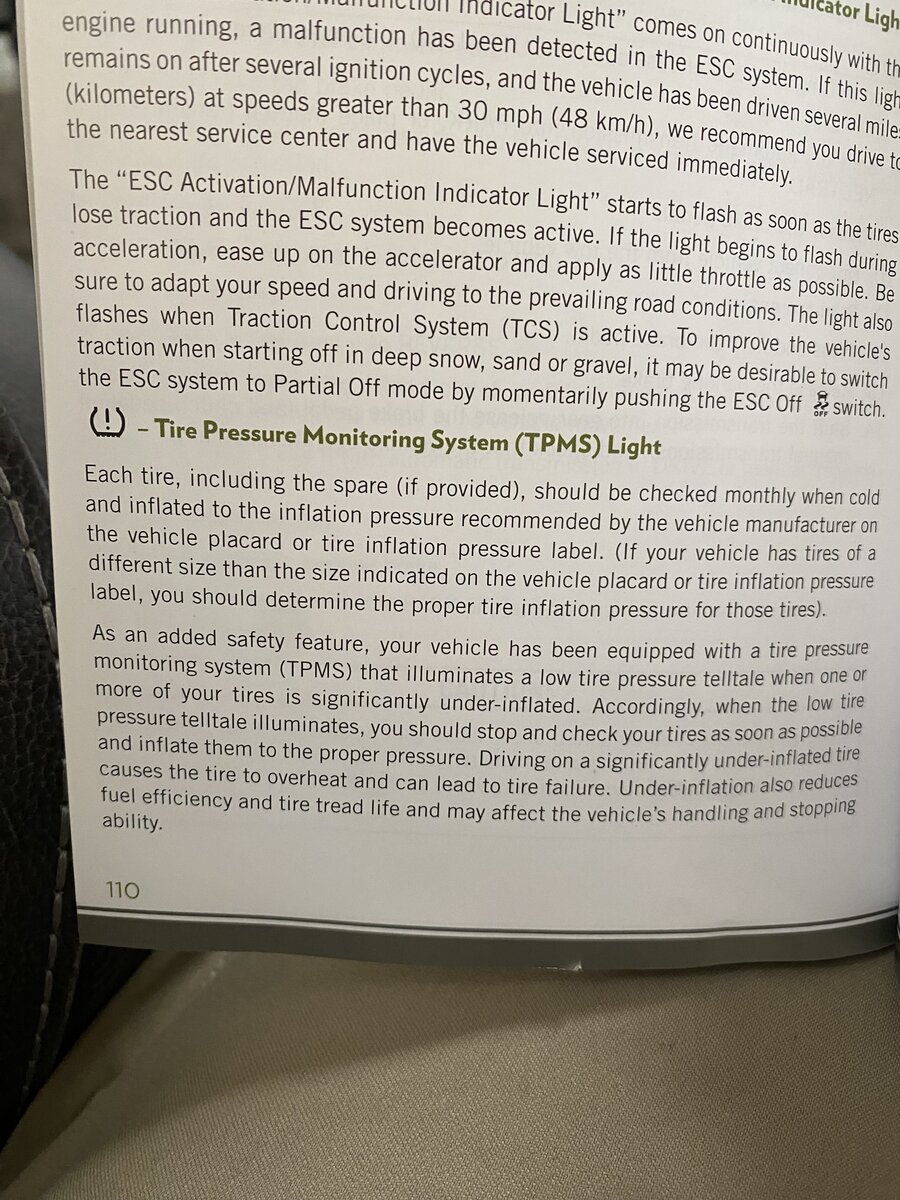

For reference, I just looked up the info in the owner’s manual.
No mention of reprogramming, no mention of a reset/learn button under the steering wheel, etc…
But it does state that after inflation, it needs to be driven for 20 minutes to make the light go off.

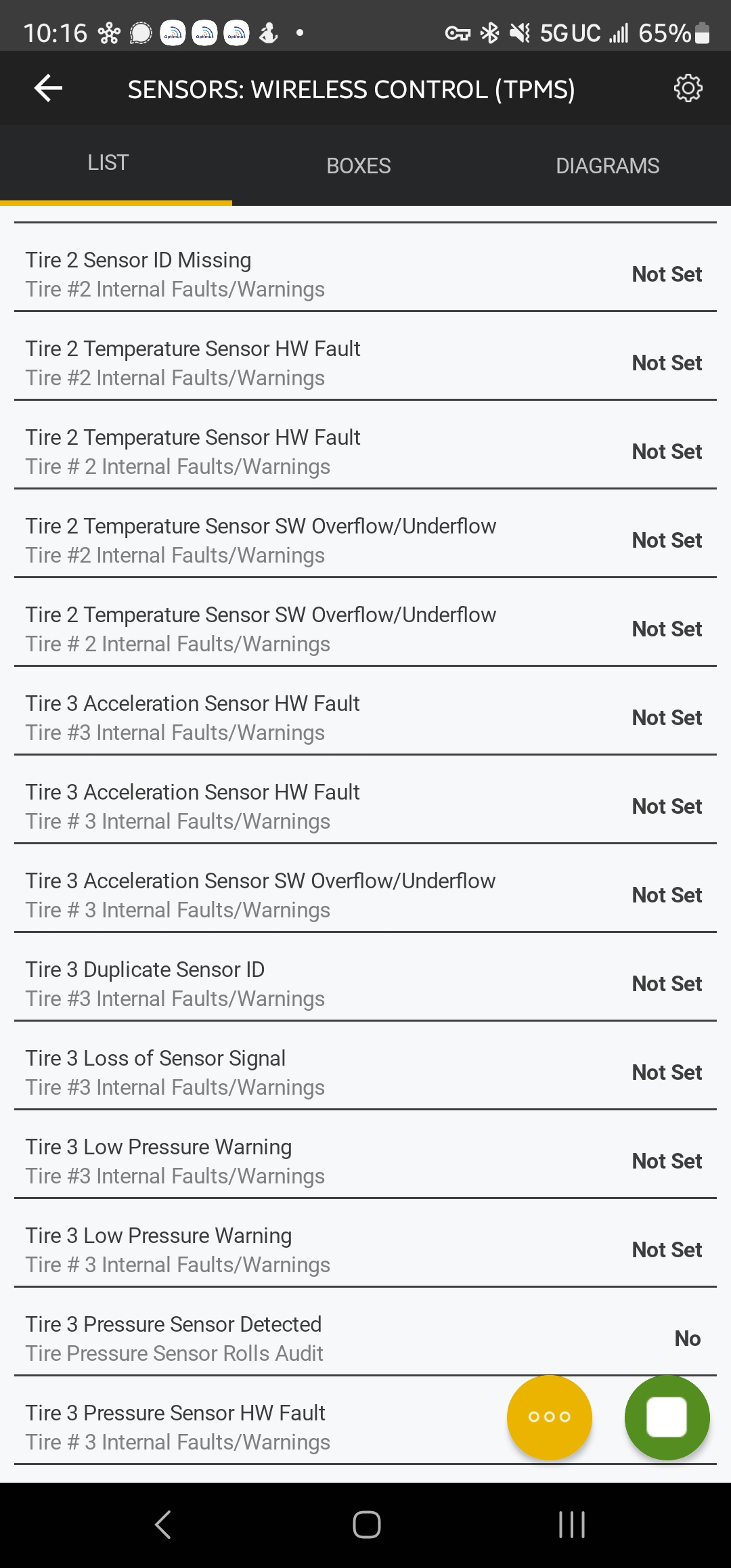

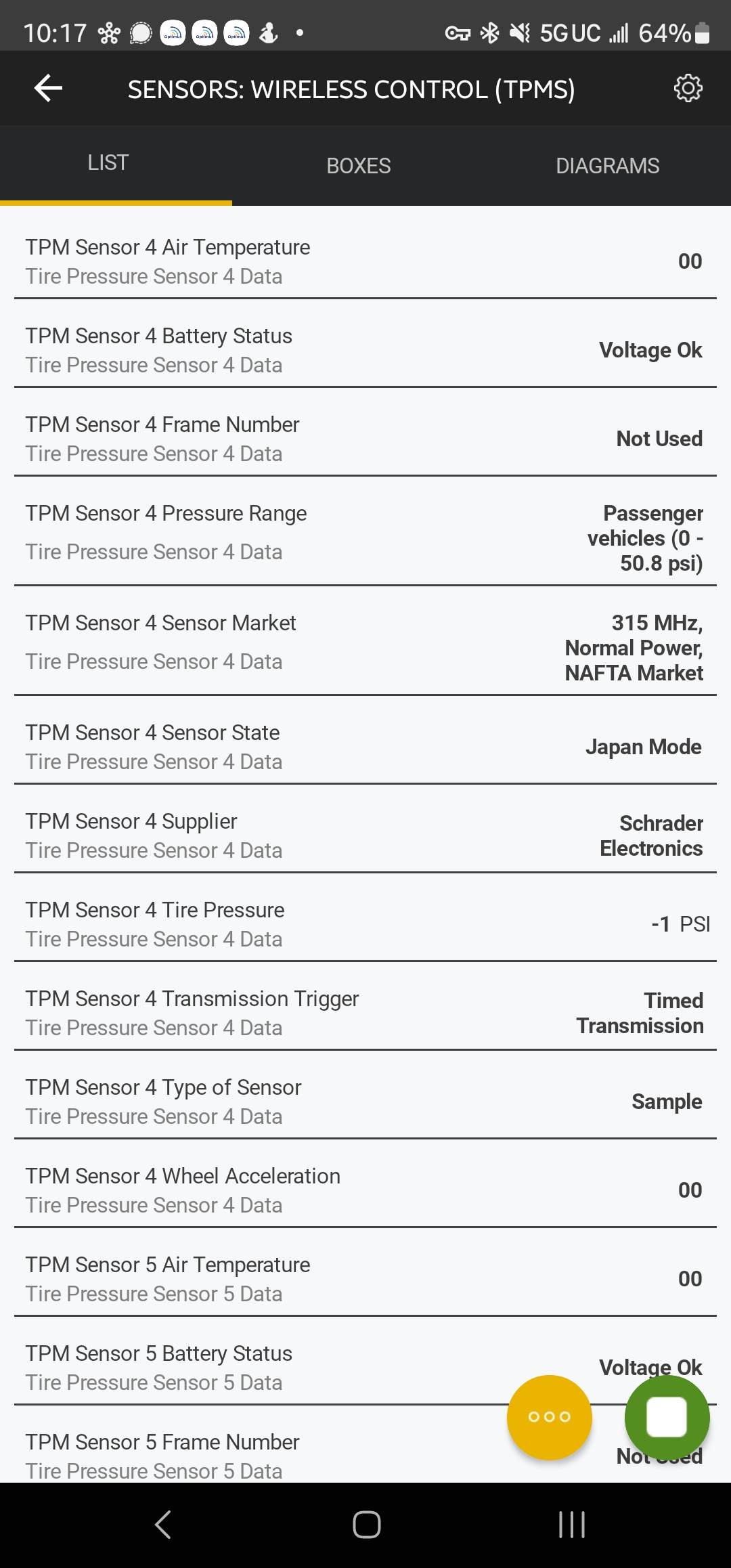

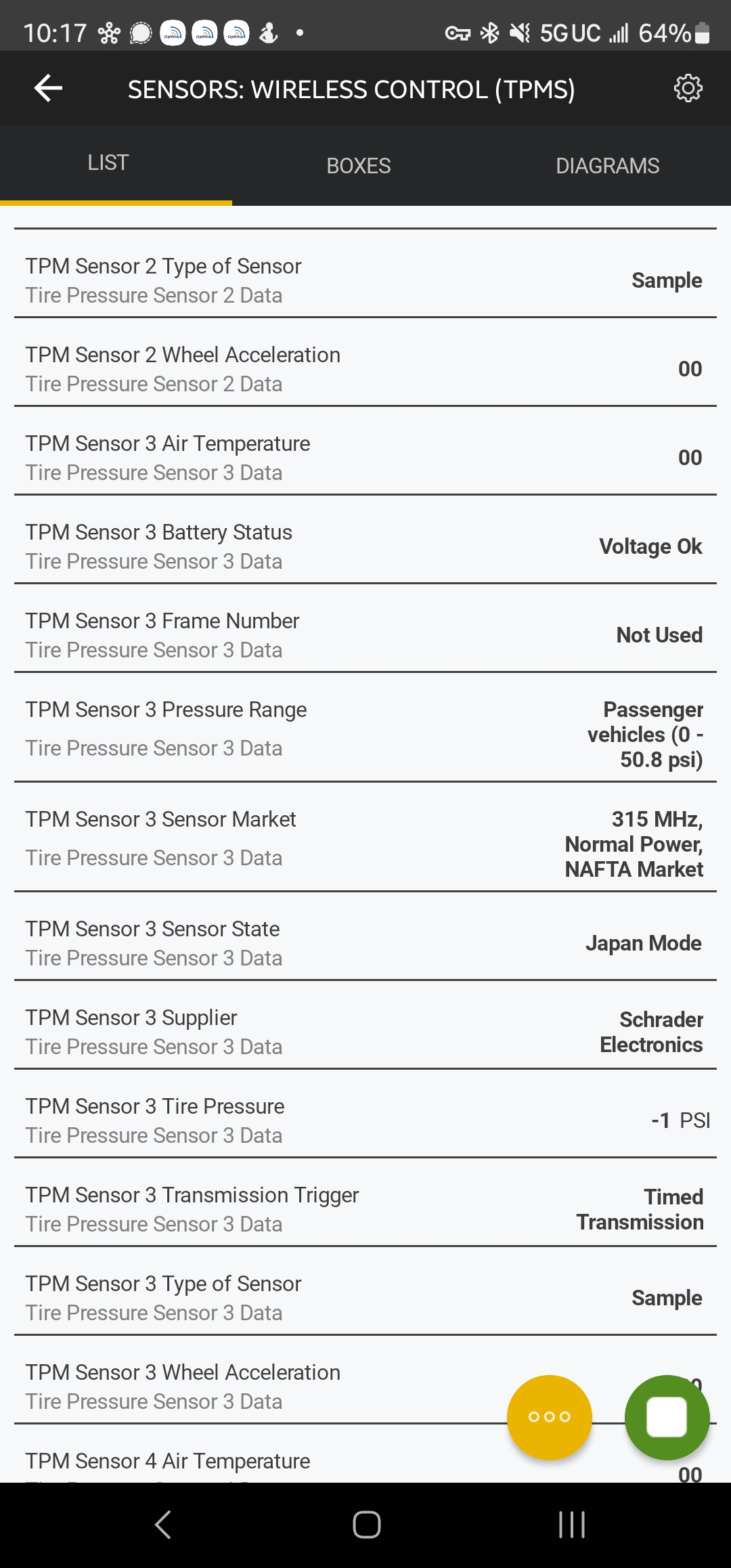

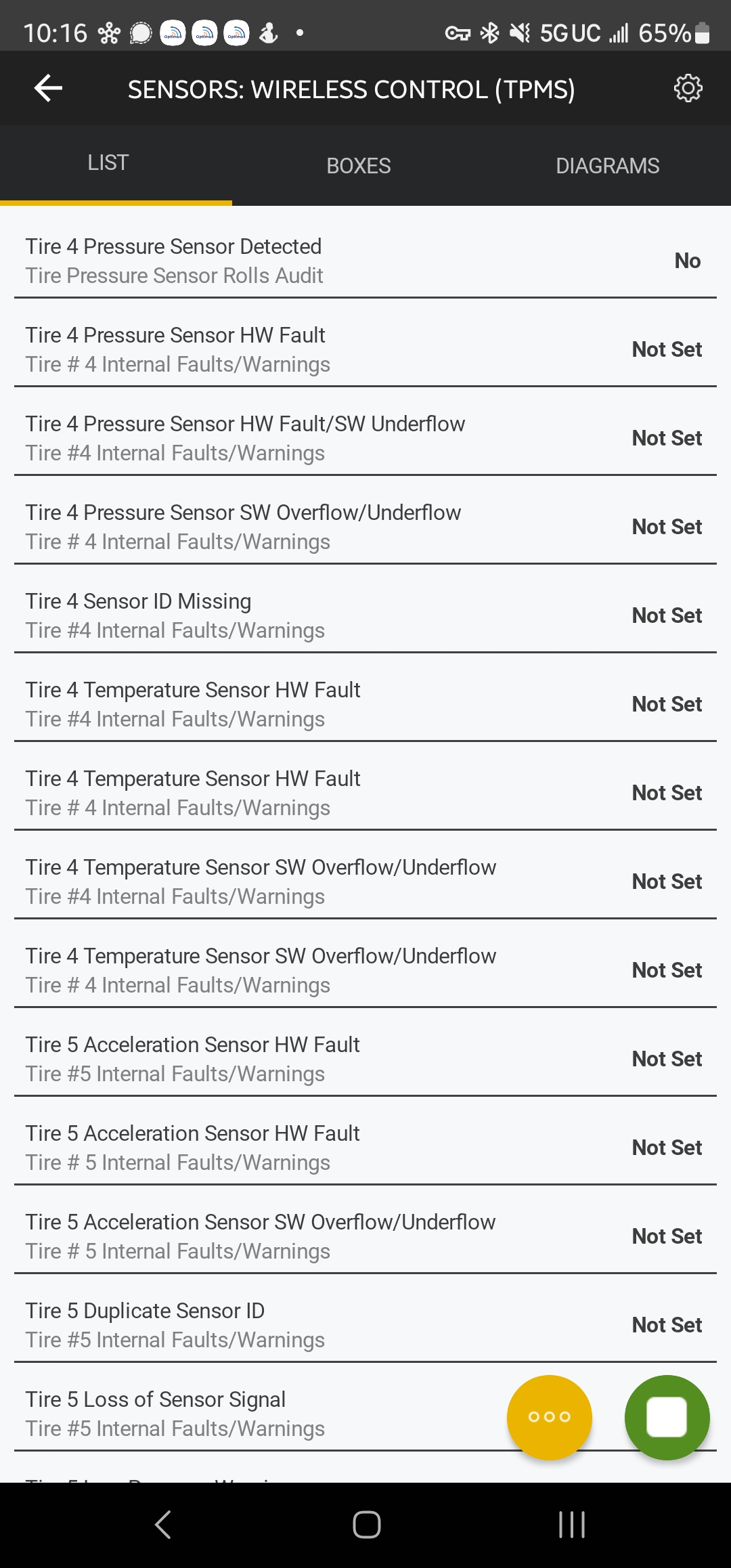

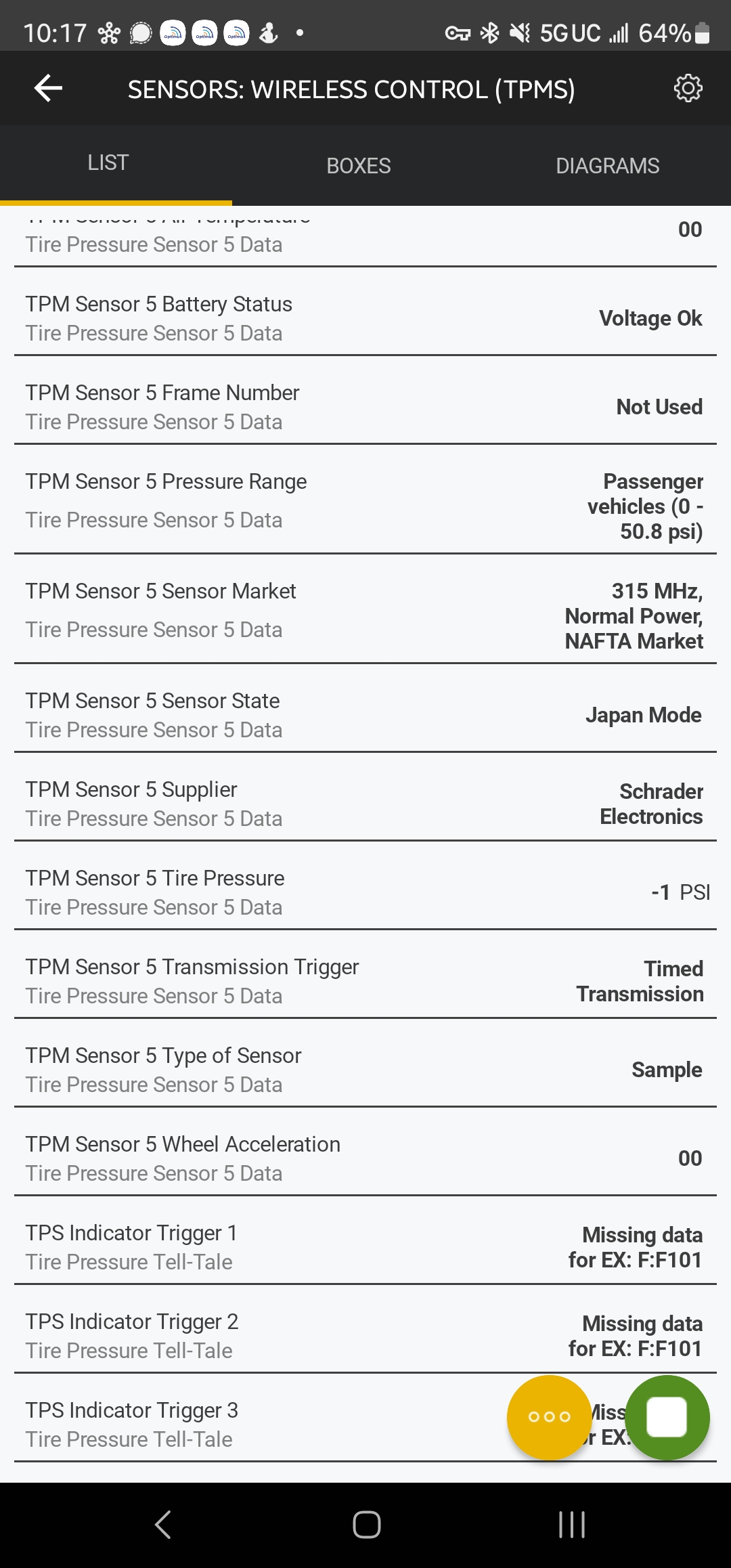

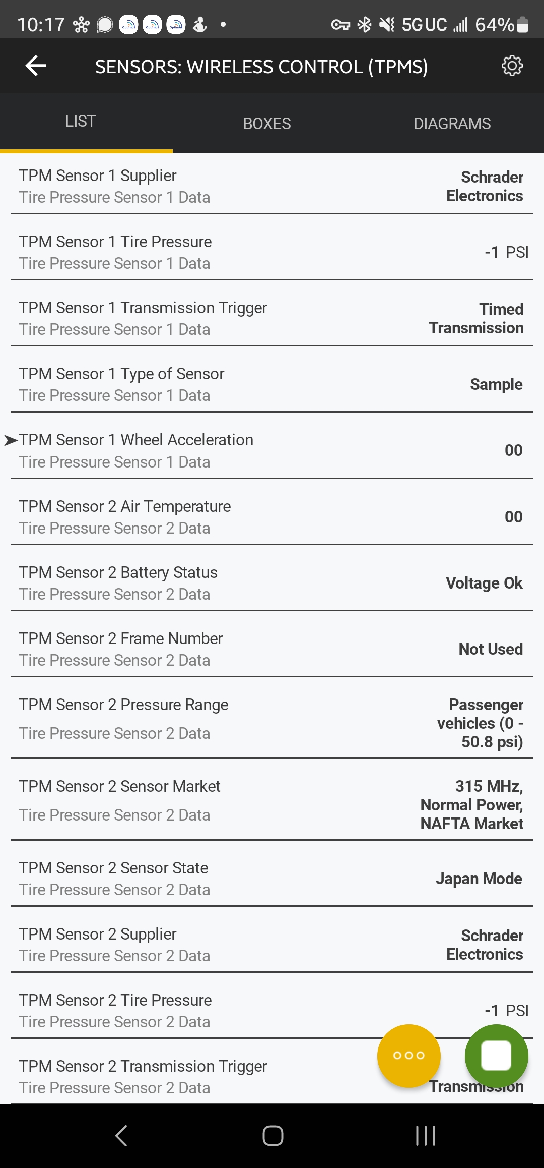

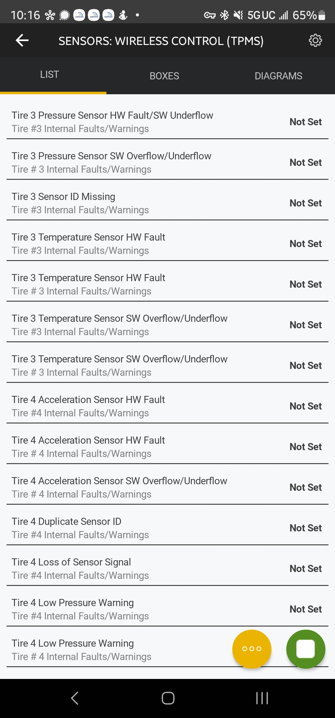

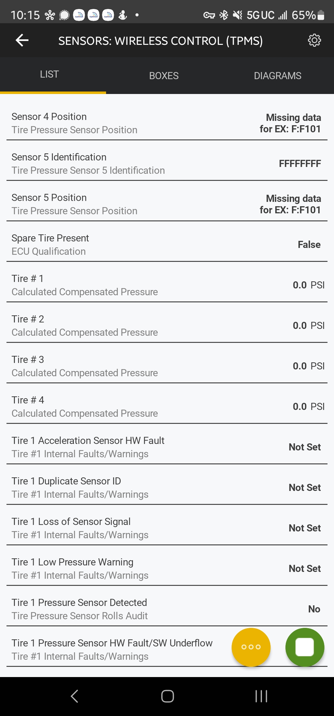

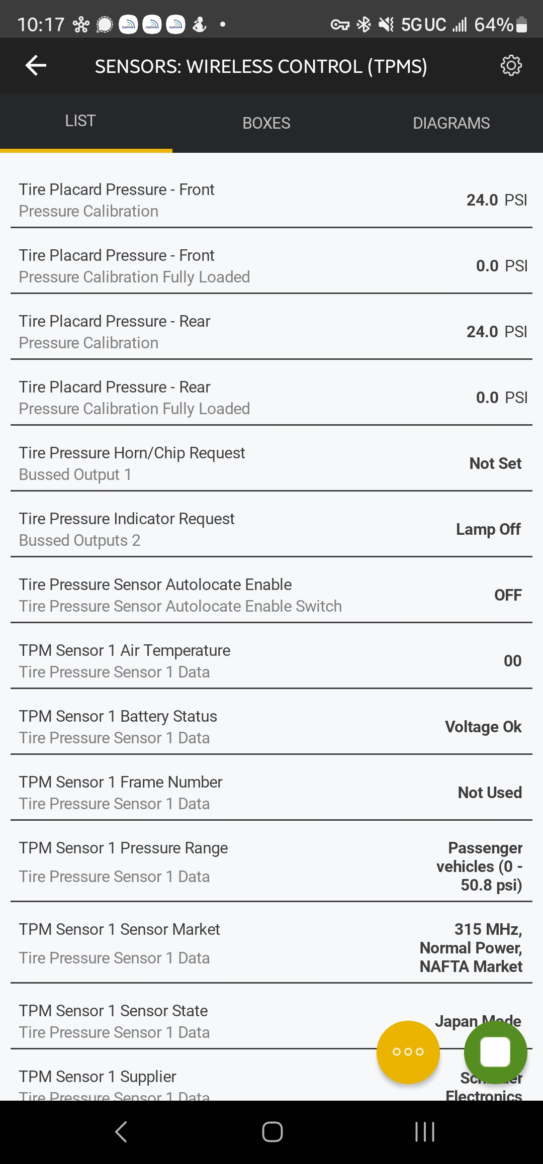

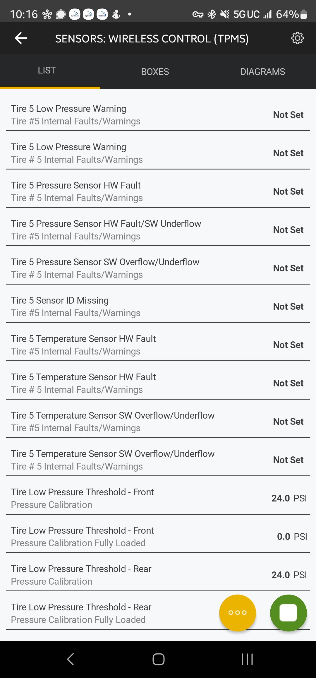

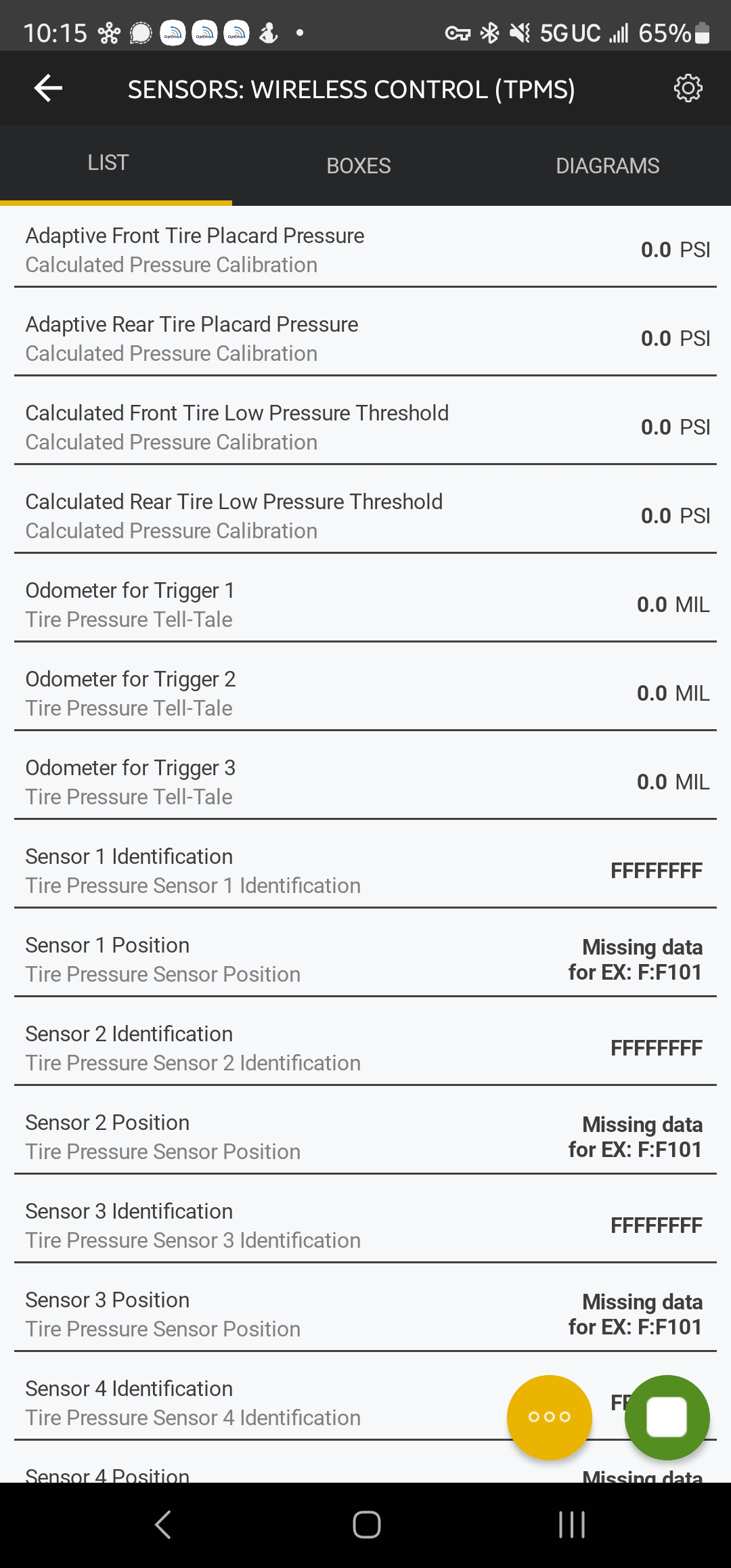

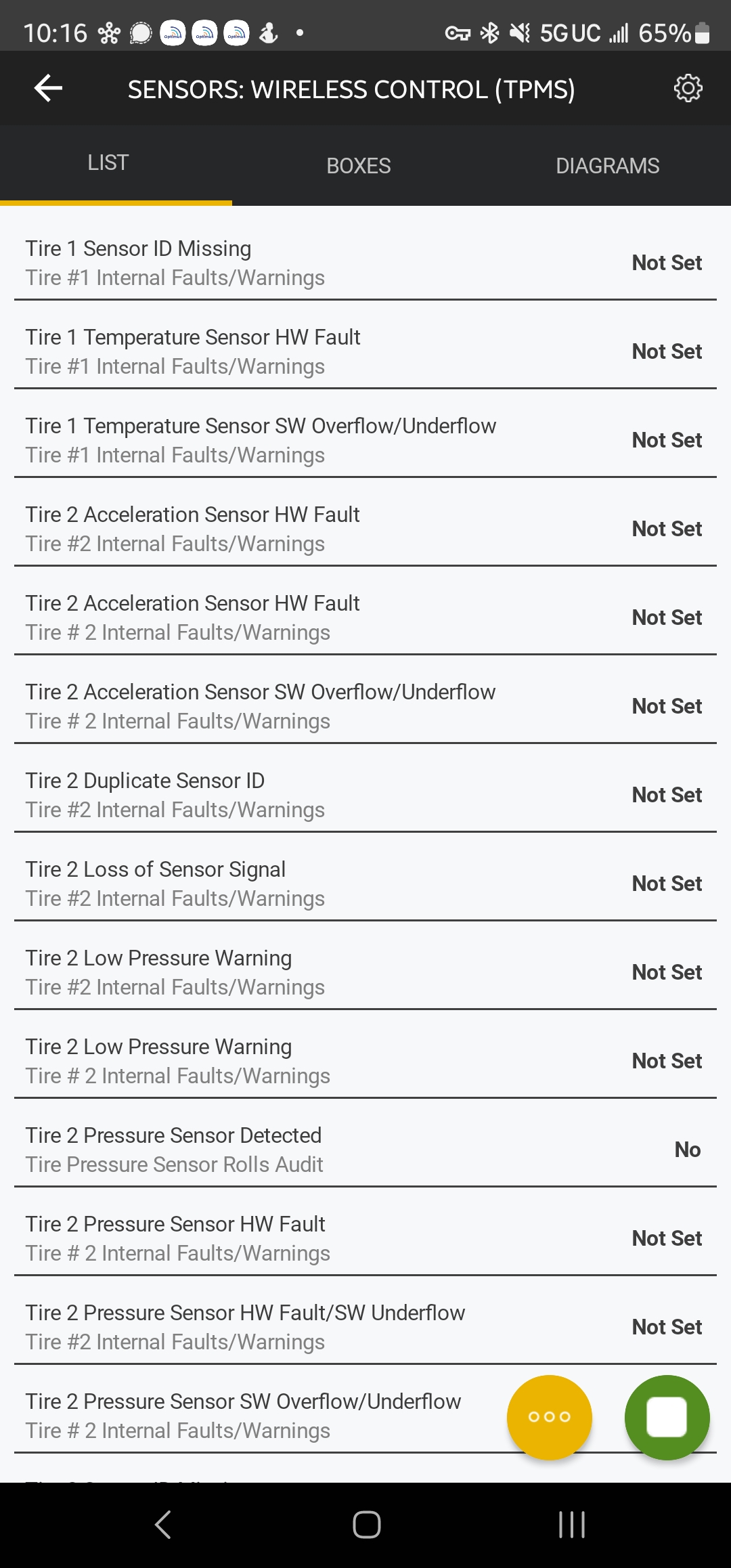

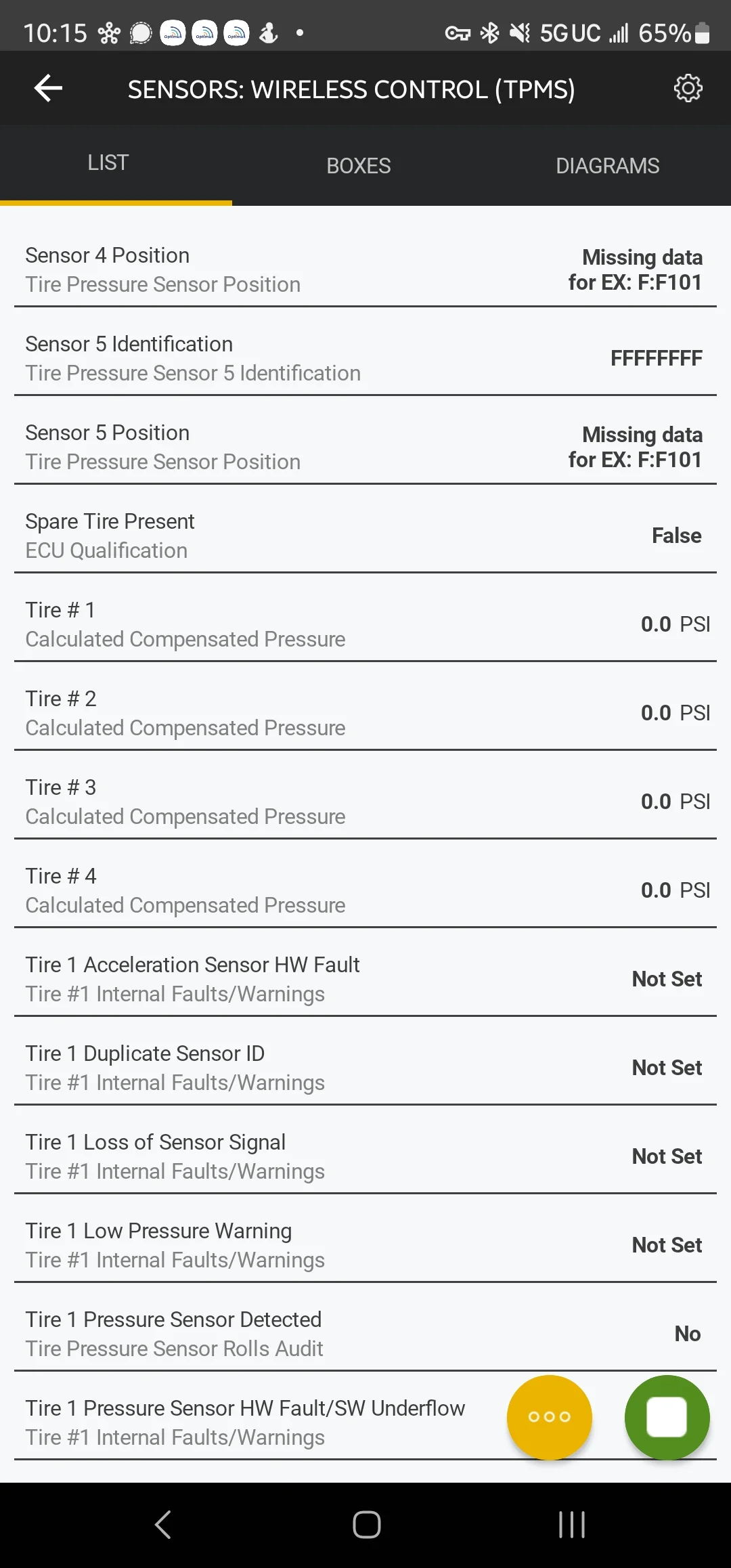

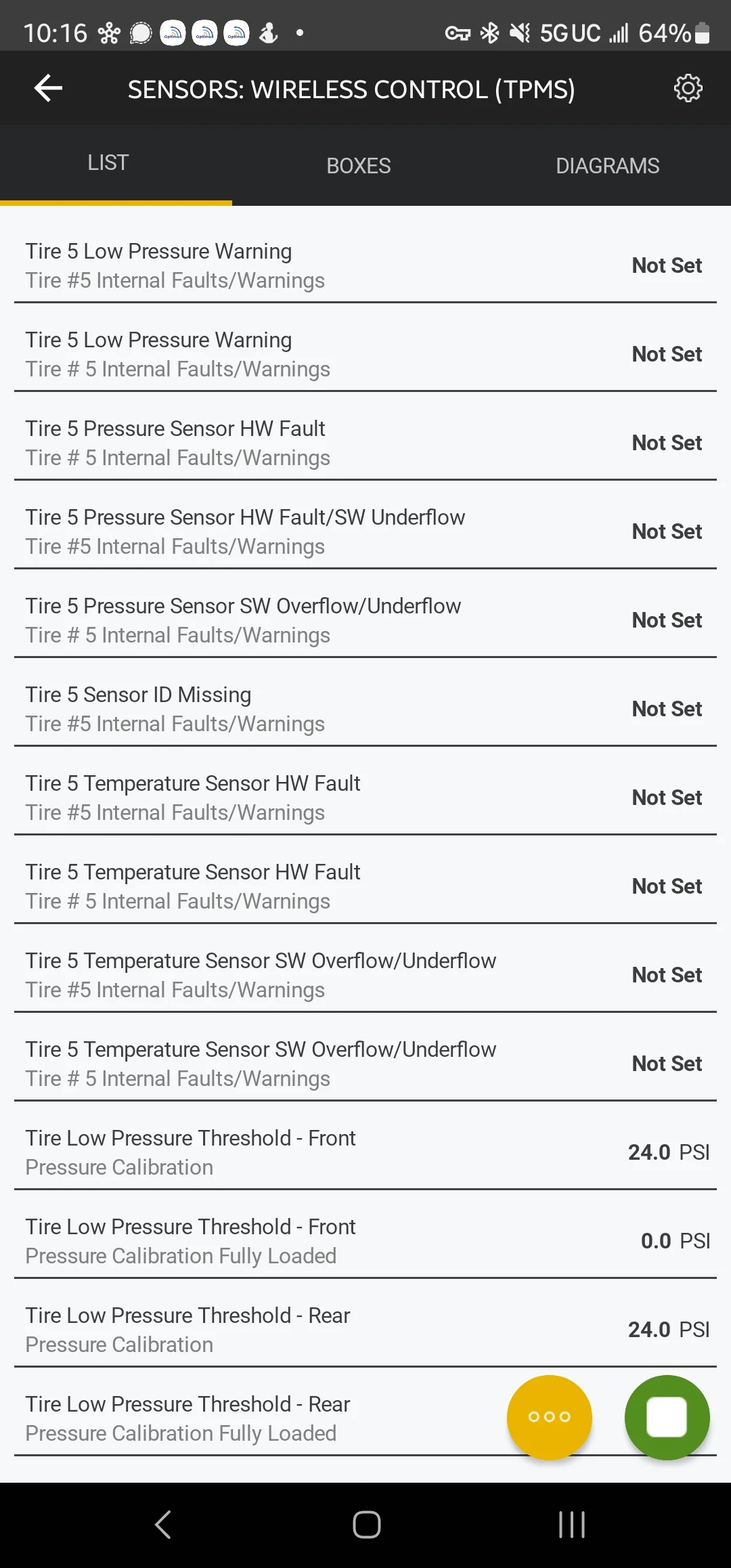

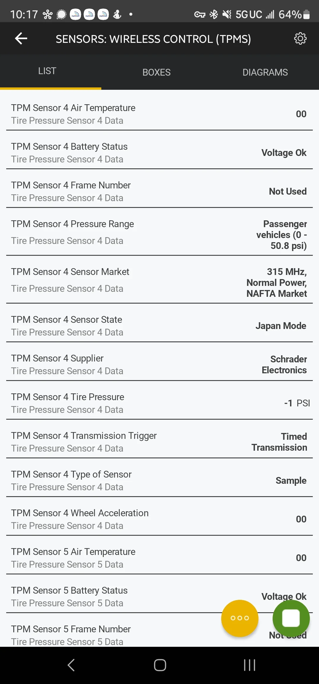

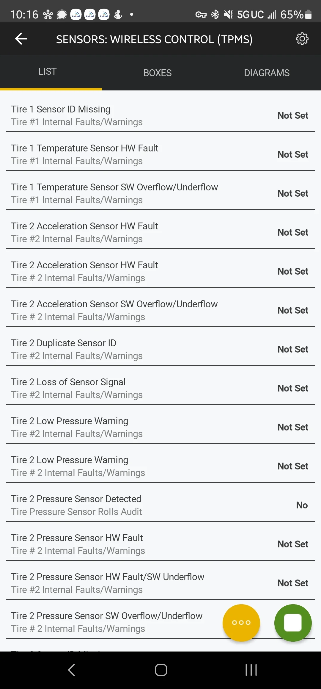

Ok so i was digging into jscan. Autodetect TPMS was disabled. I enabled it and 2 min later the app says its a no go, disconnect scanner n try again.
The live data shows that it can see the sensors but it's still not working? Attaching screenshots. Any1 got any idea?
Btw the auction they are 433mhz but jscan says 315mhz? Is that old data or did the seller send me the wrong ones? (Seller refunded me already and says new ones are out of stock)

That was active data. I searched "tire" and selected all pid modules from the search. Most of these i cant seem to edit at all and most dont show up in the separate TPMS module section.

If it’s live data, none of it’s editable. Merely showing what can be read from the system.
