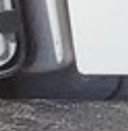

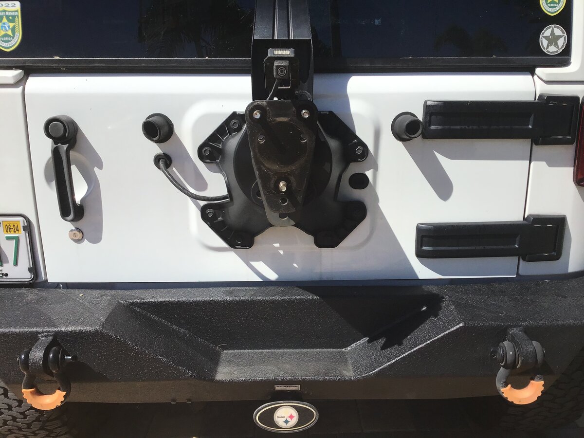

I removed the spare - looks ligned to me. Just hate to go to the healer if I can work this myself. The locks sound like it’s functioning correctly. Using the key doesn’t help.
Judging by the pic I agree with @macleanflood . Looks low on hinge side .
When I put on rear tire delete replaced hinges as well . All you have to do is loosen hinge bolts attached to tail gate while it’s closed . Check alignment, snug bolts and test . It’s probably over the years moved out of alignment or the hinges are worn . The heavy spare on the back is tough on hinges and the gate itself sometimes causing tailgate to warp .
