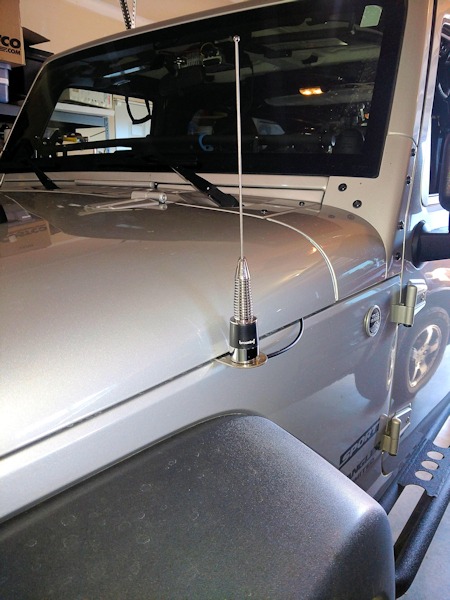

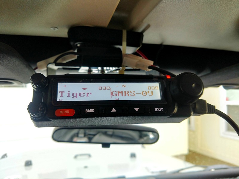

This is what I run for GMRS mobile. Wouxun KG-1000G and exterior antenna, I like the ability to have one channel for the run and the second one for scanning for other rigs,! I still have the hand held CB that converts to a exterior antenna and cigarette lighter power supply for the logging trucks. I started with a Kenwood 8180 first for GMRS but I made that one into a base station that will reach Tiger Mountain 56 miles away. Still may get in to the Ham world but for now this meets my needs, I have used my current setup with other units and brands on the trail and all worked well.

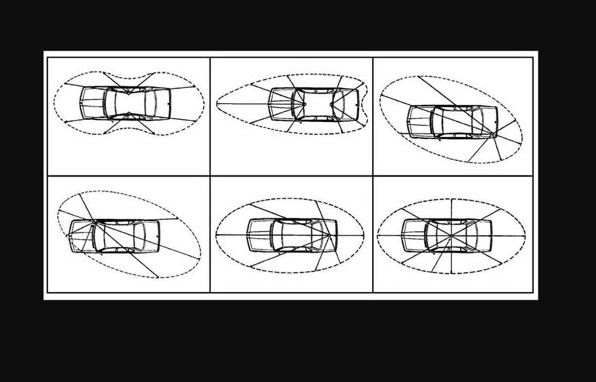

your antenna wave propagation is out the rear passenger side , ( thats your strongest xmit range direction )
