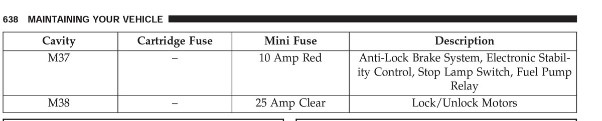

If fuse M37 it serves the fuel pump, not sure if that would have caused a short in the system somewhere or not. I would double check that each of the battery post and cables are clean and tight. Have you tried to scan for any codes?

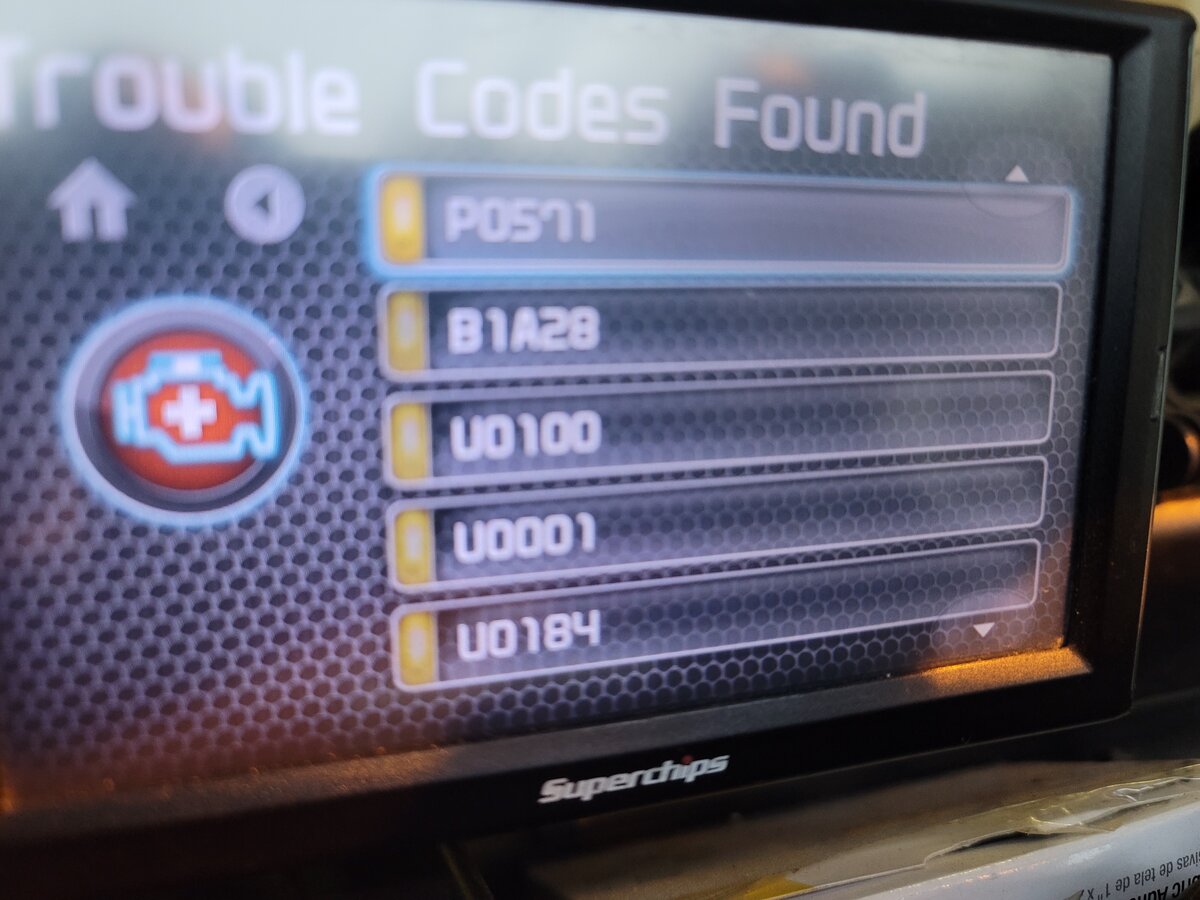

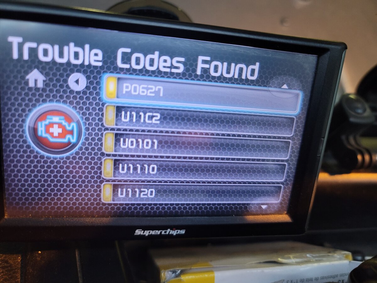

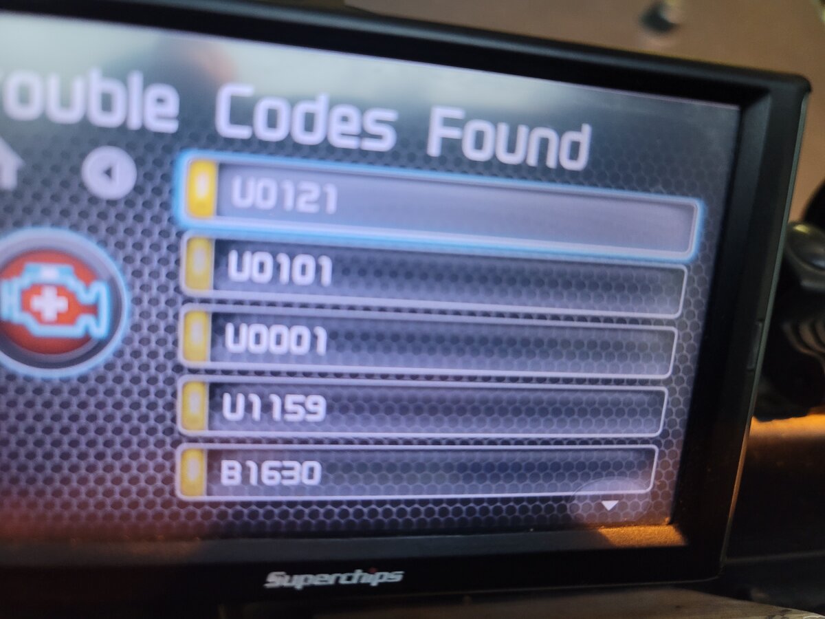

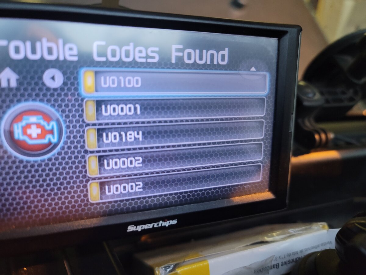

Fuse box is good the wires coming from the sway bar to the fuse box are good. Still getting hot oil light. Is there a way to check your pcm?
