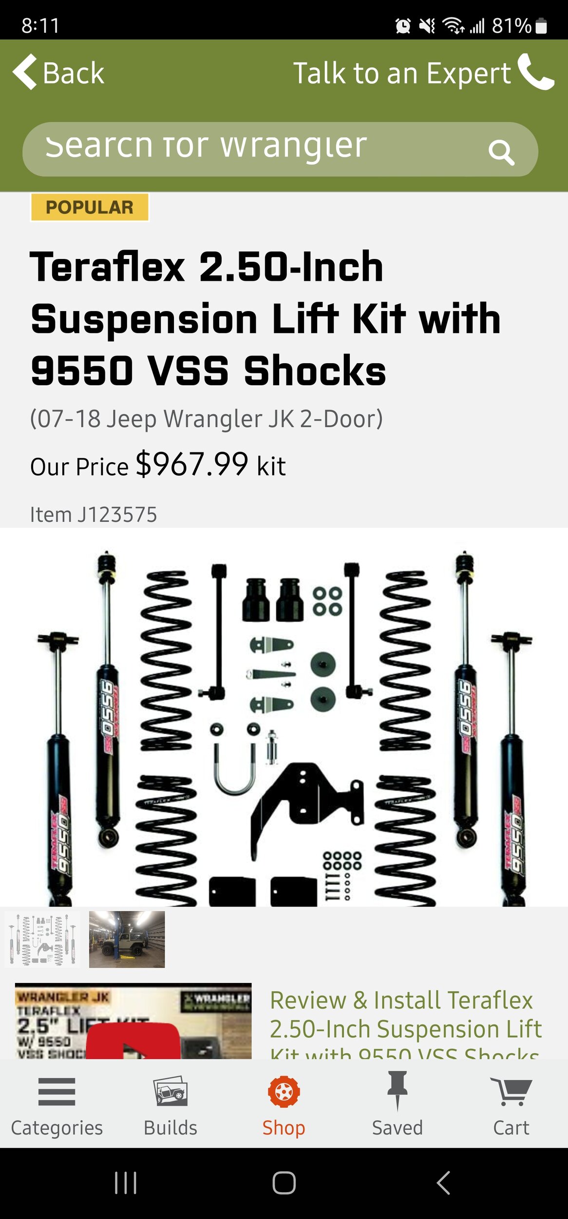

Thank you all for your recommendations. I ended up with this one. My concern now is for some reason the front end seems much lower then the rear. There were 2in metal spring spacers on the previous springs which I removed. Doesn't seem to have affected anything but I thought it would lift all the way around equally should I put the spacers back in to lift the front up a bit?
