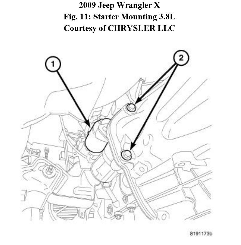

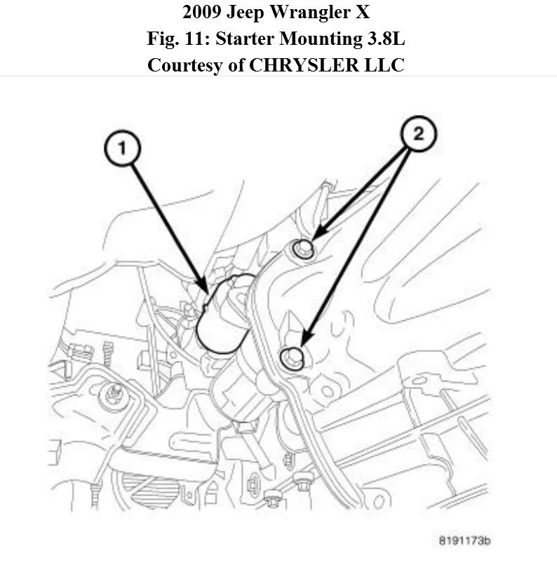

The pictures of a new starter it looks like there is 3 bolts holding it on.
From what I saw it looked just like the video linked. Just 2 bolts and that top nut. I can look around again but pretty confident I wasn’t missing any?
I just looked at video again and counted 3 threaded holes in the starter both new and old one.
Three holes only two bolts.( Mechanical Porn) Did you try hitting it from the top or bottom with a mallet and a long piece of would to free it?
