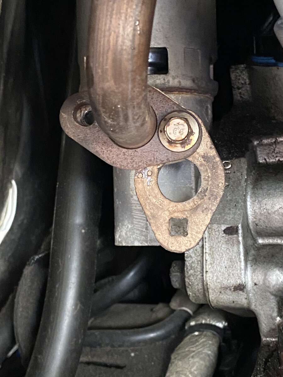

Plus and wires were fine , it was the pipe that bolts onto the egr valve , a bolt had came out and was loose . Put two new bolts in and it’s running like a top now

That pipe goes to the top of the intake so you was loosing manifold pressure, so that must have been the problem. The faster you go the more pressure it was pushing out at the EGR.

I’m just not sure why it presented it self after the tuneup . My wife says it wasn’t running rough before I did the work . I may have put my hand on that pipe and jarred it a bit but not enough to knock out a bolt .
