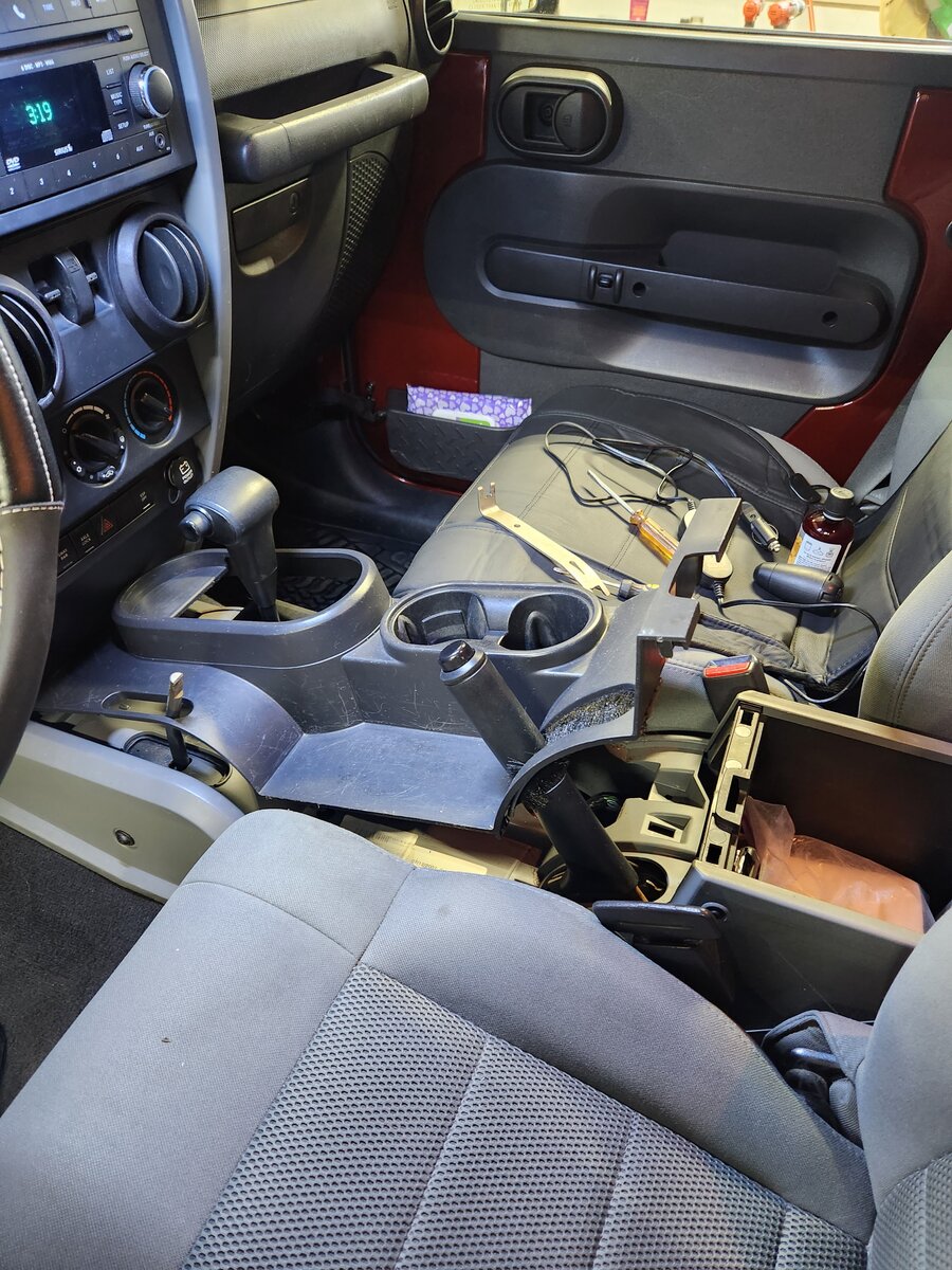

I raised the console lid and started there ... you will need to pull the 4x4 shift knob (pull straight up) ... hand brake needs set to allow the top to be removed ... I wouldn't do it if it's real cold ... might brake it ... I ordered bulbs from e bay that's supposed to be a oem replacement .. Mopar shift bezel indicator lamp bulb ... ms820083

I hate to break your heart BigAl but ... I think the bulb is about all you're going to do by pulling the center bezel :( ... I'll try and post a pic ... (try)
