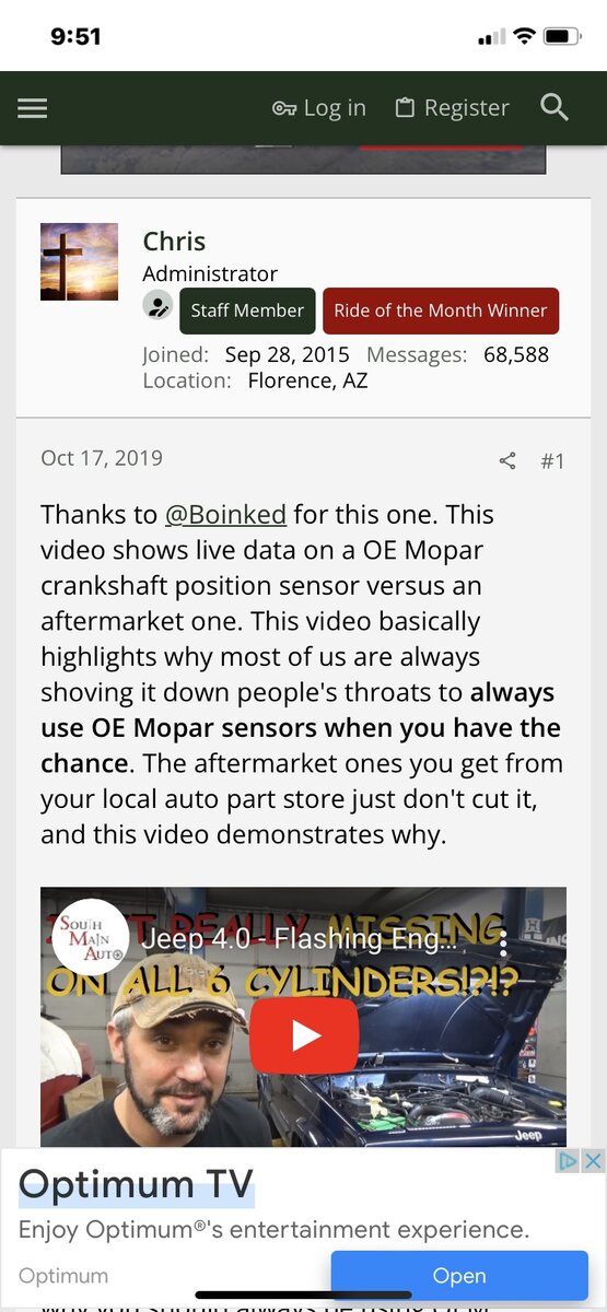

How many OEM bits do you think are used in a hard core build?
Thread from Chris
Opinion is not proof. Anecdotes are not science.
