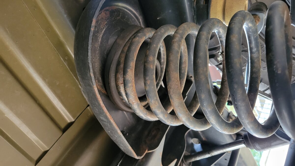

2016 4 door on 3 inch terraflex. Wondering why this is bowing, how can I fix it and if this spring is still usable if I just adjust the placement or should I just get new springs which I wouldn't mind.

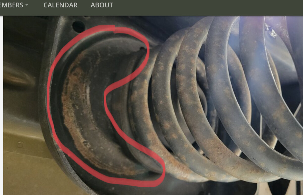

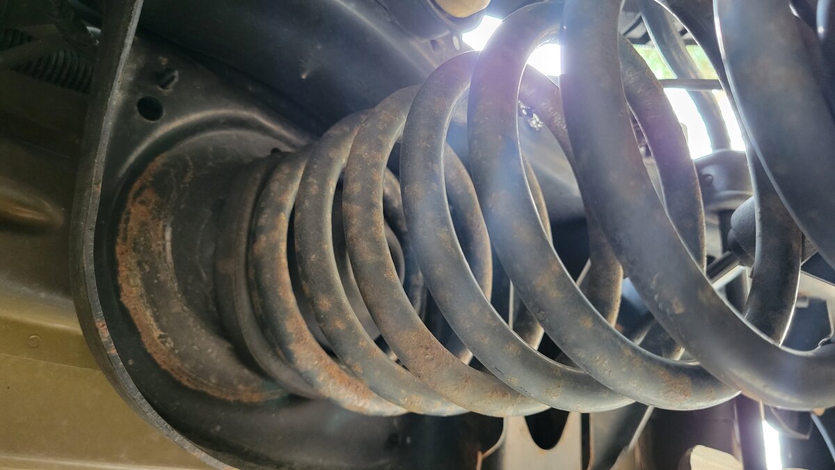

The spring is not in the right spot, it should sit forward in the grove, see the picture. It could have gotten over extended got loose and slide out of place.,
The spring is not in the right spot, it should sit forward in the grove, see the picture. It could have gotten over extended got loose and slide out of place., View attachment 121943
