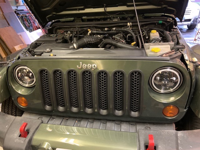

i saw something on there facebook page not to long ago to also turn on the HID setting. that is to prevent LED "blinking" as they said it. staight from the the jscan facebook page
Do you have Jeep JK with aftermarket LED headlights installed? Yes? Do you have problems with blinking? We have solution to that problem.
Go to JScan app and activate set two options to "Active":
- Miscellaneous settings -> LED Quad Headlamps
- Miscellaneous settings -> High Intensity Discharge Lights
When booth options are set to "Active" blinking should be resolved."
It's the LED headlight feature.
Later model JKs had the option of LED headlights from the factory. In order to get around the flickering caused by LEDs and the CANBUS system, Jeep added a parameter in the PCM that would allow the dealers to enable it for LED headlights.
Once enabled, the flickering goes away. I added the factory Mopar LED headlights to my JK (it came with halogens), which then caused the annoying flicker. I used the J-Scan app to enable enable the LED headlight option, and the flicker went away!
