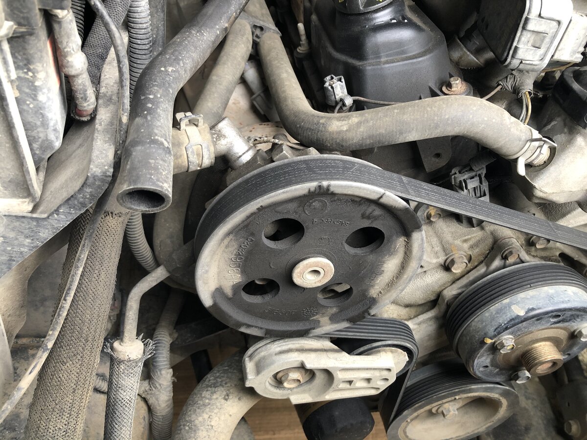

Before

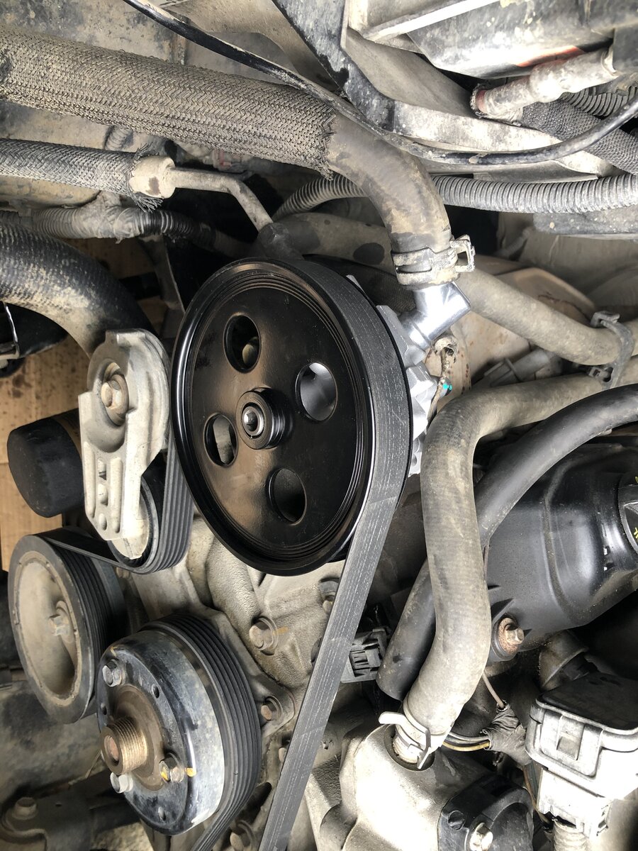

After
Installed new power steering pump today . Ended up flushing the system as well .
Fluid was pretty grungy . New pump works as it should 😊
