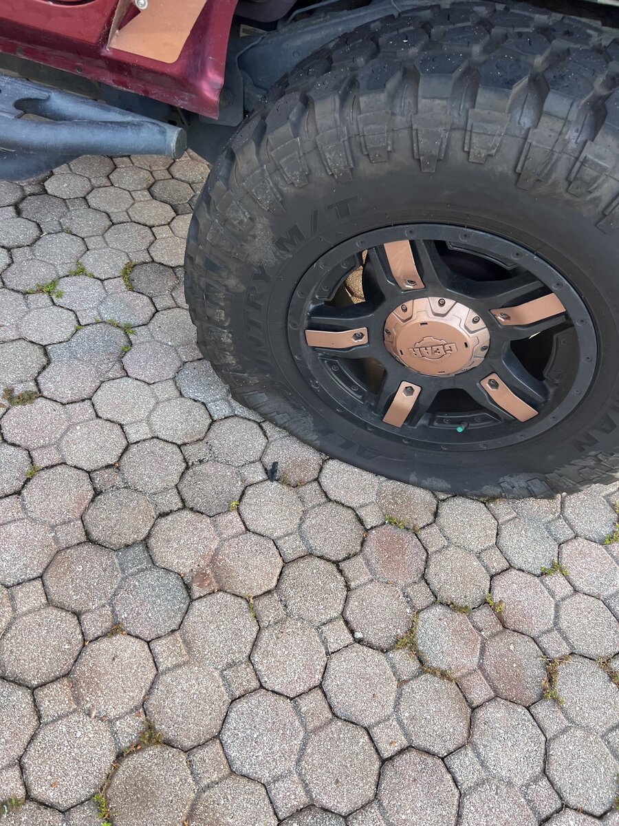

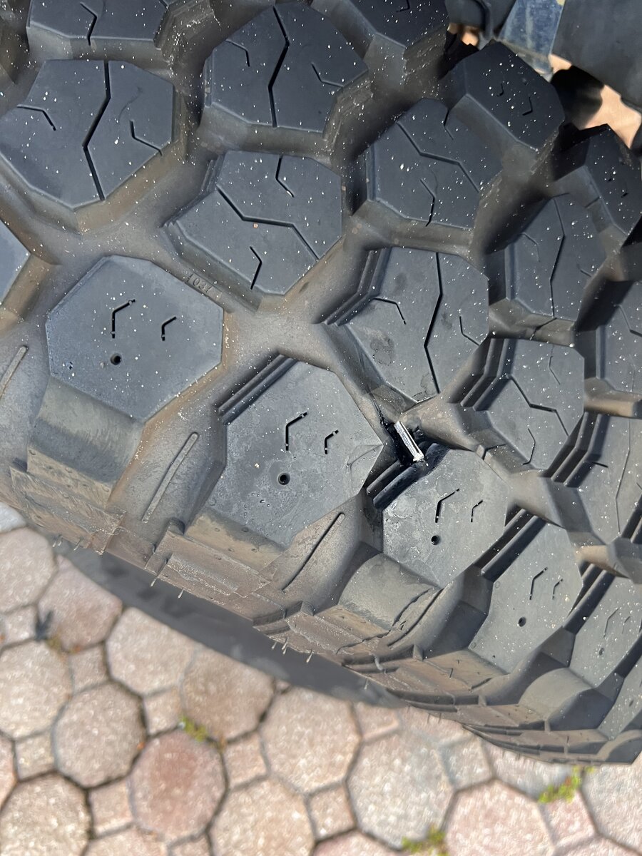

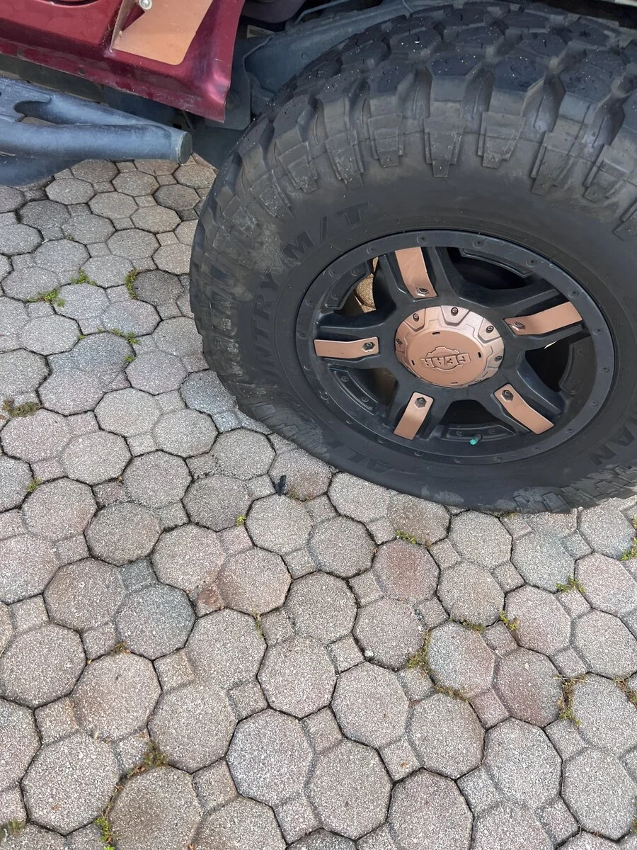

As you see the large piece of metal missed the lug but clearly flattened the tire. Do you think a patch will hold or just eat it and new tire?
Shop repaired a nearly new tire on my Charger with a very similar hole... they used a plug w/a patch on it like the one pictured.
It never gave me any issues, including several long road trips.
I was able to get the tire patched. So far it’s held. I was worried that it would be too large.

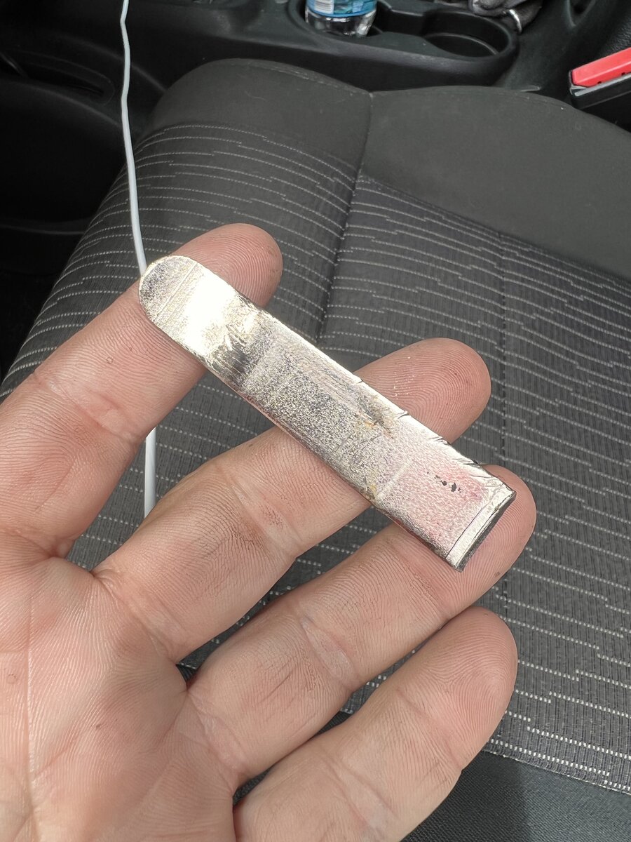

Here is a pic of the chunk of metal that was pulled out. It just happened to hit at the base, if it hit the knob it never would have punctured.
  • Wow
Reactions: mrjp and SteveF
My only concern would be if it caused any damage to the steel belts within the tire. If you start to hear a thump thump thump from that tire then it's game over
