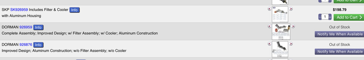

So now it's time to do it again and I want to get the dorman 926-876 upgraded aluminum engine oil filter housing but can't find it anywhere.
Does anyone have a link to a source where they are in stock.

Rock auto sells them. Out of stock, but they do sell them. You can check local auto stores.
