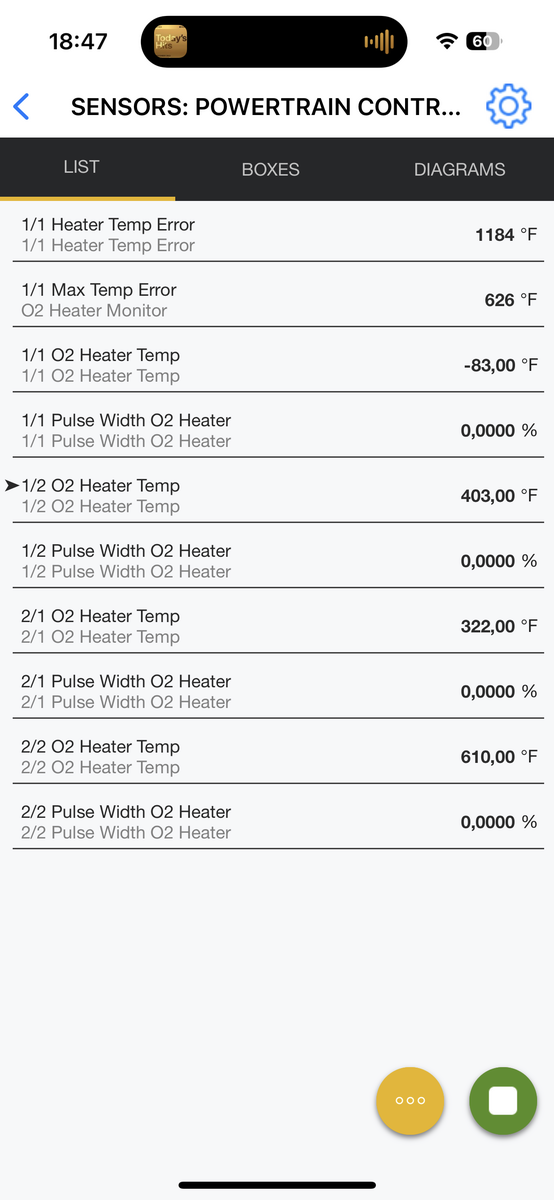

I found these variables using Jscan.

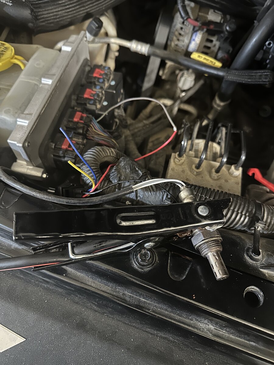

I tried to connect the sensor directly to the wire of the ECU, same issue!
It's crazy because if nothing is connected the ECU throws a header high error, but keeps showing a bad temperature.
