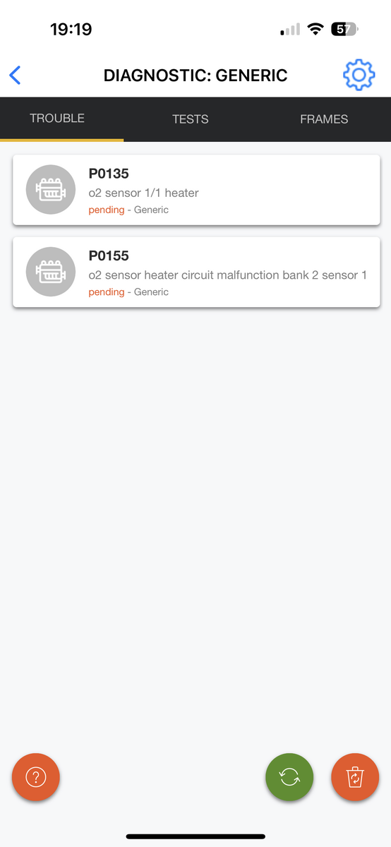

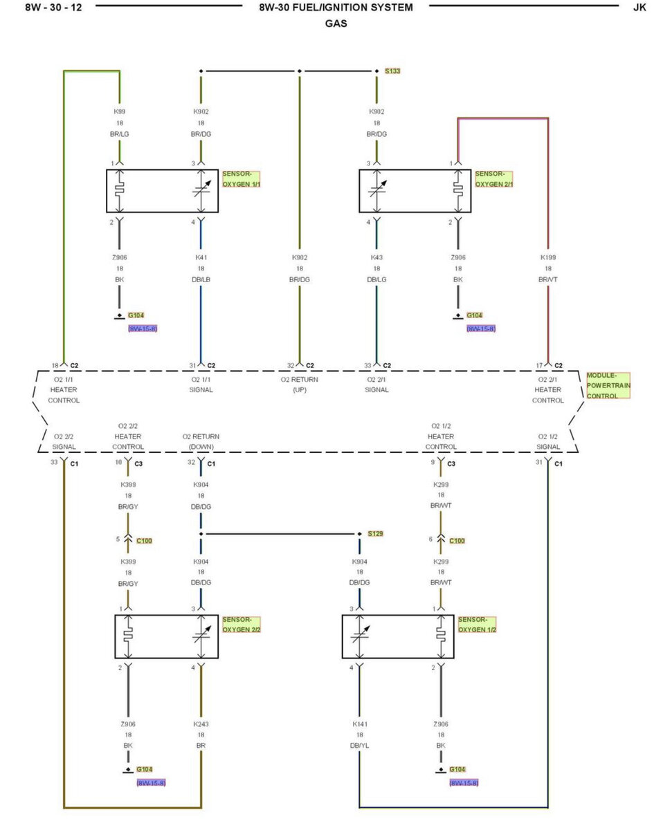

I'm trying to track down an O2 Sensors heater issue ( P0135 & P0155 ). I tried pretty much everything! The wiring is correct, same for the ground and new sensors. ( Walkers )
Anything I should look for ? This car is a project, I have no history about it. I already changed the PCM due to an injection issue; but it is the only idea I have ...
