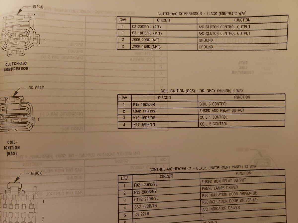

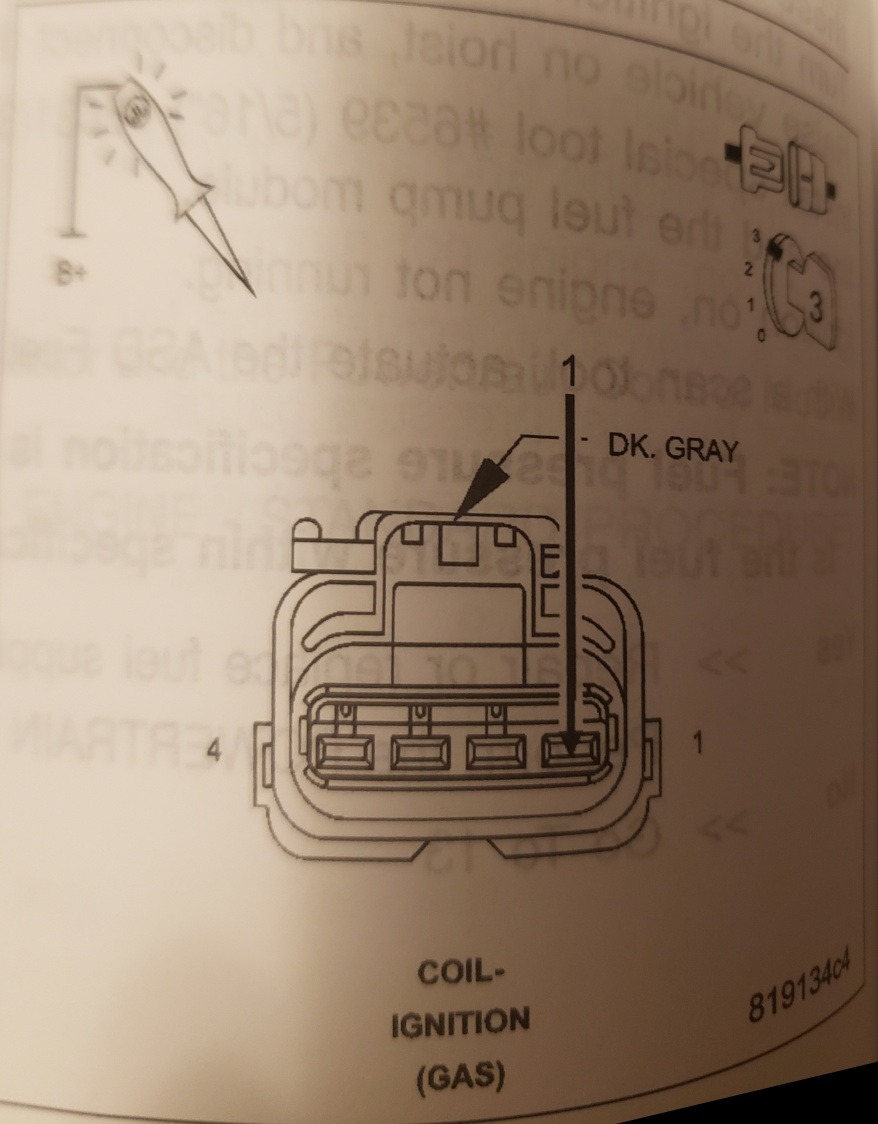

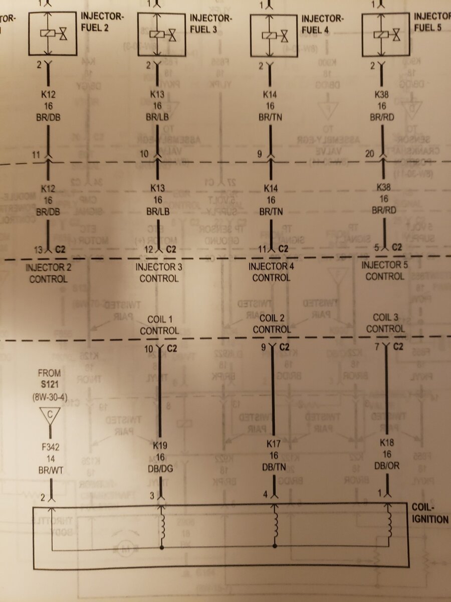

A p0303 is pin1 on the coil plug. I don't have a manual for an 07, but it's from an 08.
I'm not sure if this helps but here's the wiring for the coil pack/connectors.

Vman thanks for the diagrams. Your a God... in my previous posts I mentioned that the new coil worked for an hour or so then #3 went out again. Also I connected a plug directly to the coil terminal and no power..I used a piece of hose and grounded the plug. Checked on all other terminals with the same plug and they all fire. Tomorrow I'm going to trace some grounds and check thise and try to get another coil when the store opens hopefully Sunday. I'll post what happens. If I can't find anything off to the shop it goes unfortunately. Thanks again and merry Christmas to all

Manual uses a 12v test light to check that, not a dvm, for testing. Didn't see a voltage range.
Did you check the PCM side connecter C2? The pin is #7 from PCM to pin #1 on the coil connector.
Thank you again vman. I did not check pcm side because #6 has spark but I will tomorrow . Can't hurt at this point. Last ditch effort before it goes to the shop
