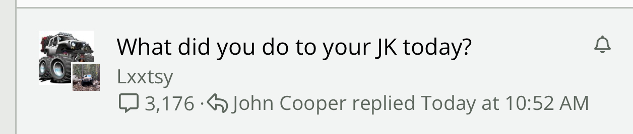

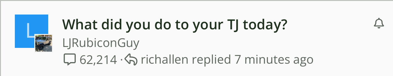

Not sure of the forums were established at the same time but for instance check out these two numbers. On the TJ forum I can’t keep up 😂
