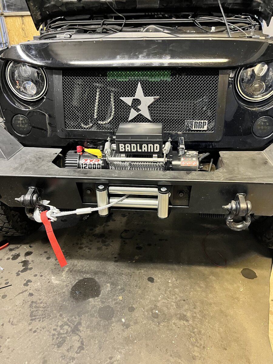

Just got 12k winch installed with the old school steel/wire rope.
Plan to leave it uncovered because i like the look of it.. is there any spray that’s recommended to keep the wire from rusting? I’m reading some say WD40, some say chain lube…
Can anyone with a wire winch rope, who leaves it uncovered give me some tips?
