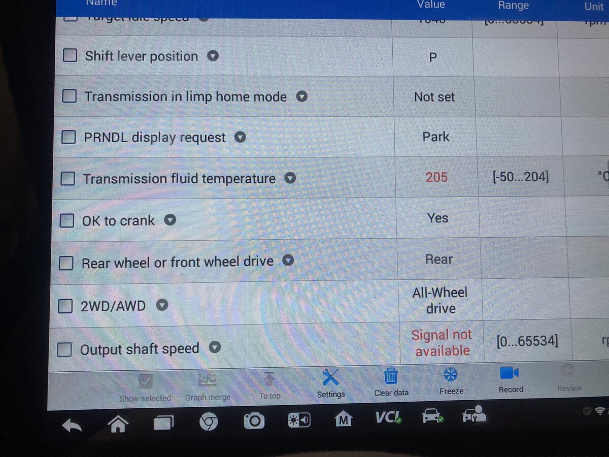

I had a front steering u joint go bad so while fixing it I decided to do all the fluid changes . Front and rear axle , transmission and transfer case. Found some metal chunks on the rear ended drain magnet so that was something to investigate. Well it was teeth of the small spider gears in the Dana 44. Replacement gears ,axle seals and bearings installed along with two new abs sensors. Why am I including all this … it just may help figure out my issue. Trans fluid changed . Those fluid vacuums are awesome. Less mess . New gasket and a Mopar trans filter installed correctly. Fluid at the correct level.
I go to move the JK. No movement when shifting in gear. I did relearn the new abs sensors . All codes cleared. My scanner is showing no communication with the output sensor. I’m using a higher end Autel scanner computer. Has anyone had this issue and could share the possible fix?
