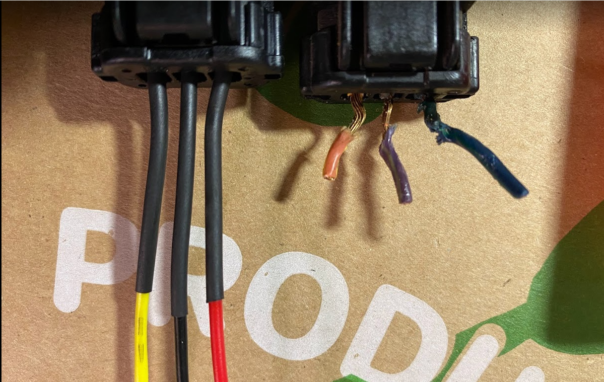

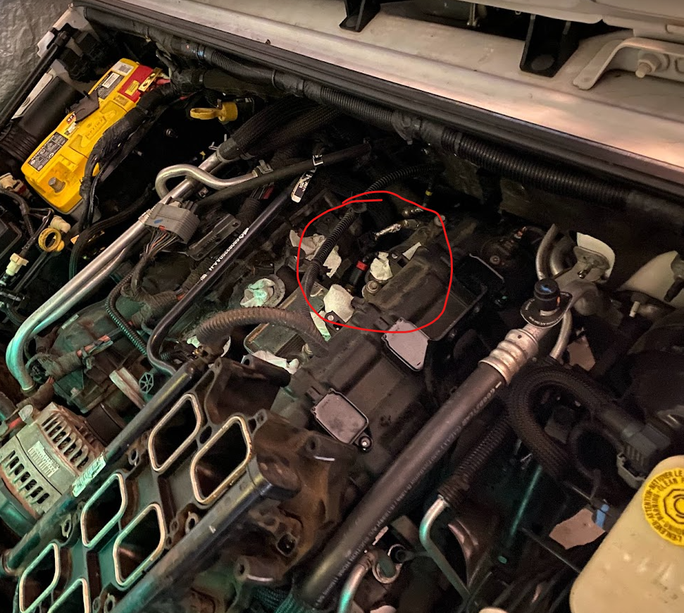

Did you repair the crumbling wire harness at the oil pressure sending unit yet?
The exposed conductors will randomly short against one another resulting in CEL, limp mode, and as many codes as you can count.
