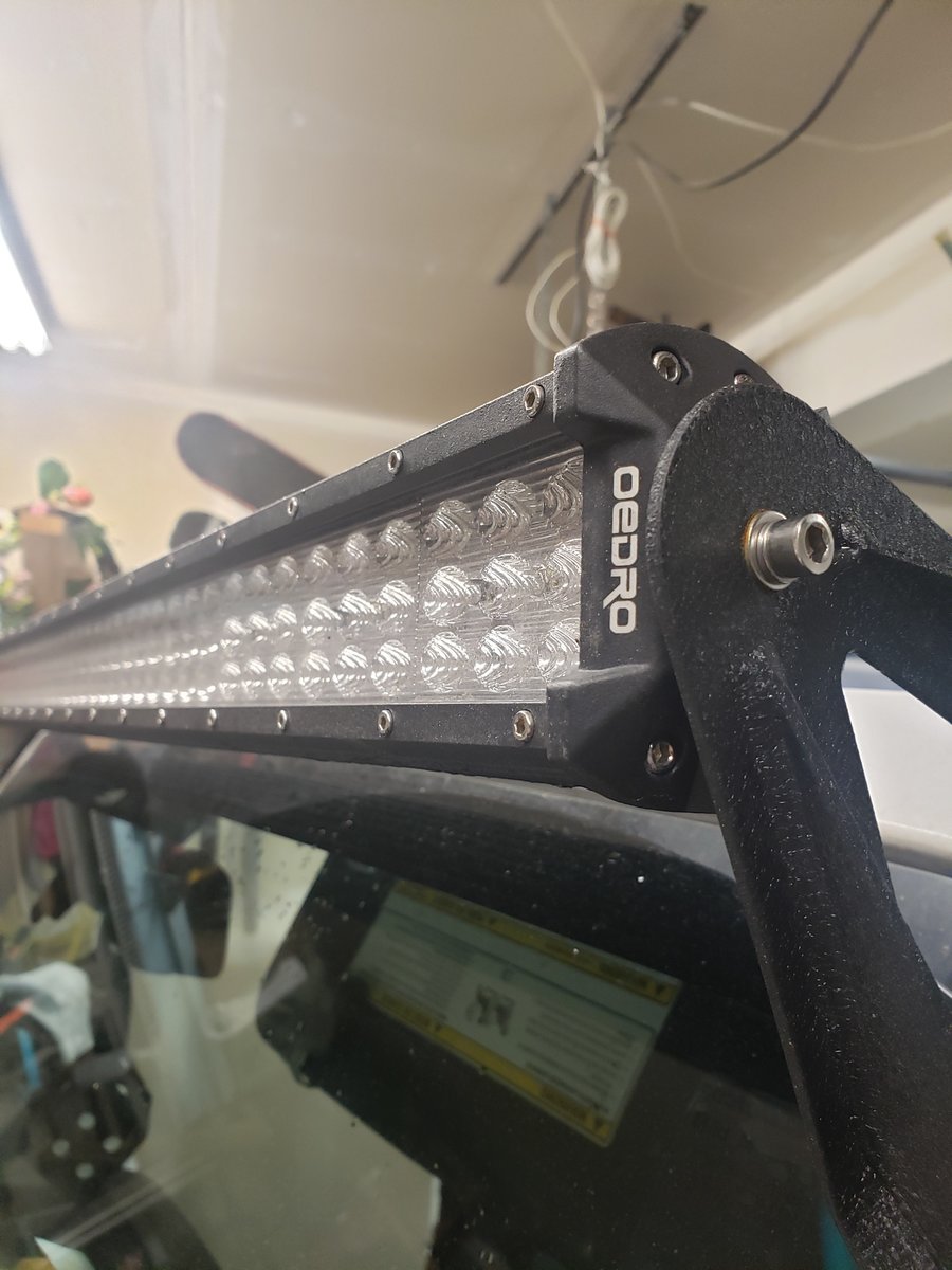

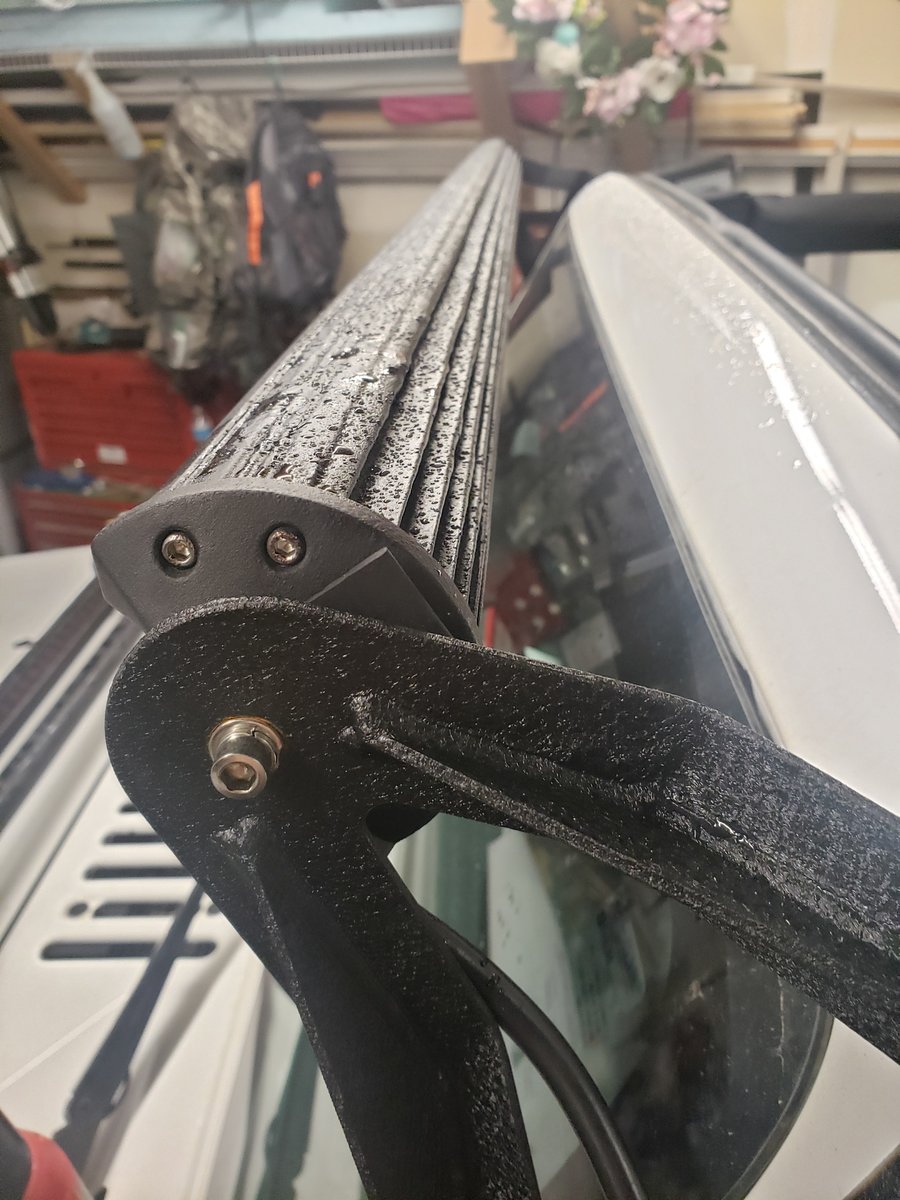

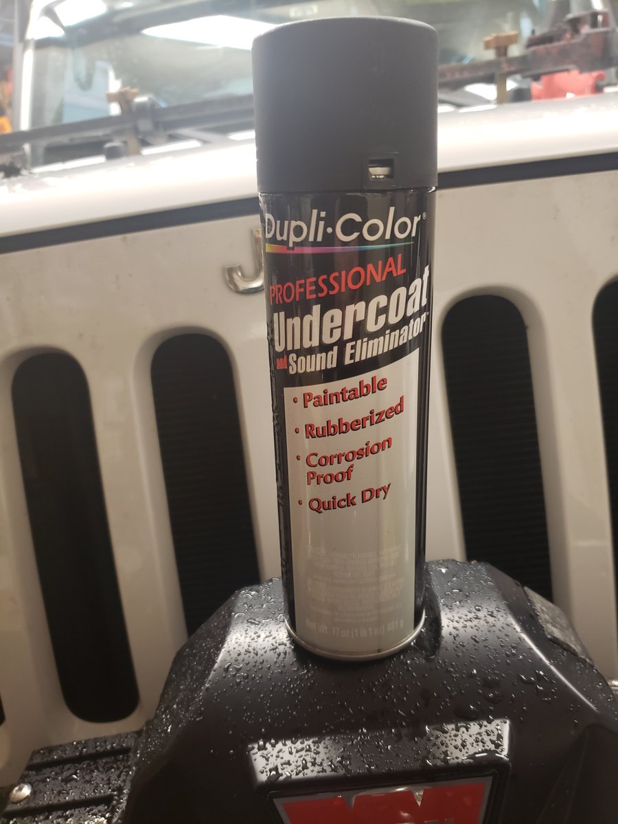

Thanks for the advice. I'm going to try spraying the fins with rubberized undercoating. That should stick better than tape.

Stay tuned. I sprayed it today just haven't drove down the road yet. I'll definitely reply with the outcome.
Okay, 99.9% gone! It's a success. Best $5.00 fix.

I just sprayed another thick coat today. Gonna let it cure over night and test again tomorrow. For the most part my 1st attempt ended in 99.9% whistle gone. Depending on my speed it comes back very little but I want it all the way gone. We'll see tomorrow.
