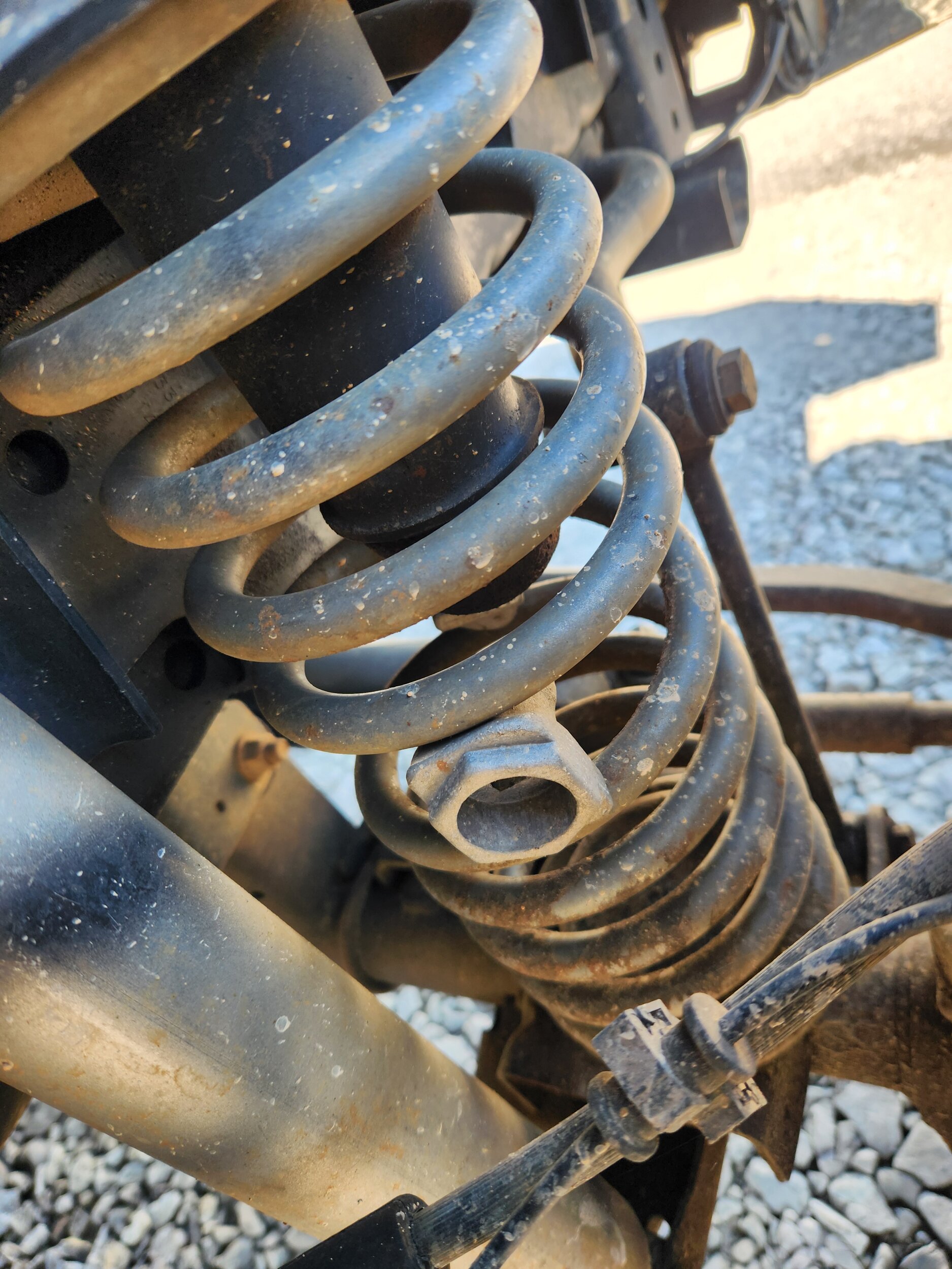

1o1Proof Member Joined Jul 2, 2022 Messages 70 Location TN Mar 20, 2024 #1 I was walking by a jeep in a parking lot and seen this, I assume it is a cheap way to level the front? Does not look like a good idea at all to me. There was one on each side of the spring, so 4 total on the front. Reactions: tJKrider
BLACKJKU Moderator Staff Member Lifetime Supporting Member Joined Feb 22, 2020 Messages 4,865 Location Huntington In Mar 20, 2024 #2 I wouldn't do it, those wedges will move and eventually they will both be next to each other. The proper front leveling kit is something that sits on the top of the spring. Reactions: 1o1Proof, Danarch, BigAL07 and 1 other person
Danarch JK Addict Supporting Member Lifetime Supporting Member Joined Mar 9, 2021 Messages 1,205 Location Orangevale, CA Mar 20, 2024 #3 That is insanity in my opinion. Reactions: 1o1Proof and BLACKJKU
