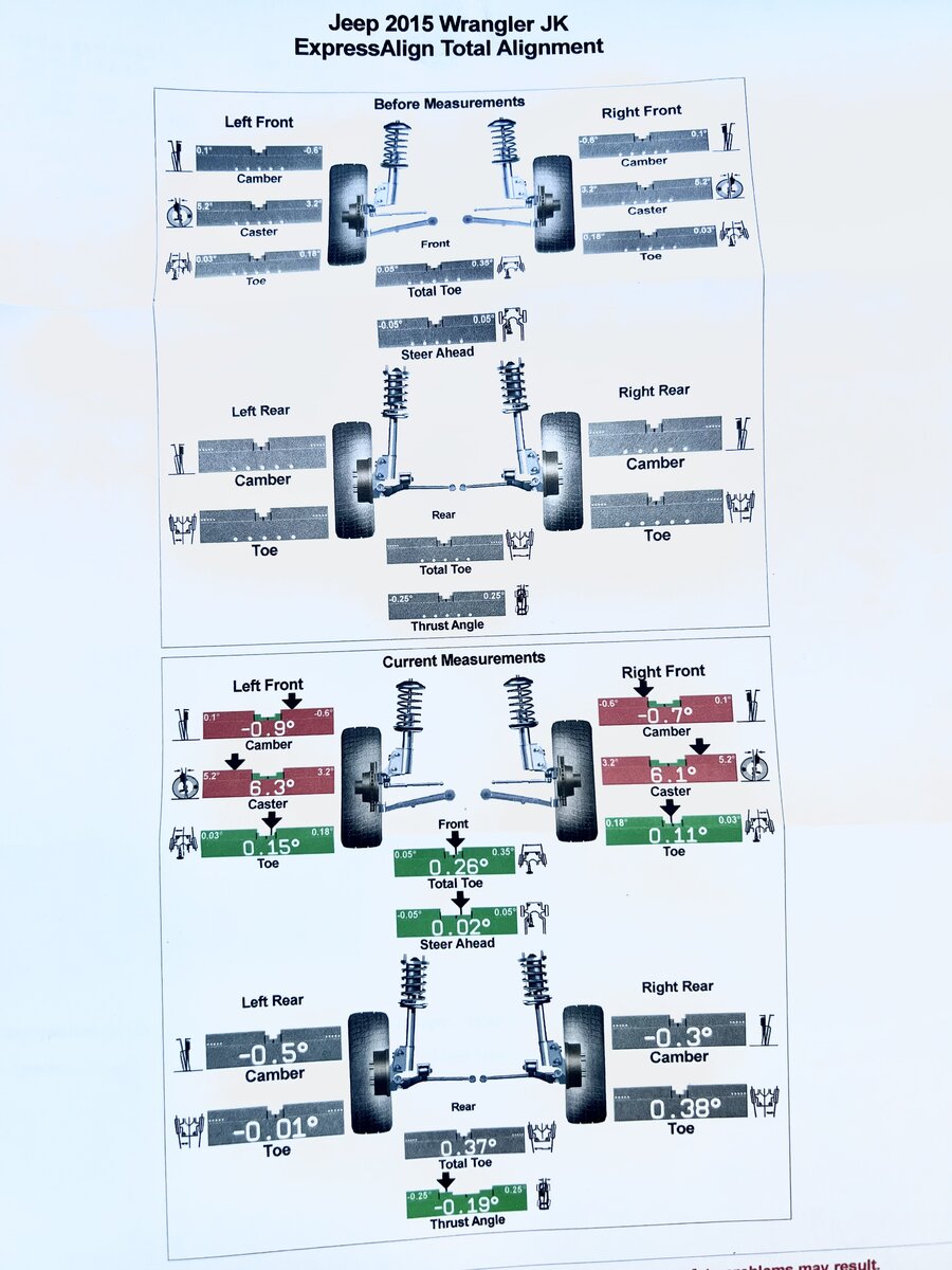

Hi all, thanks in advance for any help.
- 2015 Rubicon w 4" RC lift & 35 Nitto Trail Grapplers
- alignment done (toe only as no adjustable CAs), brake lines replaced, front driver side caliper replaced, tires rotated & inflated the same per manual gauge, non-charged steering stabilizer installed
Since I bought this 2 months ago it pulls left at all speeds despite the wheel being straight. I bought it assuming an alignment would fix it.
Nothing I've done has made a difference with one exception: since replacing the front DS caliper & bleeding it last night, it now pulls slightly RIGHT when braking (but still pulls left when driving).
No noise indicating a bearing going out. Front DS and PS tire seem to spin one as easily as the other when Jeep is raised.
I note that on forums, MANY people complain that Nitto Trail Grapplers cause a leftward pull and that the pull went away once they got different tires (I can't afford trying this). Hundreds of other claim it is impossible, or that they had the same tires with no issue.
Thoughts on next steps?
Alignment report I was given by NTB.

Yup, 4” lift could be other issues causing the pull, probably the control arms. If you don’t have adjustable control arms they need to be added and then adjust the caster. Larger aggressive tires do need the air pressure adjusted as @BLACKJKU stated above. The recommend tire pressure is based on a completely different tire size and tread design.

So you have a 4" RC lift without adjustable control arms.
That would be exactly where I focus. Our 08 JK, 2.5" lift....drove like garbage. Got upper double adjustable from core4x4, and changed the Caster. Massive fix. BFG 35" muds, and that size tire will pull and drift drive a lot. If we were at 4", I would get upper and lower adjustable, but the lower I haven't seen double adjustable.
