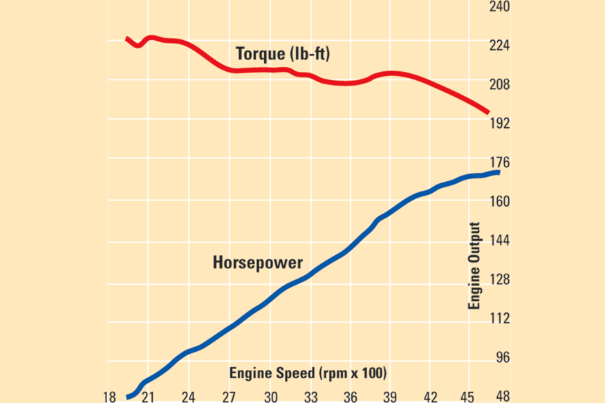

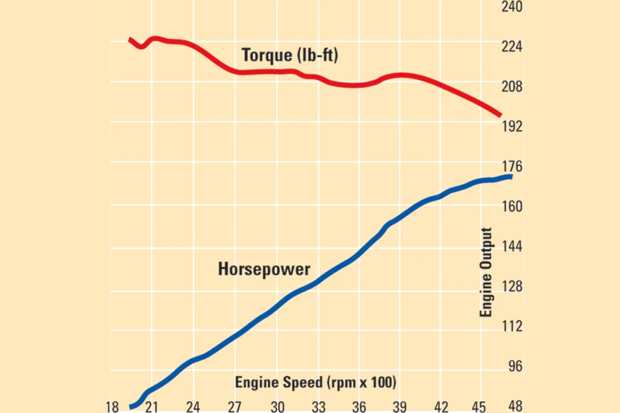

I stole the 4.0L dyno numbers from Motortrend. It had a CAI, header, and exhaust, so it's a tiny bit higher than stock.
So you're considering a nightmare swap for a net loss in usable power.

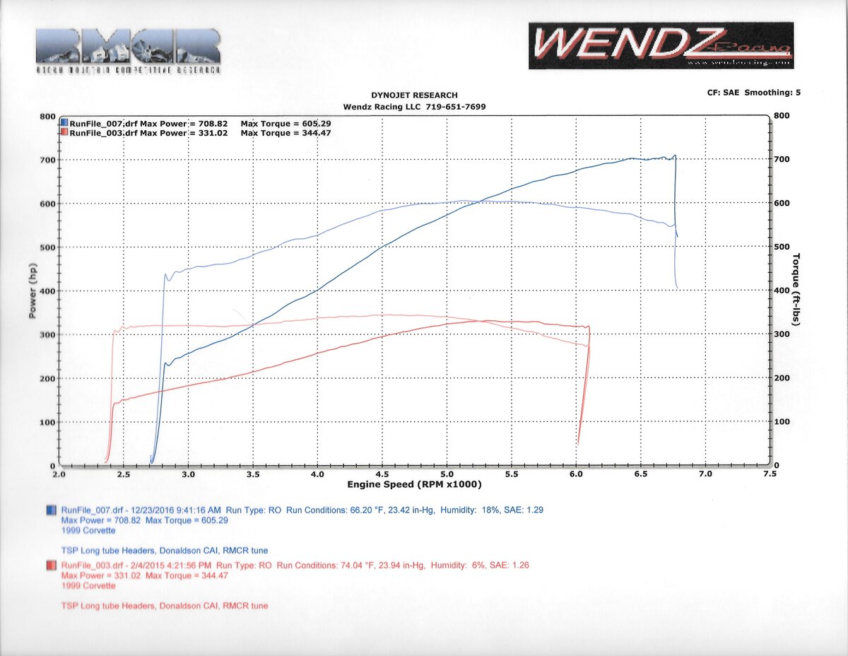

This is the dyno sheet from my Vette. The lower numbers are a basically stock LS1 with a CAI, long tube headers, high flow cats, and a Magnaflow exhaust.
The top numbers are from the Heads/Cam/Blower LS3 that was swapped in. That engine is currently out. We're install a forged crank, billet rods, and forged pistons. Lowering the static CR from 10.7:1 to 10:1 so we can run a bit more boost and timing.
A stock LS1 would give you a torque curve that is nearly as flat as a table, with over 300lb/ft @ 2400 RPM.
