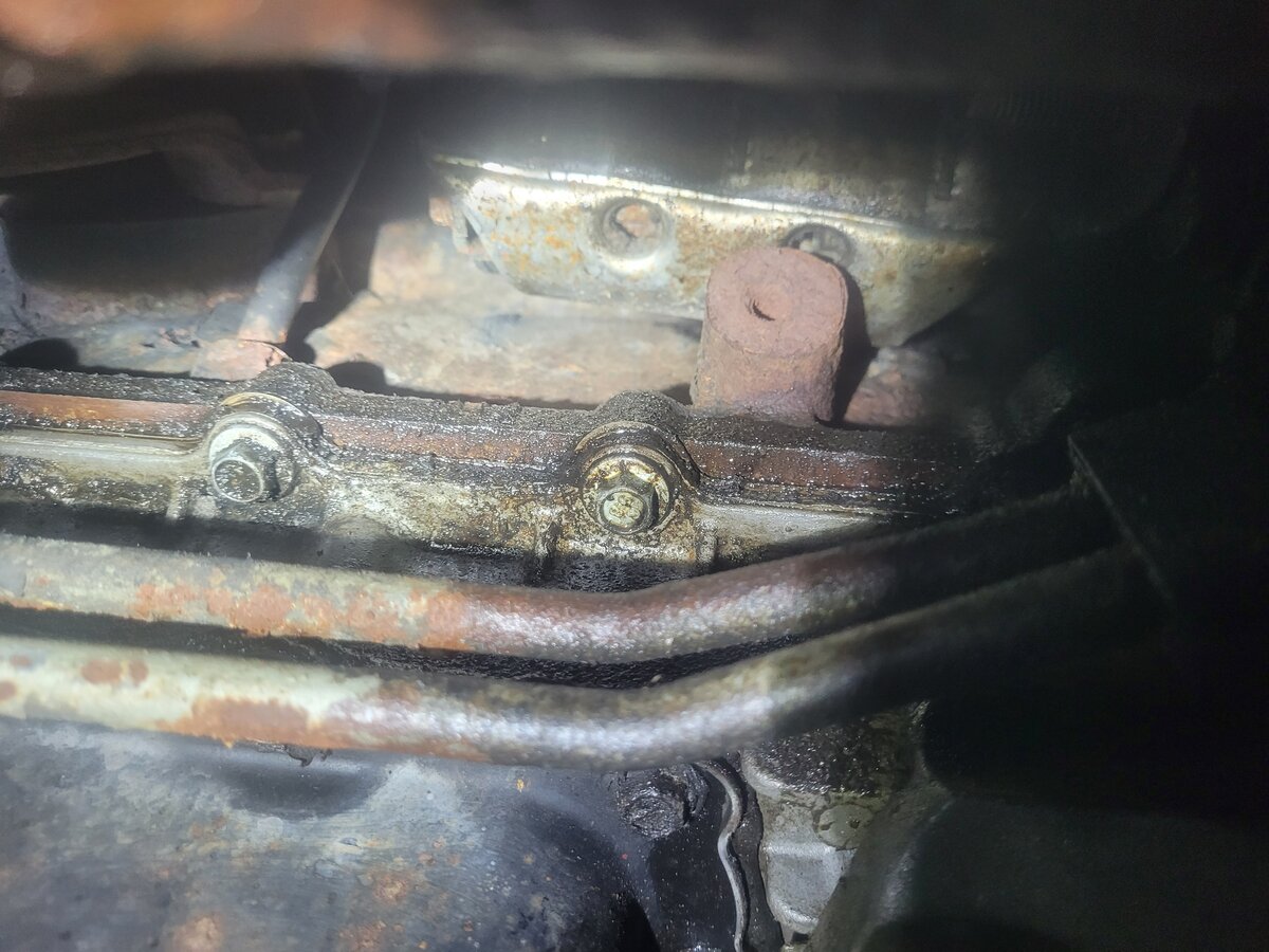

Hey everyone! First post! let me introduce my jeep. Shes a 2008 wrangler sahara. Been keeping her going and hope to do so for a little while longer.
Was wondering if people would be so kind to help out here. I have a leak coming from the seam where you can see some drips forming. Is this a transmission fluid leak? I just did some fixes on my jeep and I'm guessing this might be the next one I'll need to address. Any help will be appreciated!

I'm looking at a leak in the near exact same spot. Mine is looking like a failed upper oil pan seal.
Sounds much easier than the Rear Main seal. If you can, remove the dust shield and get it all cleaned up to verify which seal gave way.

its like we're on the same wave length! I thought it was now the upper pan seal too! Im gonna wipe her down really good before driving tomorrow and see what happens and if the leak comes from there. She's definitely right now got a lot of oil around that area, so fingers crossed. Will post more pictures tomorrow
Easy way to find out is to check the fluid. Transmission fluid doesn't really look like oil.
But I'd bet on a rear main seal going bad.

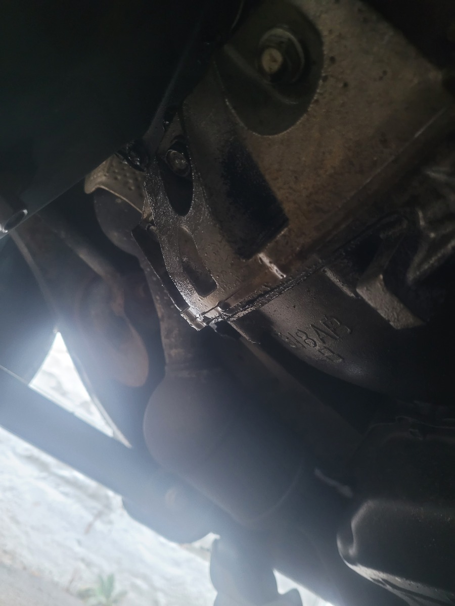

This is my upper oil pan gasket area. When I just wiped the areas around it I could see it would re saturate. In other words I would wipe away the oil and it would just appear again. I will replace this first and see what happens. What do you think?
Can't see too much but it looks like your on track. Not wet spots above and a wet sealing surface = leak. I don't be believe there is a path for oil to get from the Rear Main seal that far forward, well unless its dumping several ounces of fluid a day and your driving in reverse.
