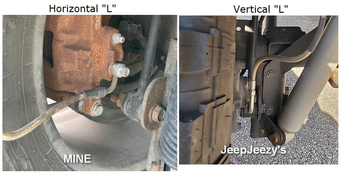

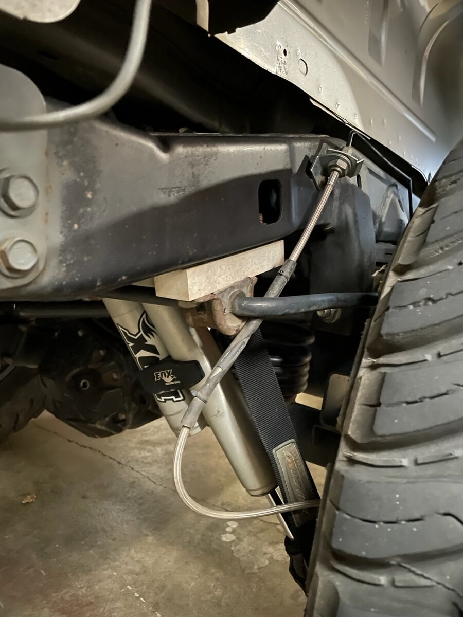

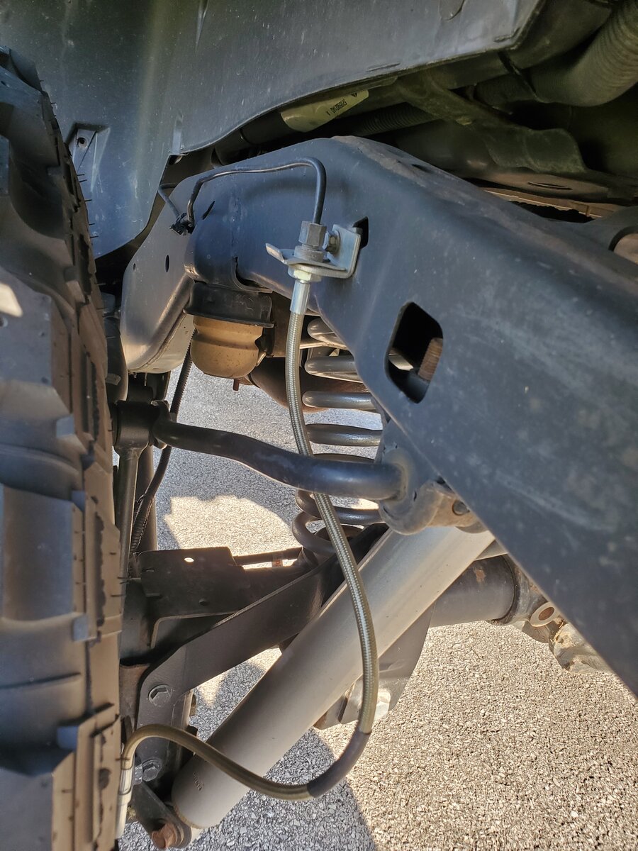

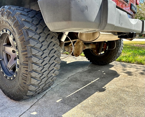

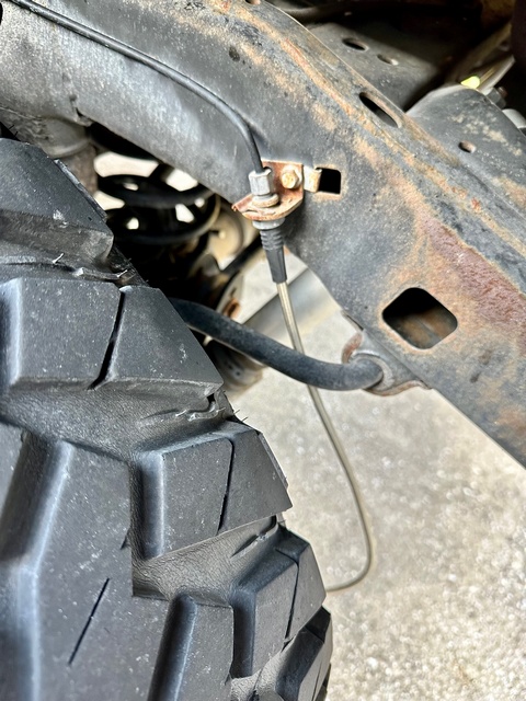

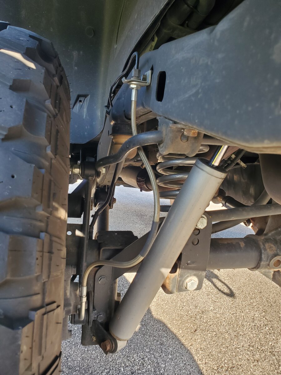

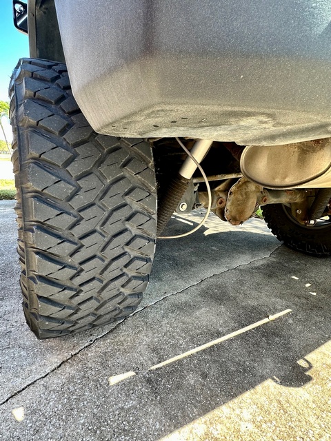

They need to get fixed / secured.   Hard to tell from the pictures but it appears the Jeep is lifted so longer lines may be needed, but not just floating light that.  They can be secured in different spots which allow them to extend when needed, but stay out of harms way.   But in general they look a little too long overall, but hard to tell.
