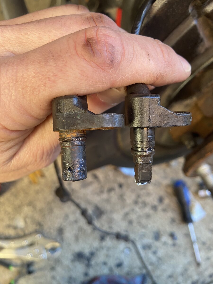

As luck would have it, I installed Teraflex brake like / ABS extenders and, of course, the driver side wheel sensor fails. Figured easy job. Picked one up at Napa but it doesn't fit! every single aftermarket one that I looked at, including the Mopar, looks different than the one in my jeep. So I'm left with only one option: replace the wheel hub.🤬 Unless, of course someone can identify or give me an idea what brand this speed sensor might be? Any help or comments appreciated.
2013 Sahara 4 door - for sure the current hub is an aftermarket that came with what may be a proprietary sensor. FML
Left, is the one I need. Right, is the OE that doesn't fit:

Thank you, @BLACKJKU It doesn't appear to be that one. It's literally a shorter cylindrical shape, rather than the more common tip
I appreciate you sharing a link though! 🤘 Im thinking it'll be time to replace the hubs. Its literally always something, but I created this mess trying to do a simple 'improvement'. LIFE OF JRKOFF lol
Is there a number or anything stamped on the one you need/pulled out?

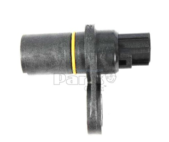

It looks like an older model (pre-2008) speed sensor. Here's a pic of a 2005 Wrangler transaxle speed sensor I found:

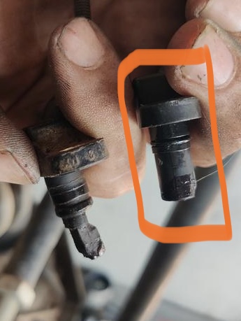

FOUND IT. Totally random discovery after going to Auto Zone to see what they had in stock. of course they didn't have anything but their own house brand. The gentleman at the store proceeded to tell me it's actually a Moog bearing rebranded under their house name. That's when I went online to look up the reviews and and I saw the photo (below) that a customer posted:
Discovering this, Im happy to replace the bearing knowing its a DURALAST and that the sensor is proprietary. To me, the change of bearing will be an upgrade.
Going either SKF or Moog (both made in Korea) or a SPICER, which happens to be a very affordable option and (allegedly) US made. To be honest, I've had great results with Korean manufactured Moog front end parts on my TJ so Im not too concerned. But of course, only time will tell.
