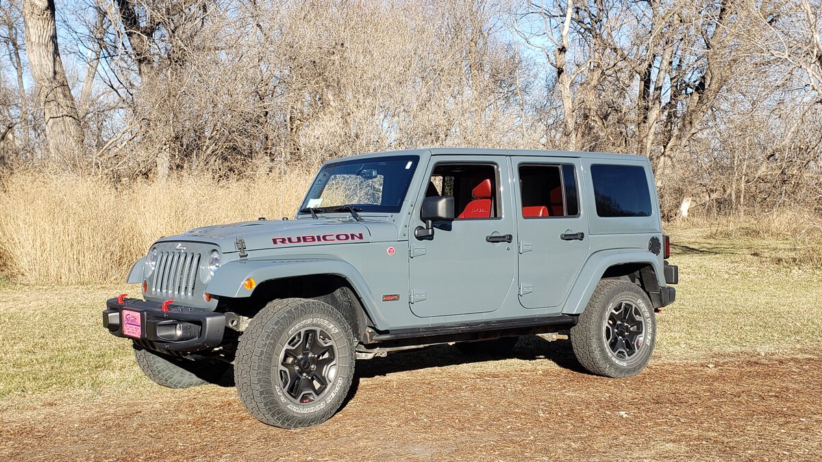

I guess I've joined the JK owners club. Introducing my Anvil JK.
Fargo
Member
Jan 20, 2021
57
Fargo, ND
For the past 3-4 years I've been dreaming of a new JL. Since the first spy shots started to hit the internet I was sure that was my next Jeep. I never really liked the JK. I always thought they were ugly and things like the fenders and grill in particular just didn't look right. The JL fixed all the aesthetic problems of the JK and then made the suspension and drivetrain even better. I was sold on the JL. Several months ago I was finding JLURs for just under $40,000 and I was sure within a year I would be able to pick one up for under $40k with all the features I wanted. Then the chip shortage and consequences of the Covid lock downs hit the market. Suddenly that Jeep that was $40,000 was now listing for $46,000+. Things suddenly got too rich for me since I was really hoping to be closer to $35,000. Then a couple weeks ago along came this 2013 10th Anniversary JK with 60k miles for $36,000. Suddenly I found myself very intersted in a JK. Shortly after making a telephone offer under $35k I found myself driving to the dealership to pickup a new JK. I still prefer the JL with the 8 speed auto and the ability to run 35s with no lift, but I think a 3.5" lift and 35s will dress up this JK nicely.
The plan is AEV 3.5 lift with 35" tires. I'm currently undecided between the AEV tire carrier and the Teraflex carrier. I'm also undecided between black or Onyx Pintlers or saving a little cash and getting the Quadratec Morphic wheels. Let me know your thoughts and opinions on wheels and tire carrers or any comments in general on my new Jeep. Did I do OK or will I regret not waiting for a JL?
Oh... for those who recognize my name from the TJ site. I still have my 2005 LJ Rubihara. I'll be keeping that Jeep a long time.

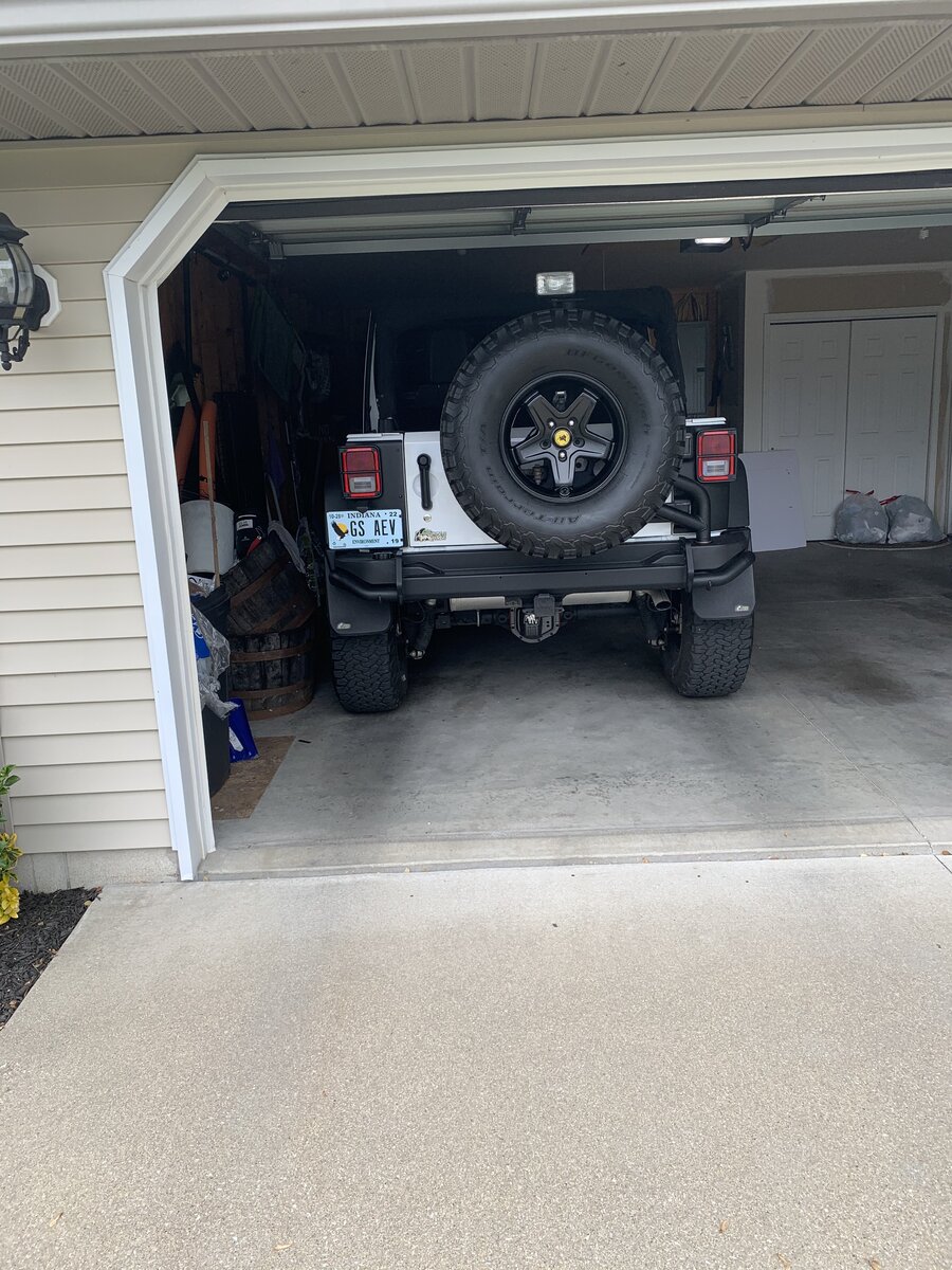

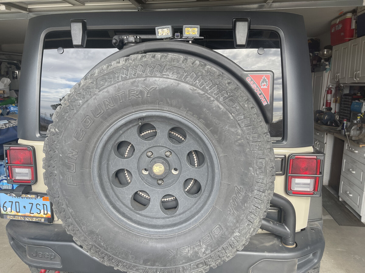

Looks good (y) I have the AEV spare tire carrier with the spare fuel tank. Works great. If you go that route Install a camera for the rearview Mirror. 35 tire and the fuel cell pretty much covers the rear window.
Thanks for the input and photo. I was looking into installing a camera and connecting it to the factor 430n radio. I think the Teraflex carrier keeps the tire a little lower and its one advantage of that carrier. But I really like how the AEV is tied into the frame and not the body.

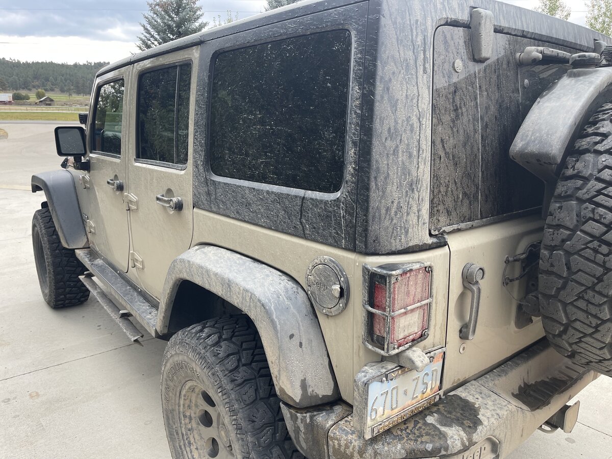

I purchased my JKU with the Teraflex carrier and I have 35x12.5 and I've had a couple issued with the carrier, which I detailed in a thread:
https://wranglerjkforum.net/threads/tire-carrier-info.28604/#post-436181

I have a friend with 10A and he added the AEV carrier and fuel tank. I like the design/operation and it seems to hold/carry the weight very well. But as mentioned, your rear view is pretty much non-existent.

The biggest drawback of the AEV that keeps me looking at the Teraflex is the the obstructed view. The second thing I like about the Teraflex is their is a mounting bracket specifically for Maxxtrax. The AEV offers a bracket for things like the high lift, but I have no interest in carrying a highlift. But I do intend to mount a set of Maxxtrax. So for those two reasons I prefer the Teraflex, but the AEV is sounding like the more durable option.
My back up camera is below the spare tire in the bumper. The camera between the lights is for my rearview mirror. You can see the back up camera in this pic

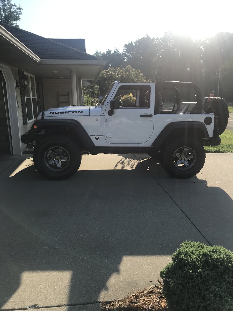

4.5” and 37s. I’m debating on dropping to the 3.5” coils, but I’m putting Nittos on beginning of next year and they are an inch bigger than BFGs so I’ll probably keep what I have. Just telling you from experience with AEV parts…2.5” is al you will need/want with a 35” tire
