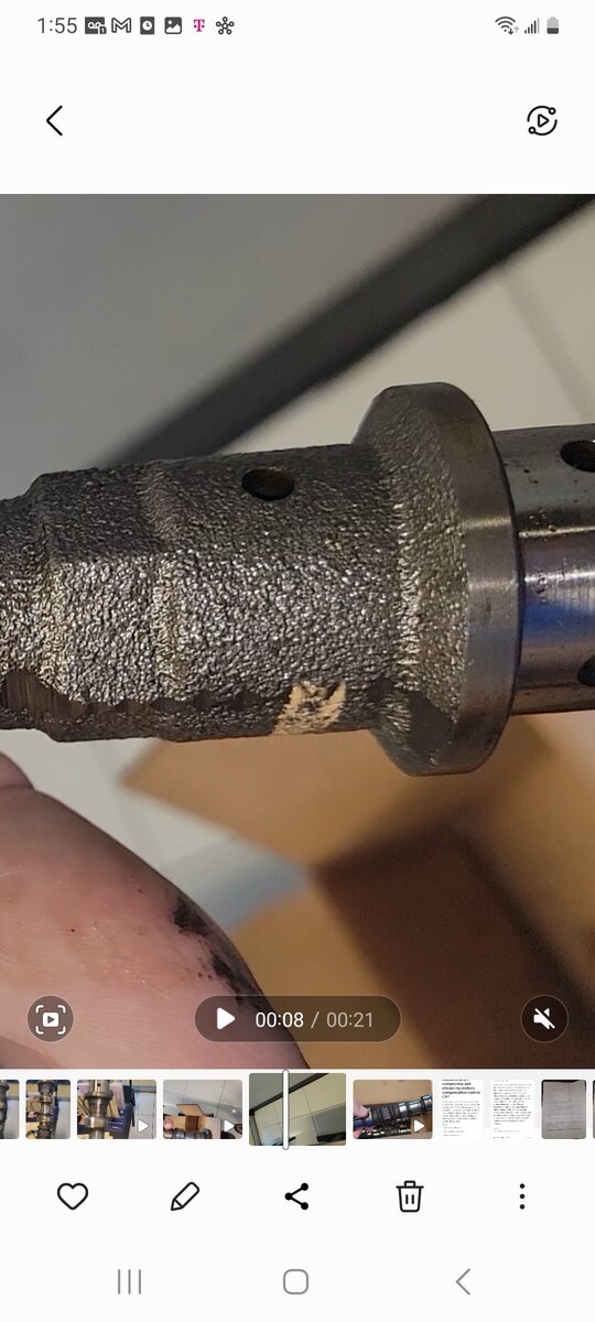

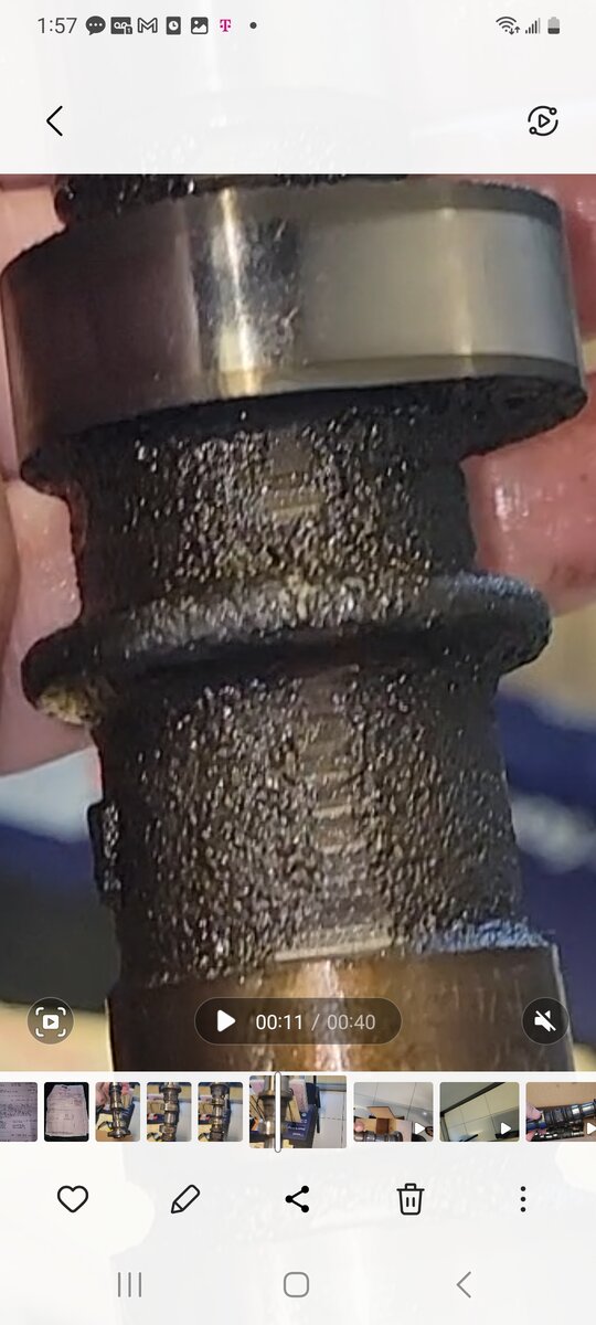

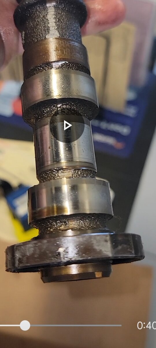

Hi jeepers ! I just got the dreaded pentastar tick 3.6 on 2015 jku I took it to the dealership under warranty and they replaced all the cams,lifters,rocker arms and rear main seal. I took pictures of the cams and they were grounded down excessively in my eyes. I'm trying to get jeep to replace the engine. Anybody deal with this ?
You're trying to determine if the cam was ground excessively by eye? That's cute.
The answer is simple. Put a mic on it. If it's within spec, then it's within spec. If not, then it's not.
I would be amazed if you convinced them to replace the entire engine.
