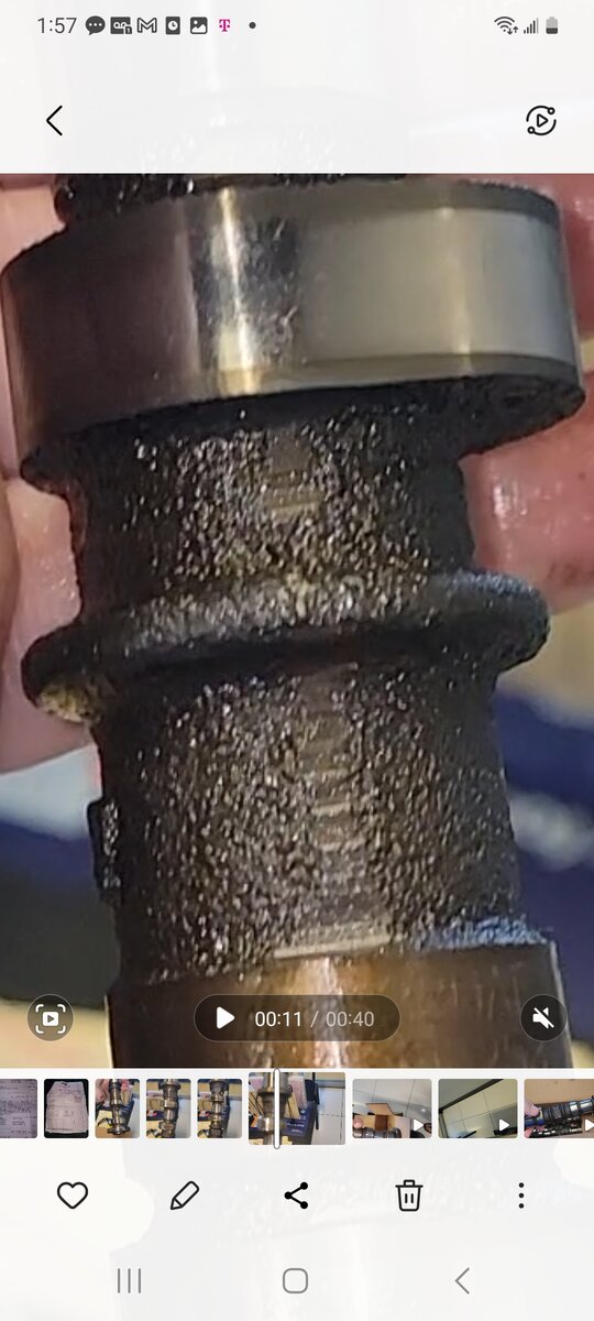

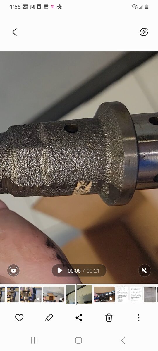

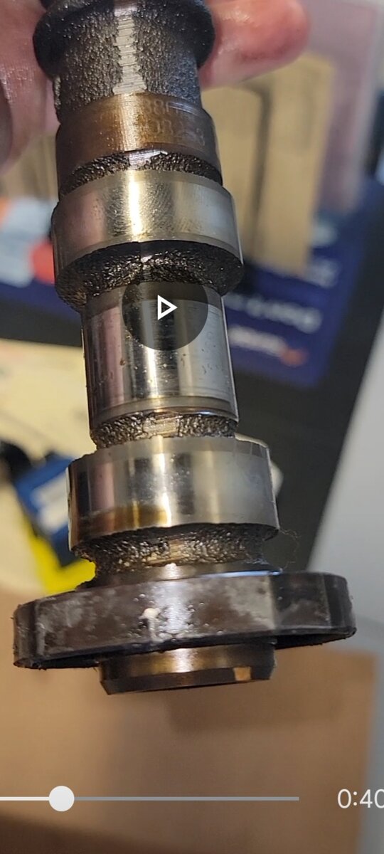

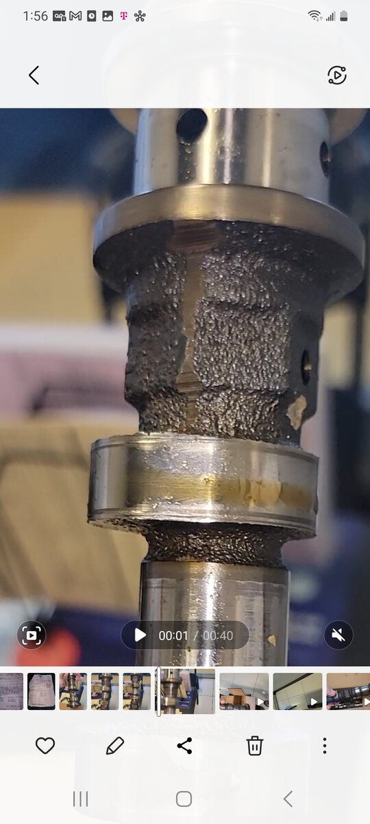

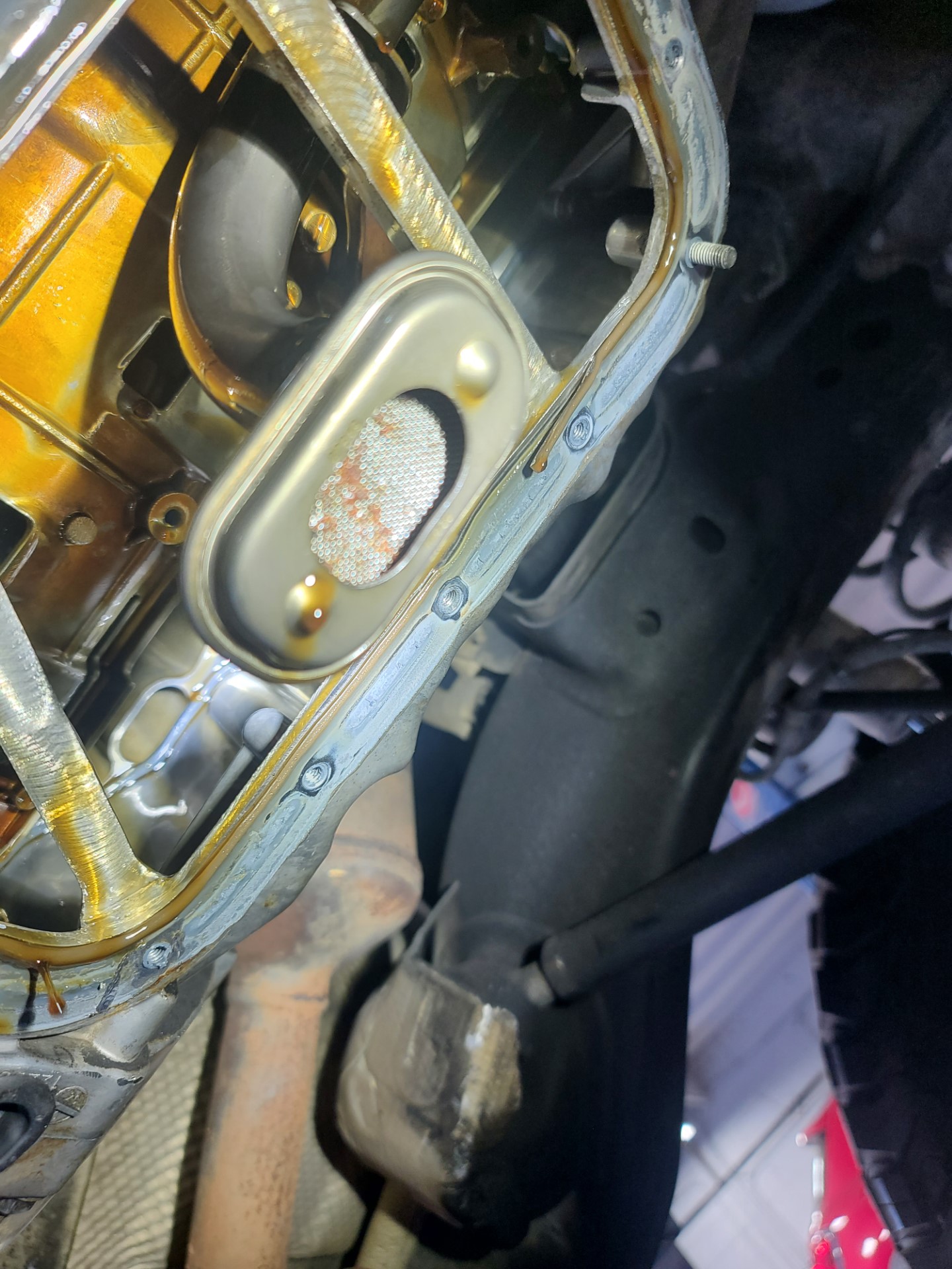

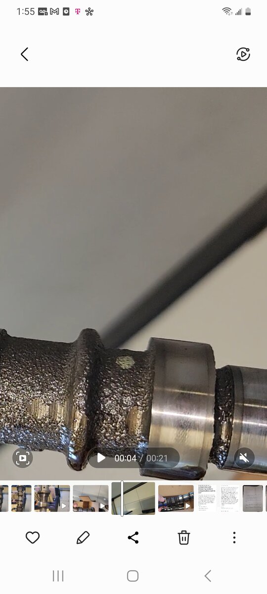

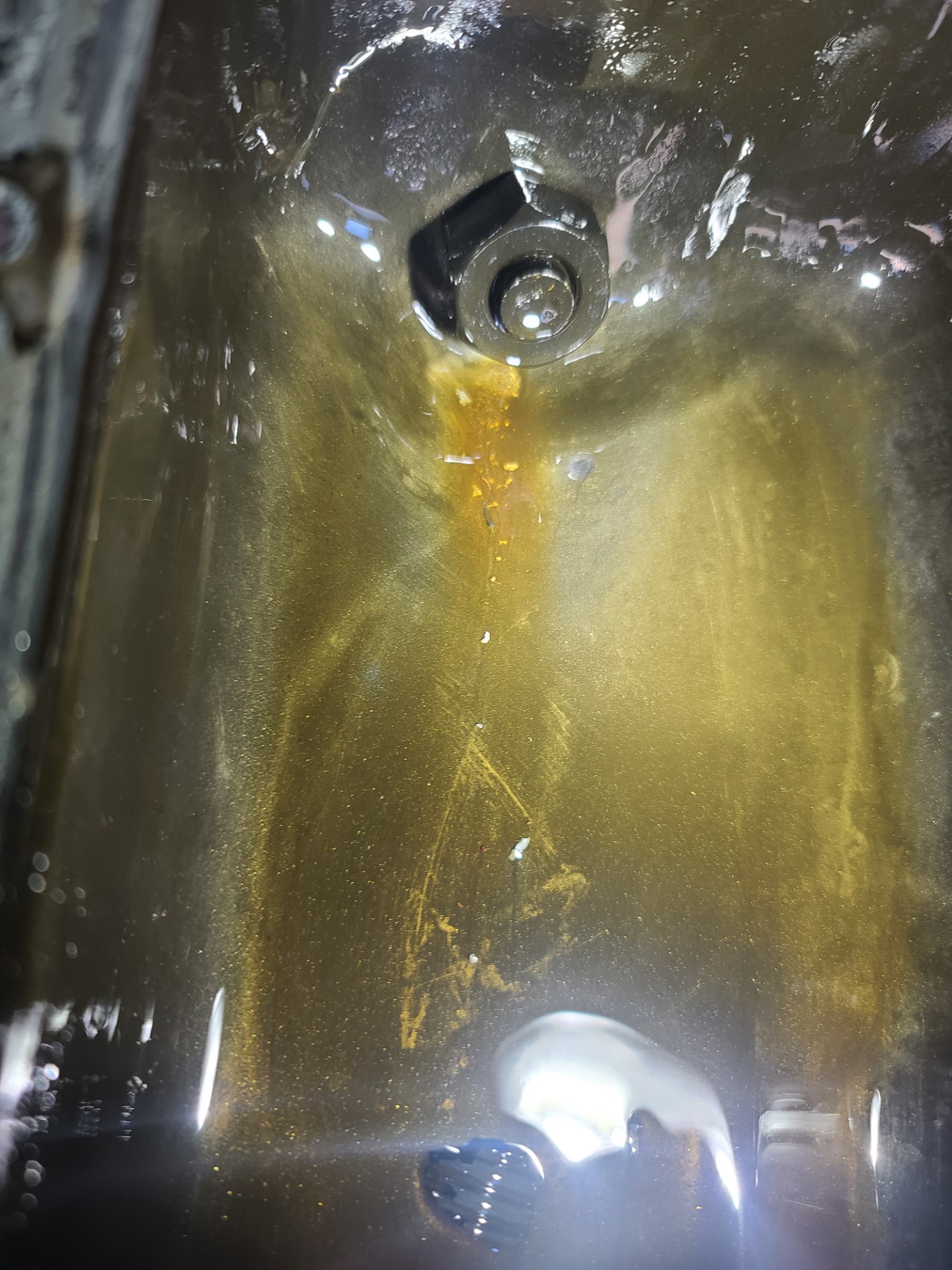

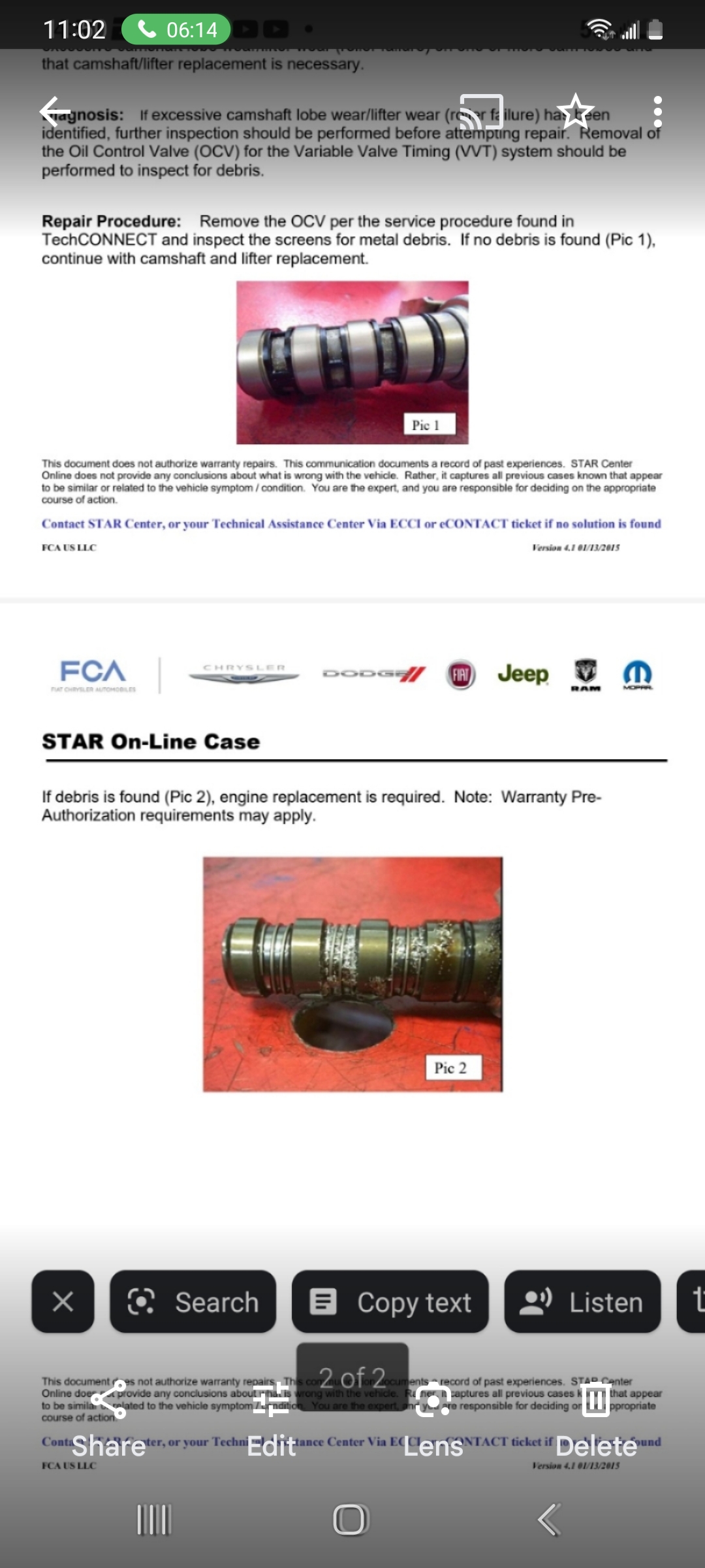

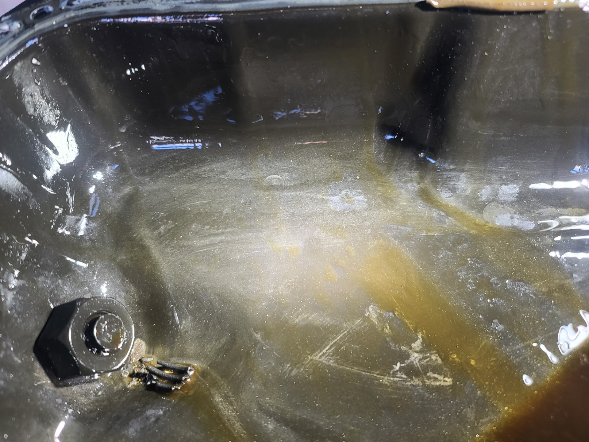

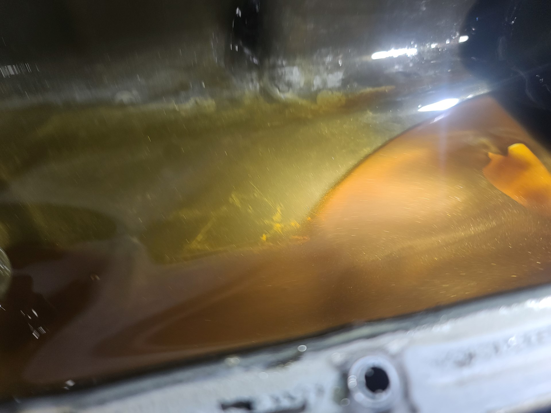

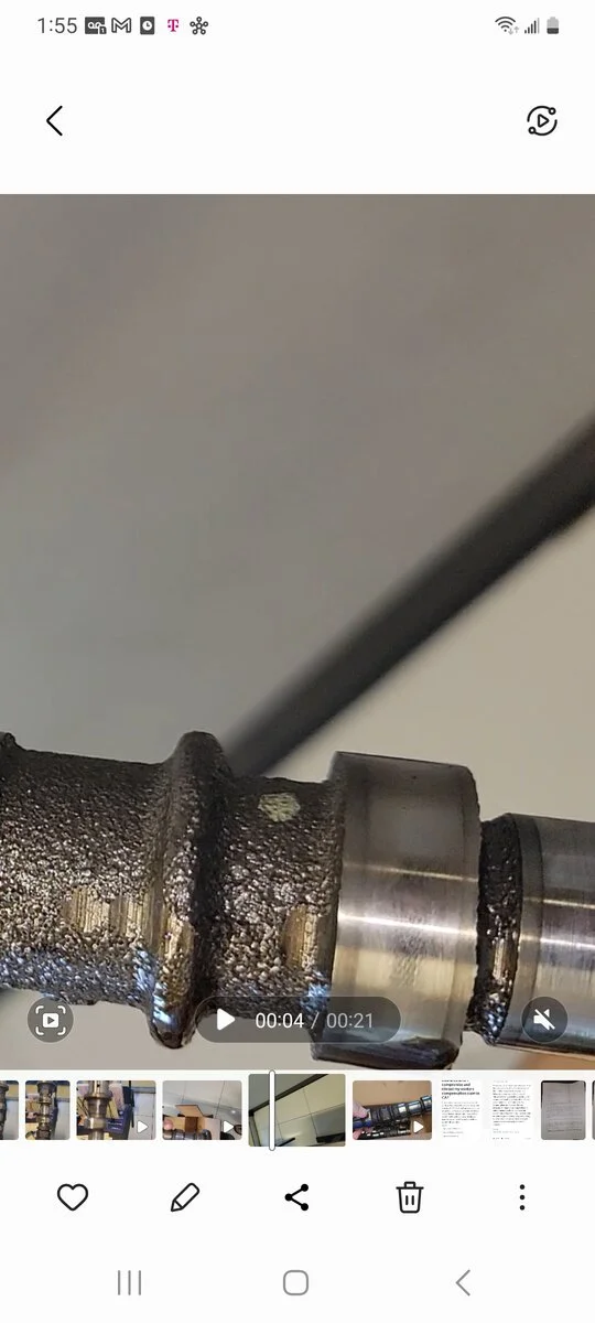

Hi jeepers ! I just got the dreaded pentastar tick 3.6 on 2015 jku I took it to the dealership under warranty and they replaced all the cams,lifters,rocker arms and rear main seal. I took pictures of the cams and they were grounded down excessively in my eyes. I'm trying to get jeep to replace the engine. Anybody deal with this ?
