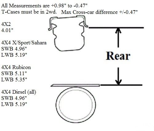

How do I determine how much lift my Jeep Wrangler JK has?
