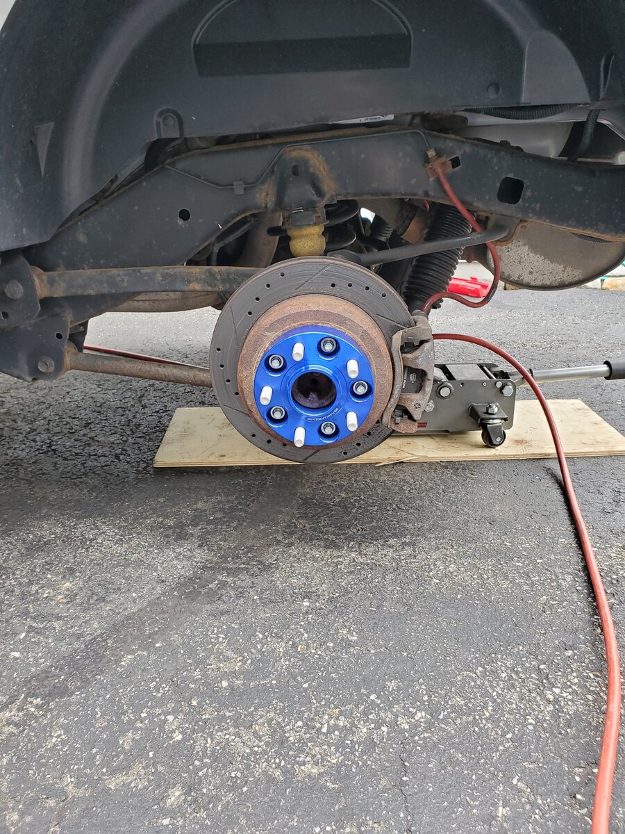

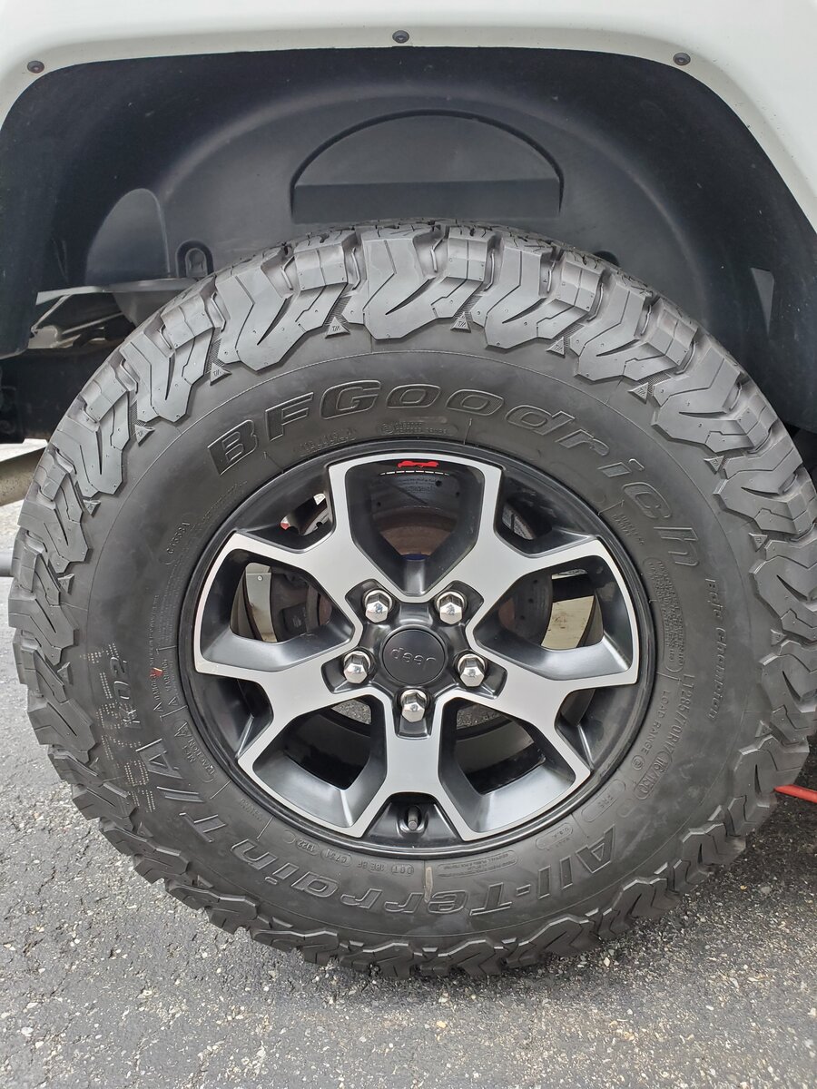

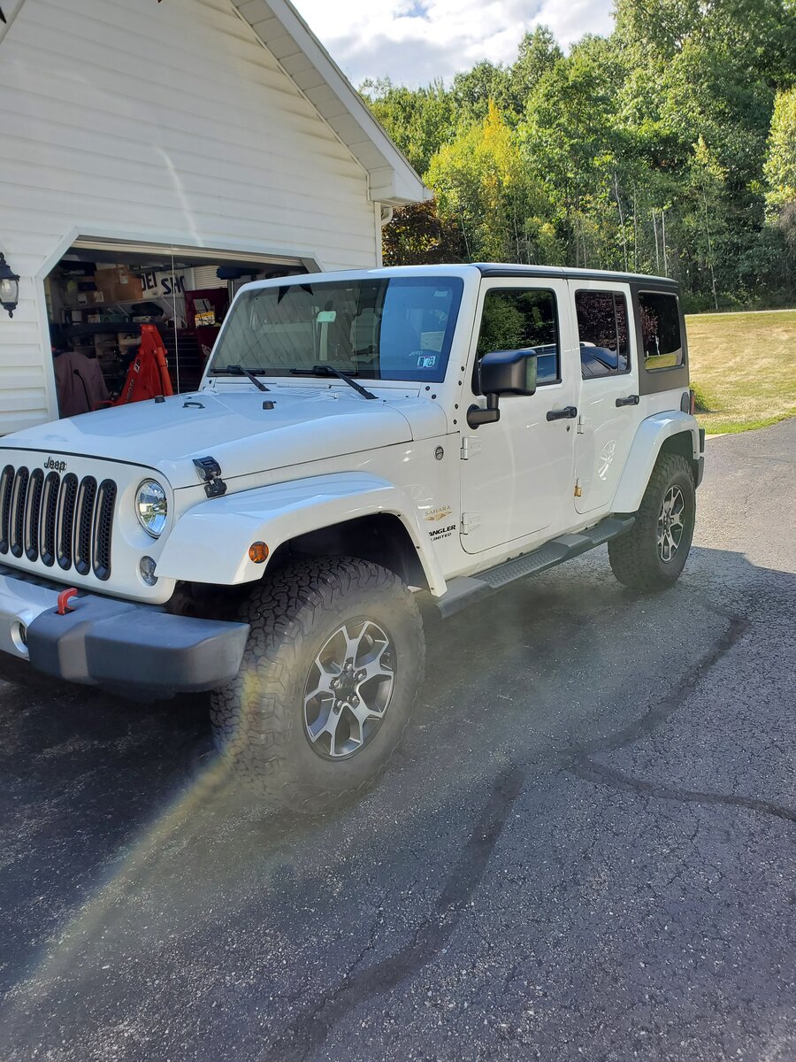

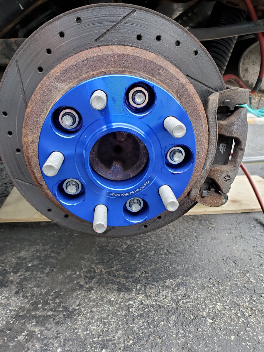

It can be done with the stock lugs, however I didn't like how it looked... I ordered 1.5" spacers to get the tires a bit out of the wheel wells, I decided to go with 14x1.5, (I also purchased 1/2-20 open lugs to mount the actual spacer to the hubs) I had positive control of mounting the spacers correctly and would not have to worry about the dealer screwing things up at inspection time...
This was a major upgrade for my Sahara...
I purchased the Superchip Flashcal to correct the speedometer, BTW, the tpms read correctly as well.
thank you all for responding.
Cheers.
Here are a few pics of it in progress and finished
