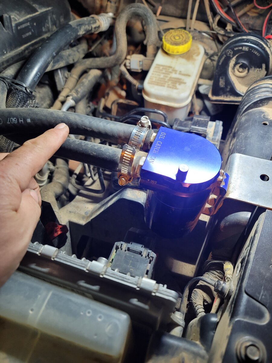

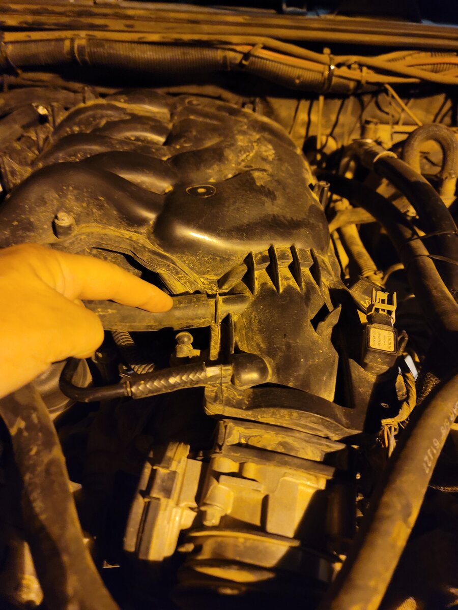

Now just have a vacuum leak somewhere. I have an oil catch can and its sucking the lines down.
Time to replace the hoses.A bad abs module was the issue. Running with no codes so far lol.
