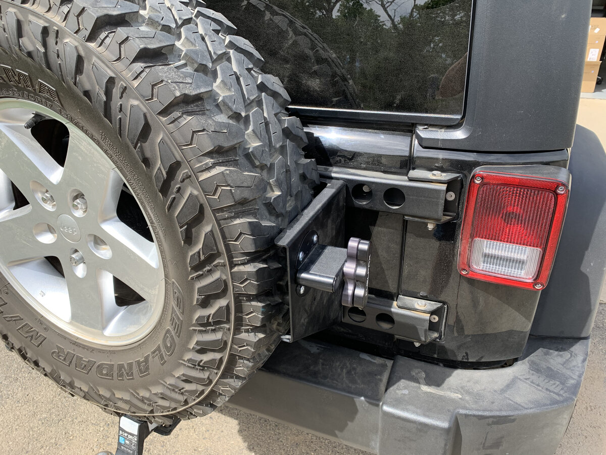

Looking to upgrade the hinges and increase the weight capacity of the tire carrier. Leaning toward the Teraflex HD hinged tire carrier. Anyone have any experience with this upgrade?
I have the morryde HD hinges and added the rotopax fuel cell mount
I have extensive experience with this tire carrier and I can explain all of the pitfalls. Here's my post from earlier this year:
https://wranglerjkforum.net/threads/tire-carrier-info.28604/#post-436181
Essentially, the problem is this- the hinge side of the Teraflex come assembled and there's no way to take it apart. The hinge pins are pressed in and cannot be removed for repair or lubrication. So, if you attempt to remove the entire carrier, after removing the tire, you must unbolt both the hinge side and the tailgate side and have someone hold the tailgate lest it just fall to the ground.

Sounding more and more like a new bumper with tire mount may be the best option.
