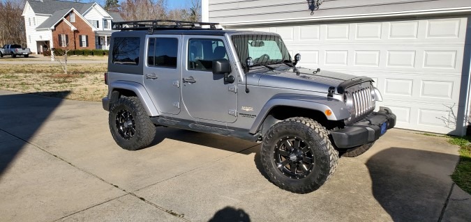

I have a 2017 JK with a 2 inch rough country lift and was looking at going to a 4inch rough country anyone have any tips for doing so or a different lift kit

Yes I off-road, but only to pull my boat/hunt/fish; nothing serious - really more for the agressive look...
