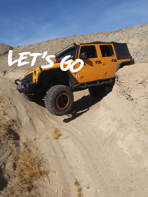

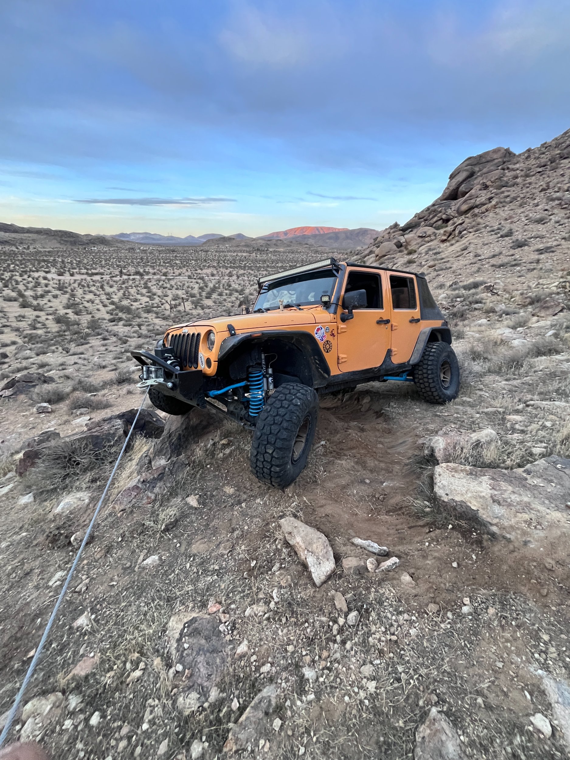

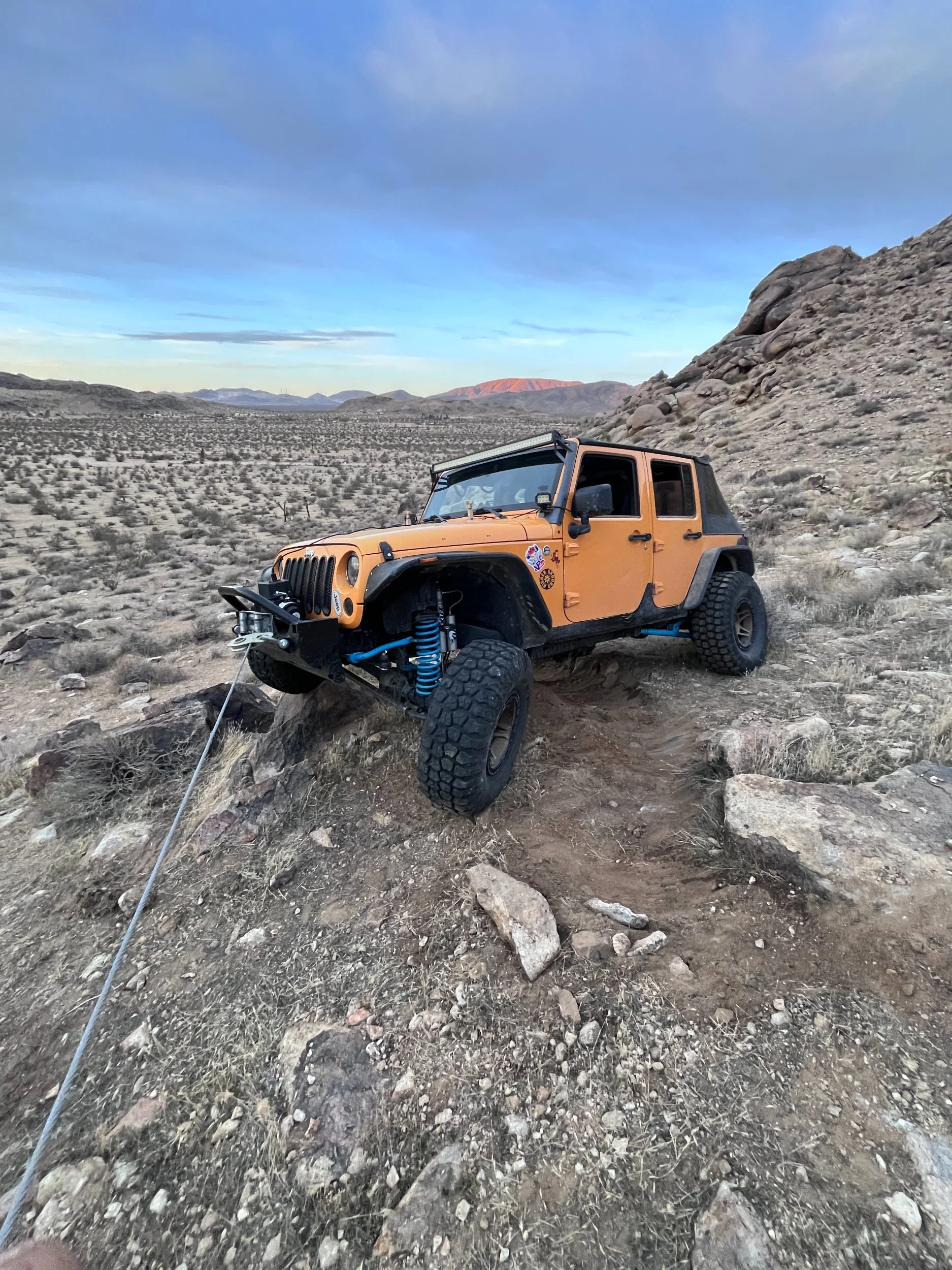

TY a couple of pics from the early 1ST build
