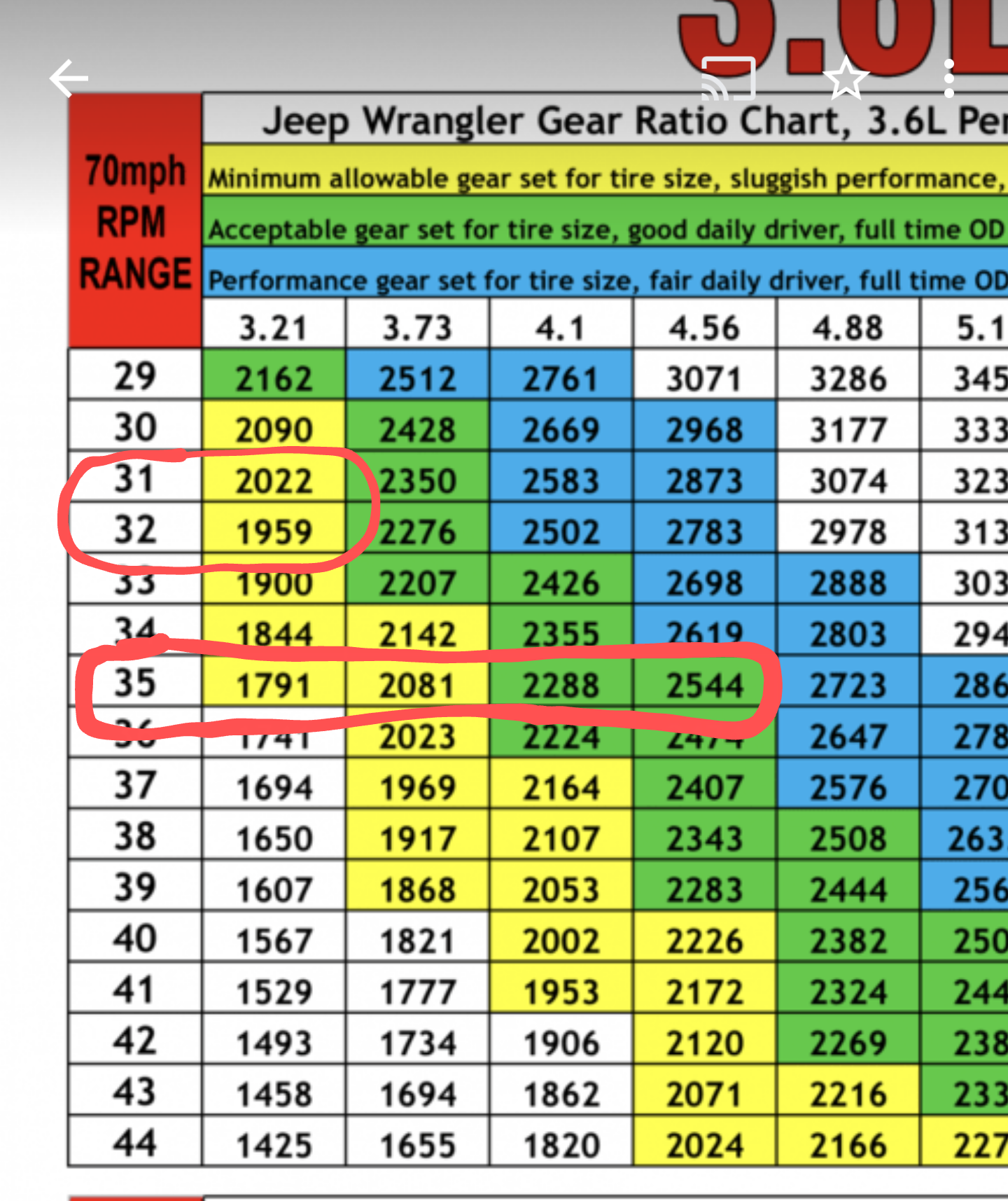

Since it's a daily it will depend on how far you commute and your tolerance for engine speed.
If you're starting with OEM 245s or 255s and 3.21 final drive you will gain 500rpm or so with 35s and a 4.56 at 70mph. Some maybe totally fine with that, some may hate it...
In my experience I would want to stay under 3000 and get as much gear as possible if I'm spending the money. I like @Snowbird Tom 's 4.88 route!
Thought I should post chart as scrolling threw thread than “bingo “.
