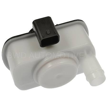

Jay D Member Joined Mar 22, 2020 Messages 50 Location Davenport, FL May 17, 2020 #1 Has anyone replaced this pump, if so did the check engine light go off or did it have to be reset?
BLACKJKU Moderator Staff Member Lifetime Supporting Member Joined Feb 22, 2020 Messages 5,335 Location Huntington In May 17, 2020 #2 I believe anytime you have a CEL the ECM needs to have the codes cleared, anyway that's the way my 08 is. Reactions: BigAL07
Chris Administrator Staff Member Joined Sep 28, 2015 Messages 32,520 Location Gillette, WY May 17, 2020 #3 The CEL will go off if you unplug the battery and leave it unplugged for 10 minutes or so. The PCM will reset itself. Of course clearing the codes with a scanner is much easier

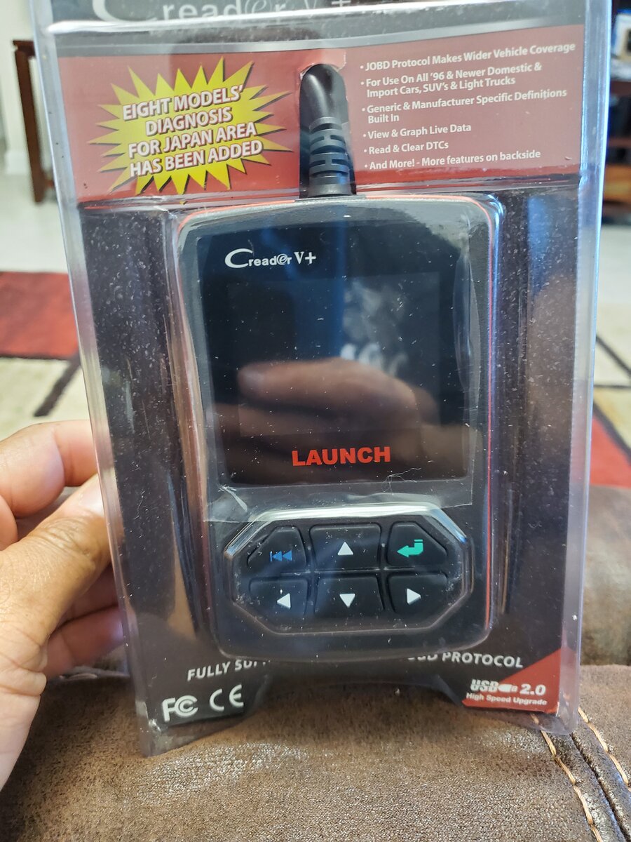

Jay D Member Joined Mar 22, 2020 Messages 50 Location Davenport, FL May 17, 2020 #5 Chris said: The CEL will go off if you unplug the battery and leave it unplugged for 10 minutes or so. The PCM will reset itself. Of course clearing the codes with a scanner is much easier Click to expand... A scanner like from AutoZone?
Chris Administrator Staff Member Joined Sep 28, 2015 Messages 32,520 Location Gillette, WY May 17, 2020 #6 Jay D said: A scanner like from AutoZone? Click to expand... Yes, but Autozone can't legally reset codes, even though their tool will do it. It's against their policies. Buy a cheap OBDII scanner like this: https://www.amazon.com/dp/B06ZYTDKP3/?tag=jkforum-20 Or download the J-Scan app and buy this: https://www.amazon.com/gp/product/B06XGB4873/?tag=jkforum-20 If you plan on owning your Jeep a long time, you need an OBDII scanner to read and reset codes. Either of those methods are cheap and easy to use
Jay D Member Joined Mar 22, 2020 Messages 50 Location Davenport, FL May 17, 2020 #7 Best $45.99 ever spend.....thanks for the heads up on that.
